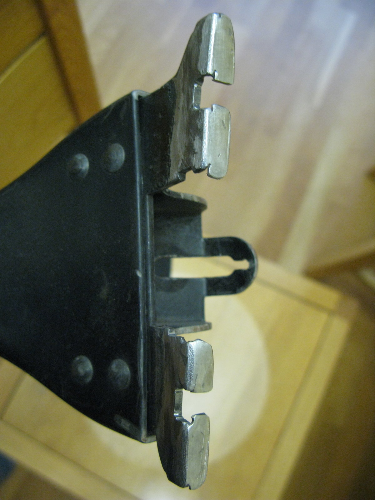

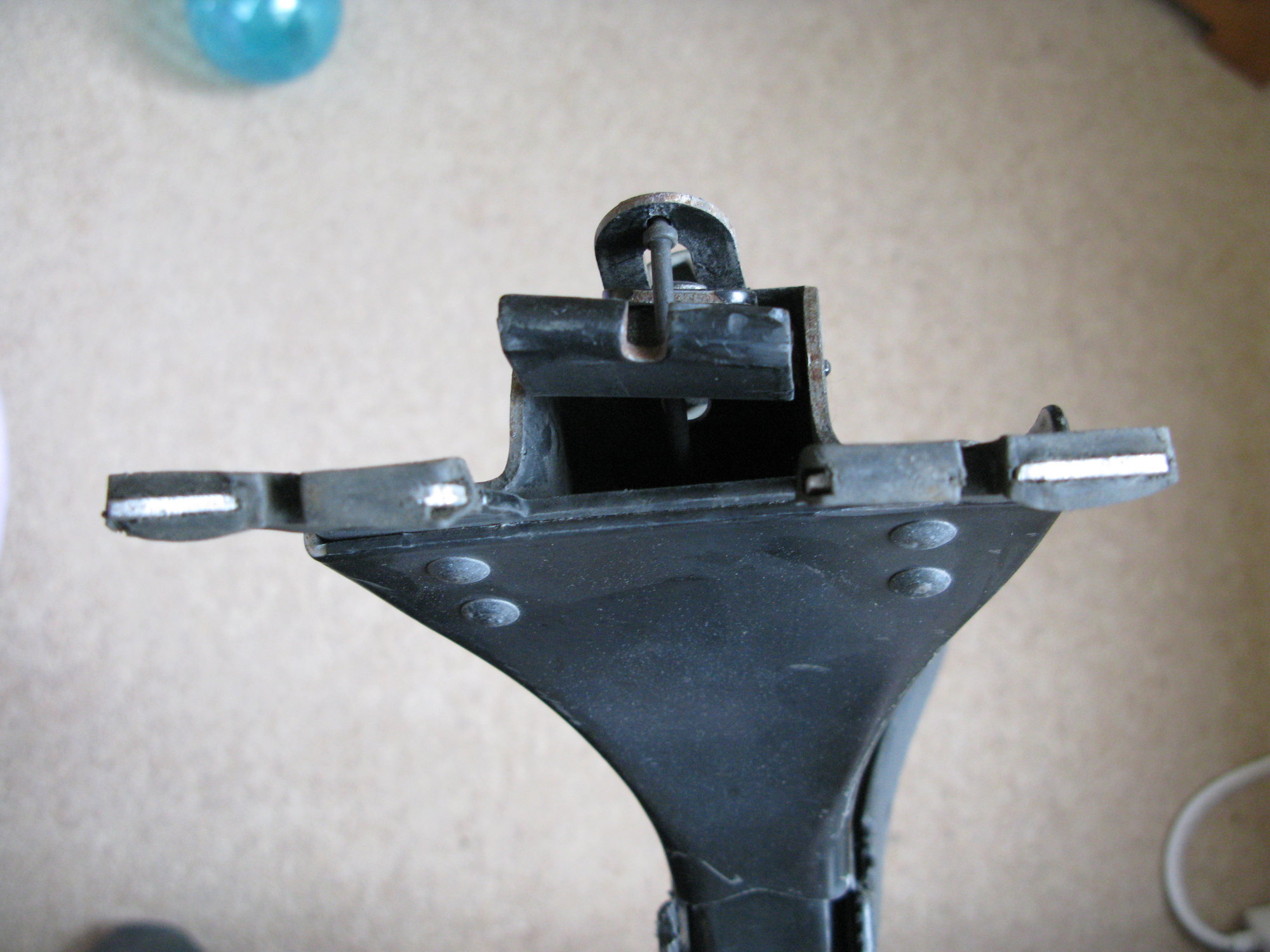

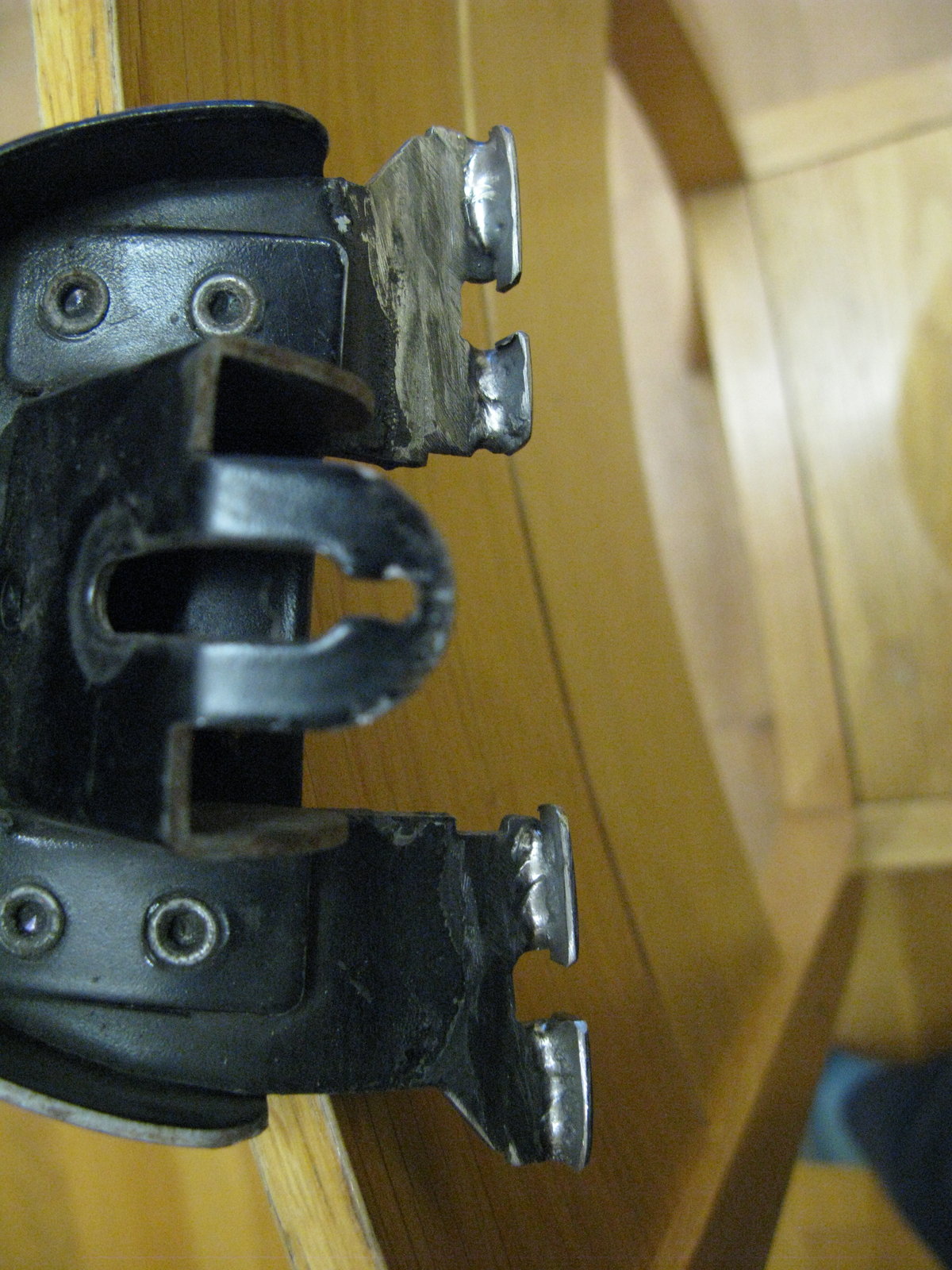

The problem - the rubber feet had failed and I could not source more it was about to cut the paint in the roof gutter.
Put feet on in stainless, bonding the steel legs to the stainless feet using 309 filler
