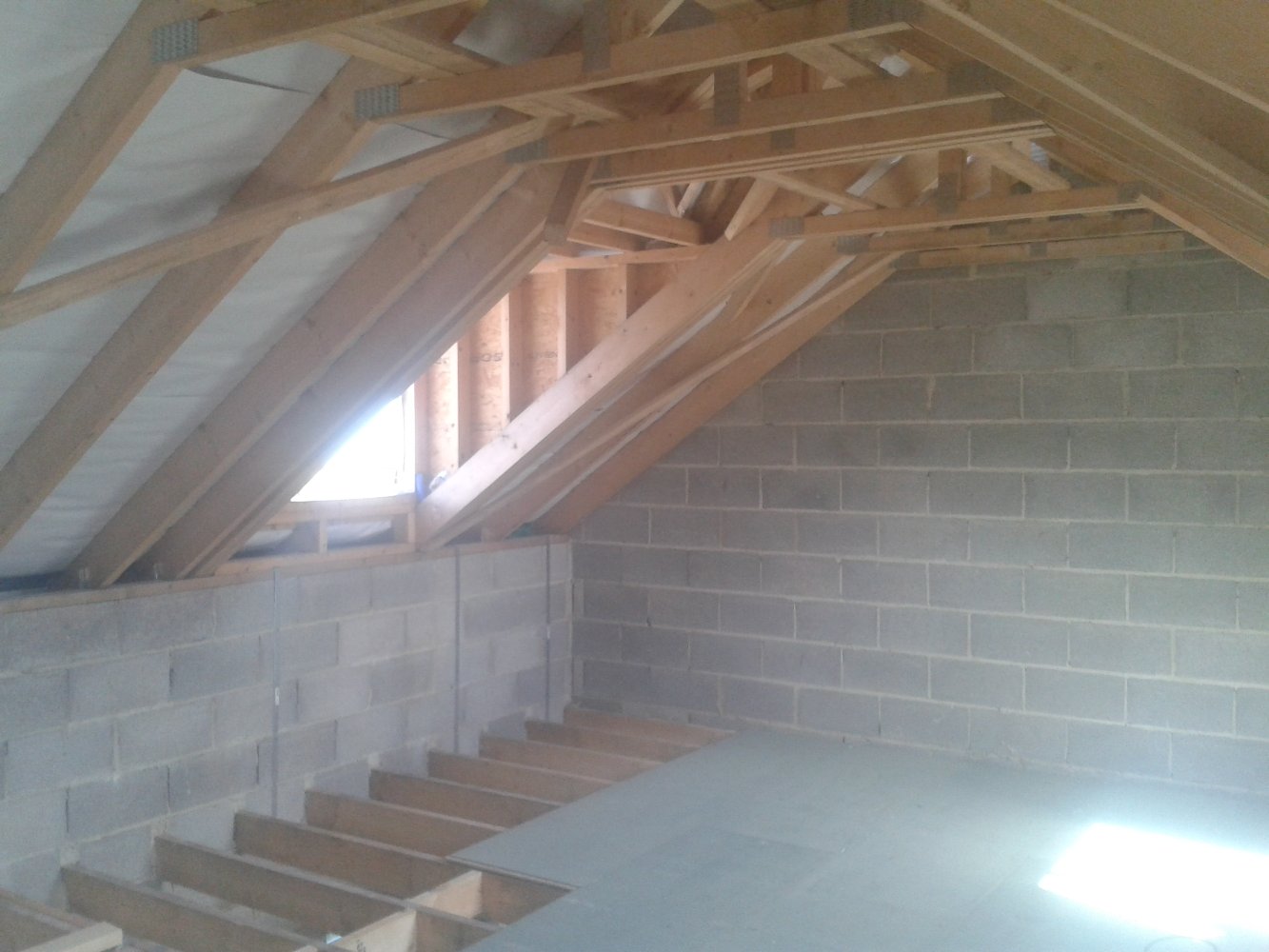

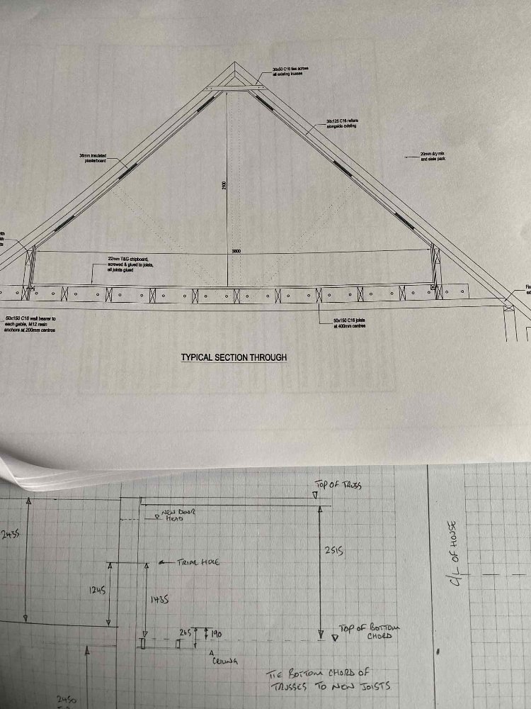

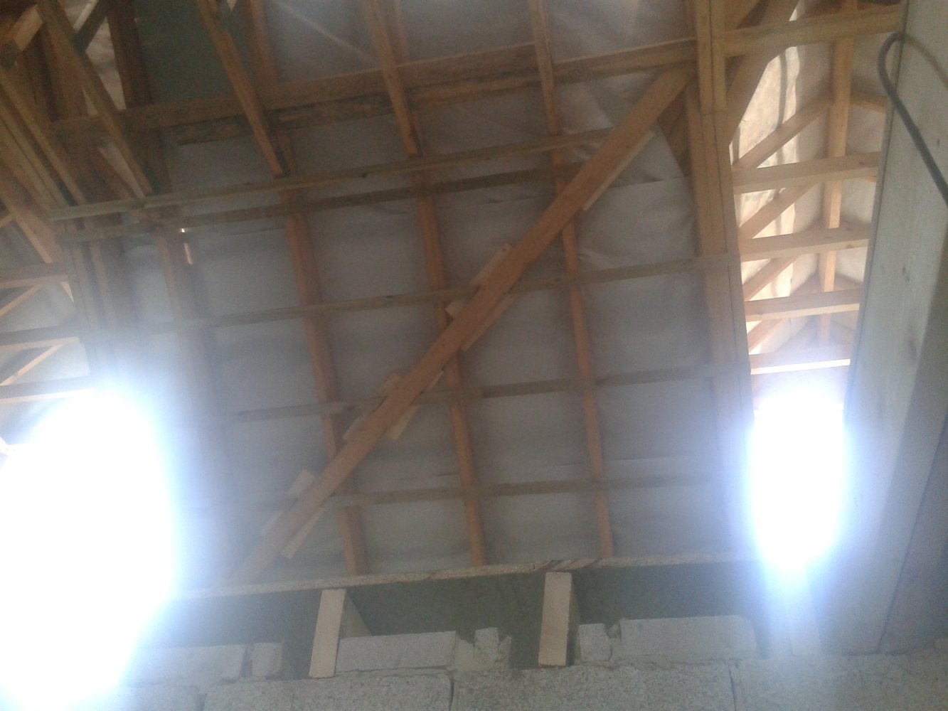

I'm doing a shopping list for materials.. As per Engineer's details, the existing rafters are sistered with 38x125 C16s with 38mm insulated platerboard across the face. This is giving me a 125mm or so gap behind (Sarking felt and pantile roof covering)
An air gap to the underside of the felt will be a good idea, so any issue with just sticking 100mm rigid Knauf/Celotex/Kingspan board in there?
