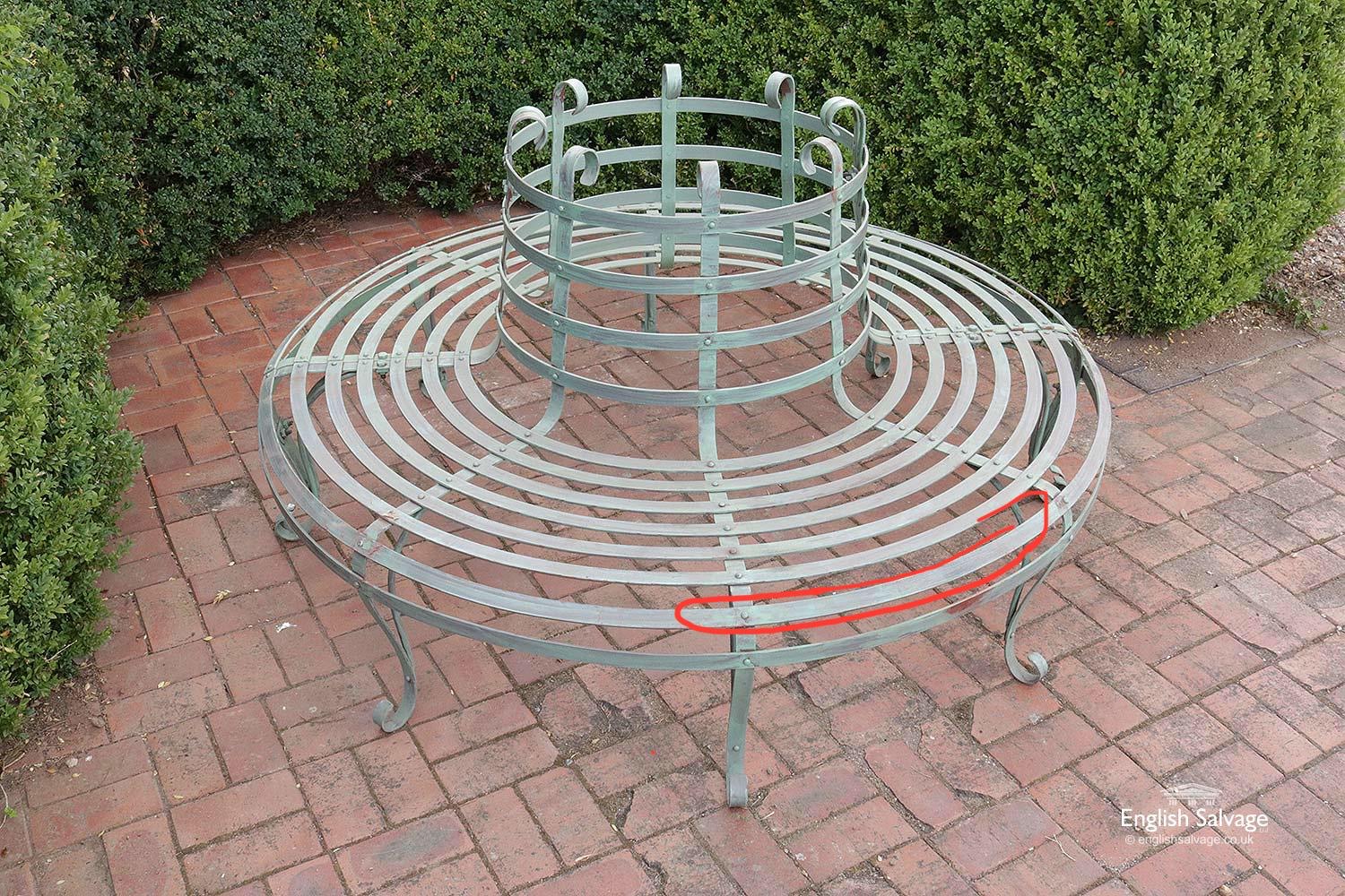

Need some advice from someone more experienced than I.

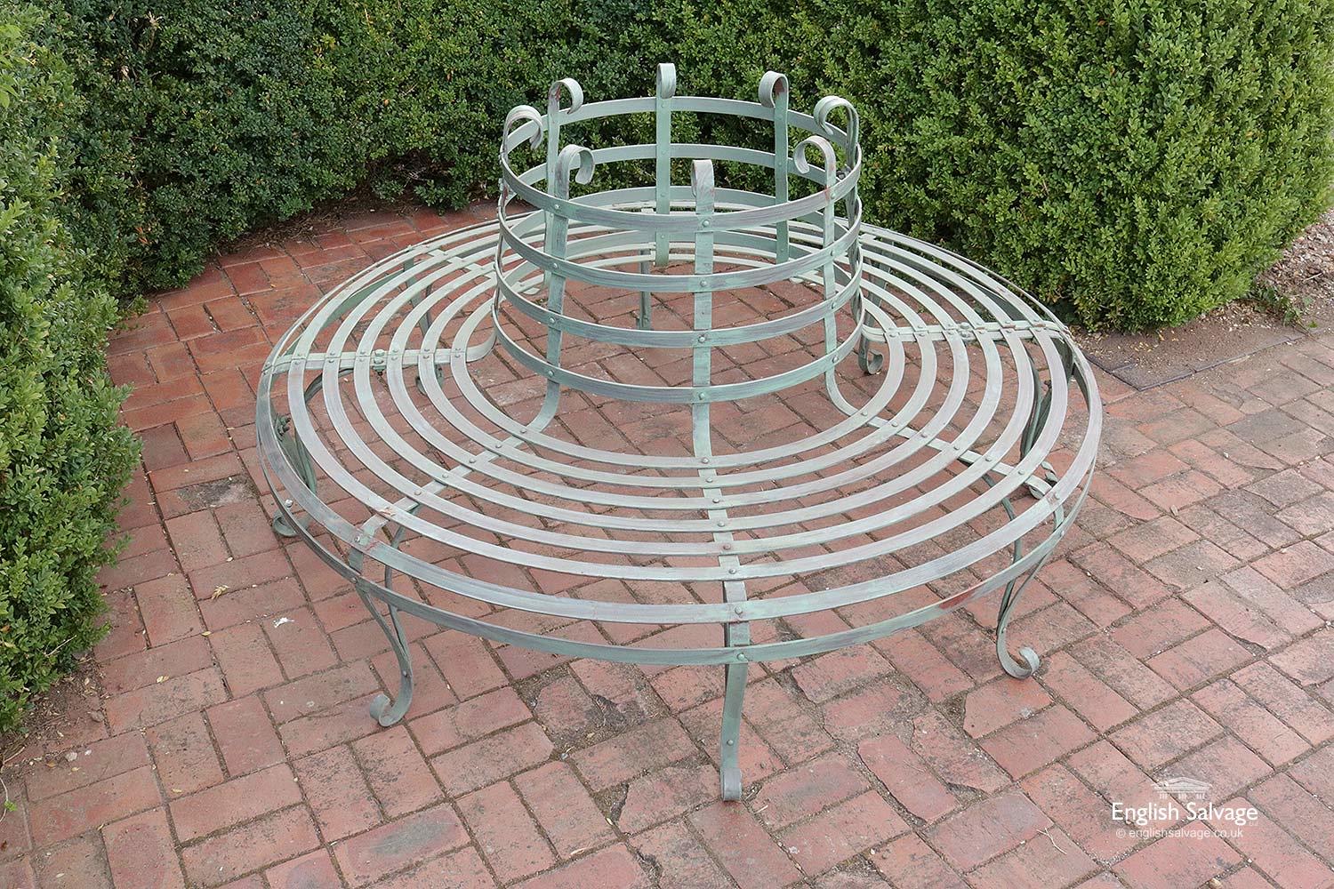

I am in the process of making a bench to fit around a cherry tree. I have made the "ends" although there are no ends as it will be two semi circles bolted together. It will ultimately look similar to this one.
What I need to know is how can I roll this bar, the one that sits on the corner under your knees.
I have built a powered ring roller so can roll the easy and hard way but this one is in between.
On all three of my rolls I have split shaft collars so I can adjust depending on what section I am rolling, would it be a case of literally placing the collars so the flat bar sits at ~45 degrees and then rolling? It will be pretty much 6ft diameter so I will be using almost a full length to roll that ring.
