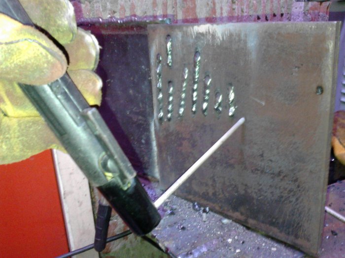

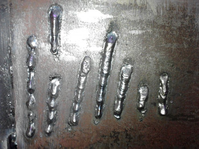

Hello again, I'm having a dabble at vertical runs now i've got horizontal strings consistent, At first as you can see in the pictures, i had a problem of the pool running downwards (Even when 3.2mm were used at lower amps).
My rod position was roughly 45 degrees BUT i was holding the rod holder higher than the rod tip, if you know what i mean, so i was pulling the rod up rather than pushing. I think that was why i was having problems, I think i have got the position right now, which is elped more by keeping a very tight arc, but for reassurance, i've added a picture of how i'm positioning the rod where i seem to get the best results...
