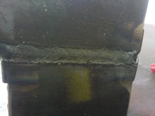

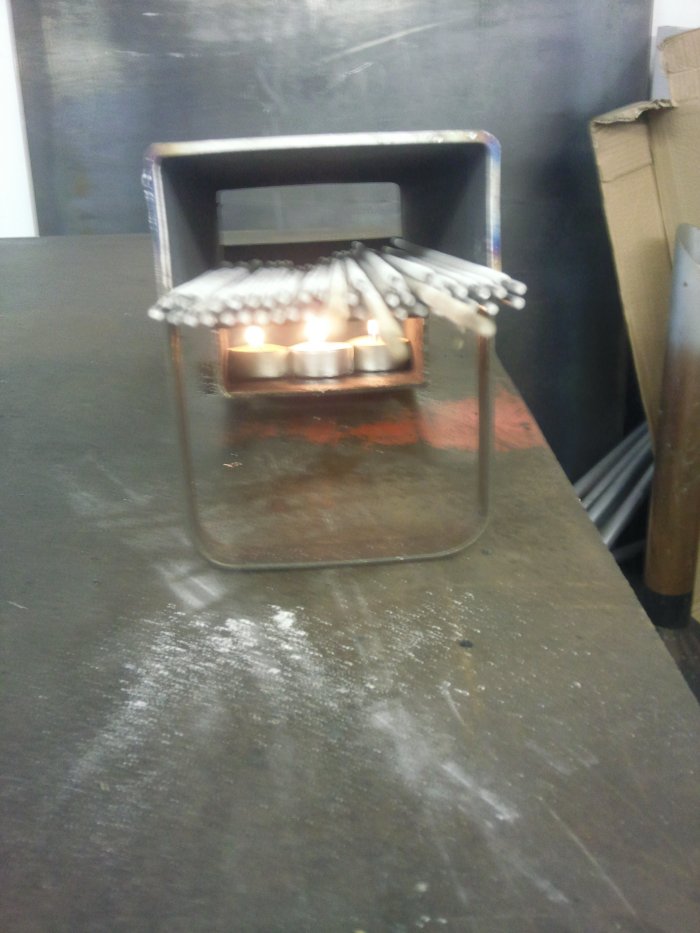

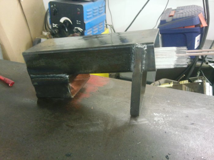

Just one of those silly little things I felt like playing with. Nothing special, just a bit of 60x126 box I had laying around and some 20x2 strip. We all know rods strike easier when warm and dry, so why not really. Sure someone could refine the idea a bit better, although it`s already temperature ajdustable by adding/removing candles (plus the vanilla makes the workshop smell nice lol)

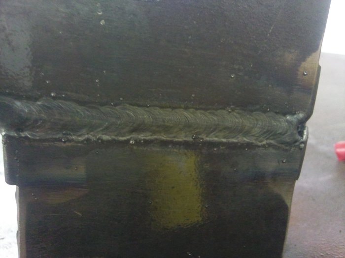

Last pic is just one of the welds on it, added because i`m quite enjoying this arc lark. 2mm gap (roughly) first pass at 90 amps, then fill at 120amps, both with 3.25mm Fincord M`s (i`ve enough of them to rebuild the Titanic) on an old AC buzzbox (in back of one of the pics) Opinions welcome/wanted
