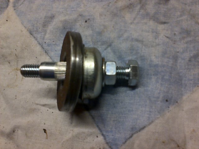

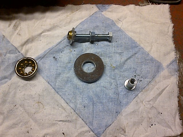

after tool i bought to fit some m8 rivnuts for sidesteps packed up after fitting second one came up tool below.
made from bearing cup and cone nut of old bike hub and large washer.
filed cone nut to fit 4mm thick washer and come through.
pic 1 is bits used
pic 2 is it assembled.
works a treat.
