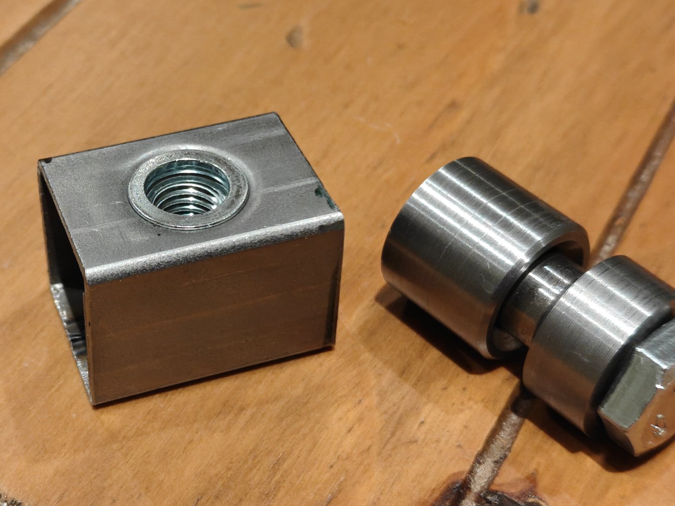

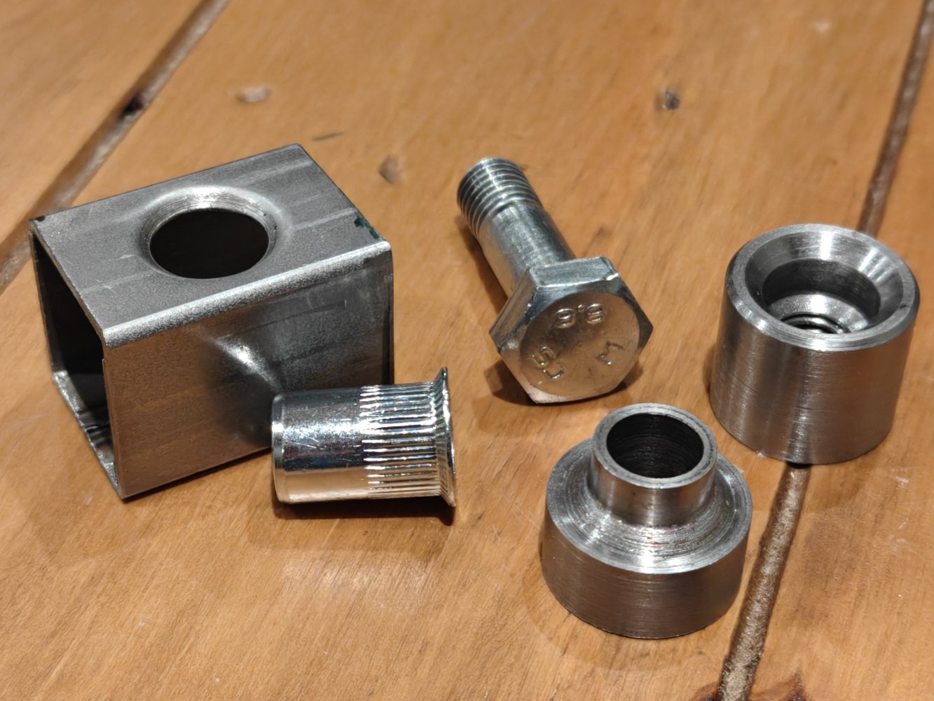

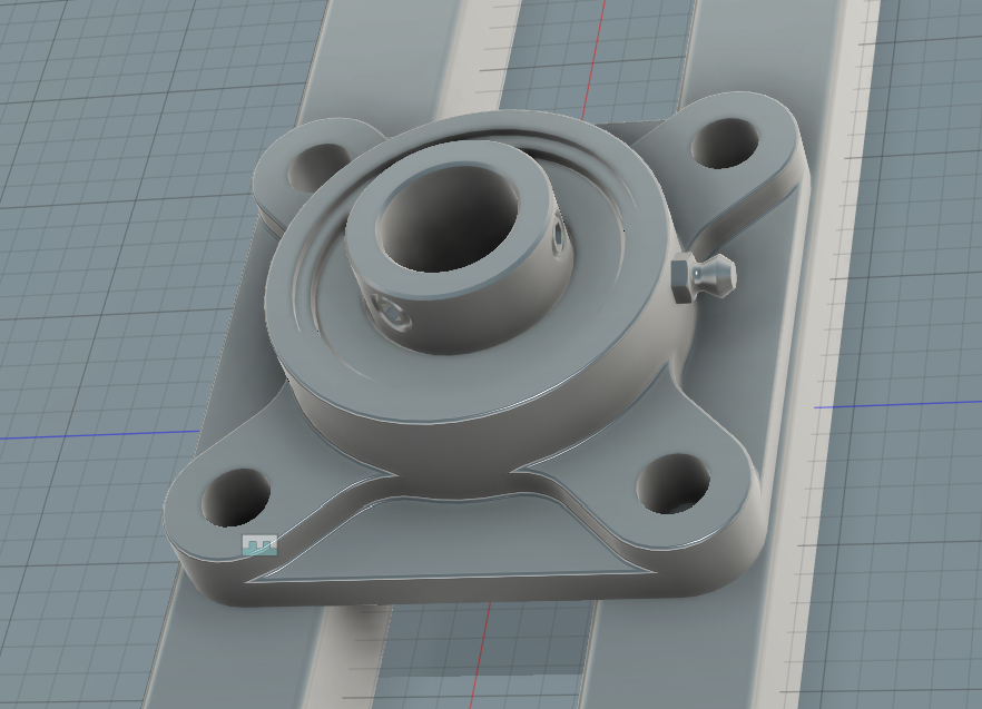

I have a need to bolt a 4-hole flange bearing to a couple of pieces 25mmx25mmx1.5mm ERW square tube...
The bolt holes are sized for 10mm and my first thought was countersunk rivet nuts but the countersink is as thick as the 1.5mm wall thickness and standard rivet nuts have a standoff. I could put a thickening plate between bearing and ERW to countersink into or scrap the rivet nuts and go for anti-collapse tubing and nut/bolt or weld in a threaded tube.
Any other ideas?
