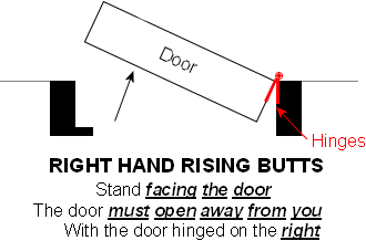

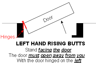

Screfix are selling two opposing hinges ie a left & right hinge types....how the ruddy hell am I supposed to know which ones to pick for a particular door ie is the right hinged door from the inside of the room or the outside?
Ta
