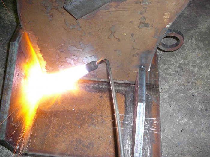

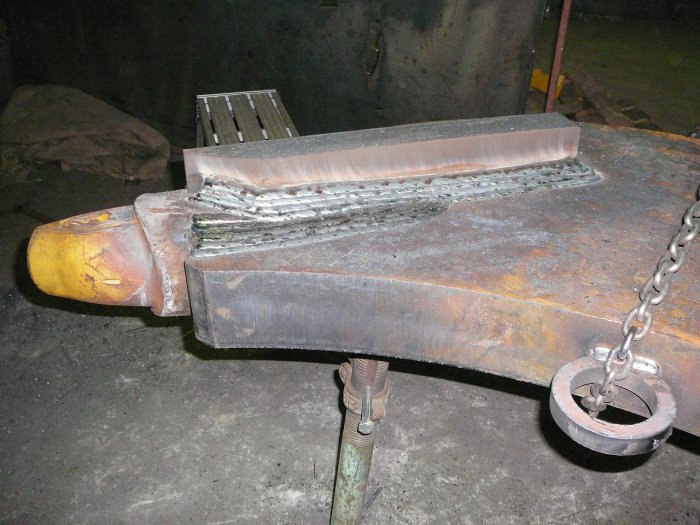

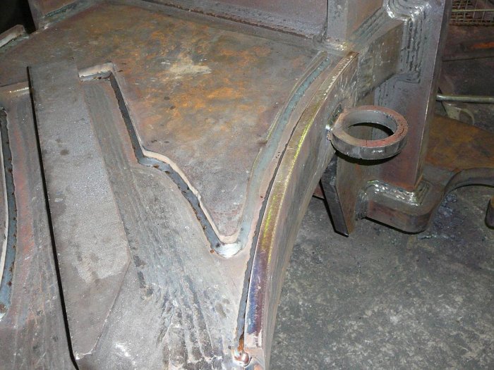

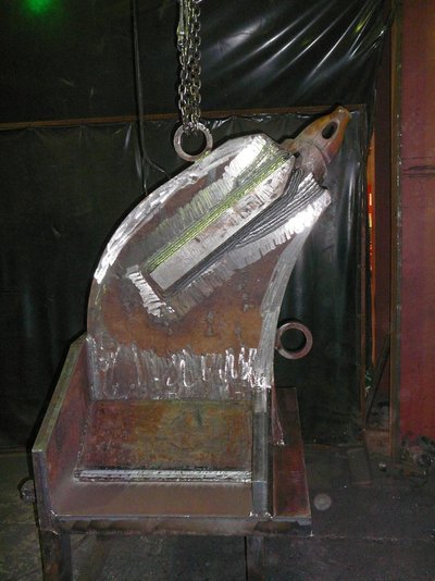

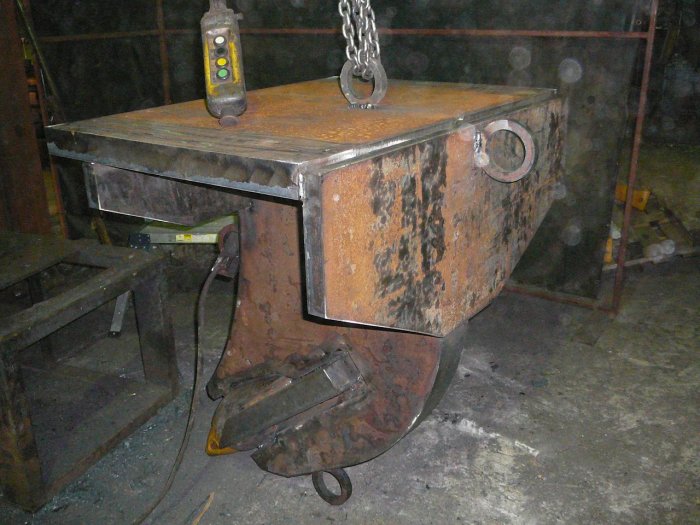

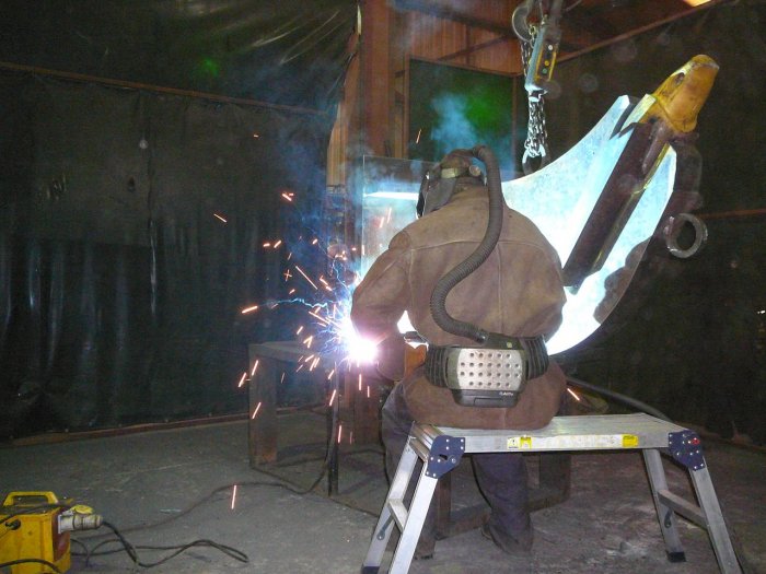

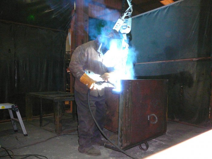

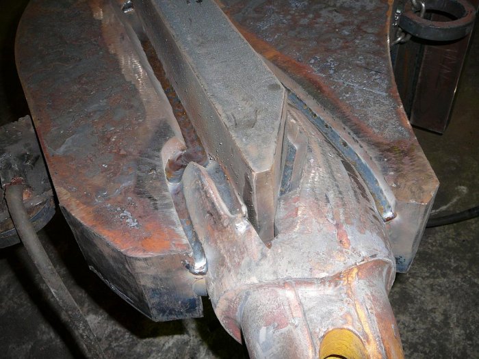

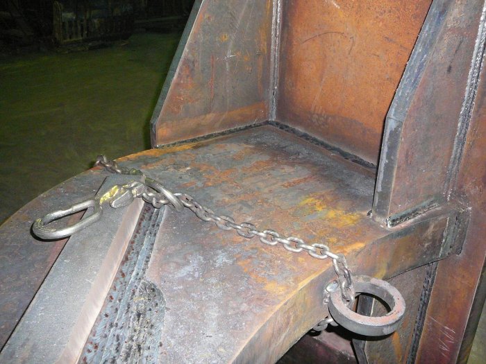

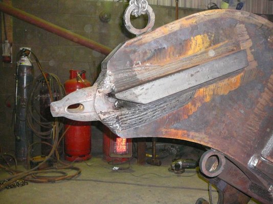

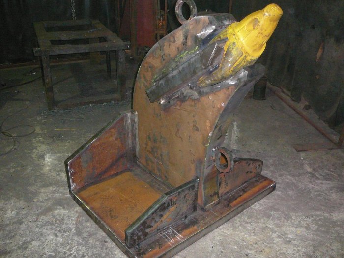

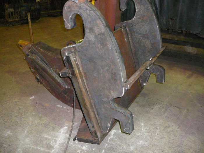

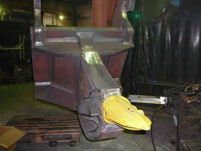

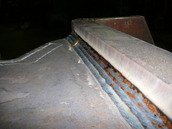

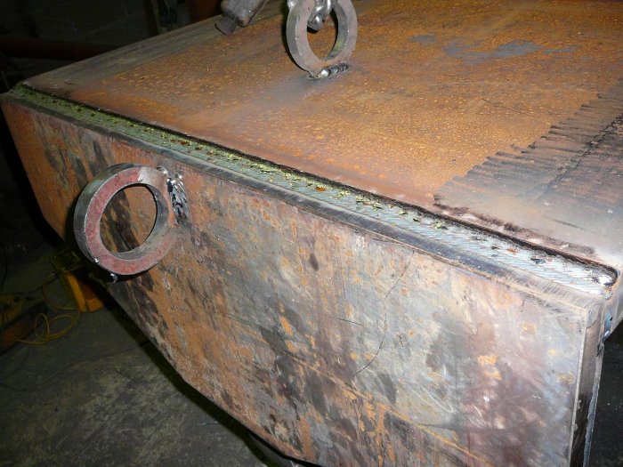

Here is a quick (ish) run through of the construction of a ripper tooth we made hope some of you find it of interest.
First a little heat, most of this is mild steel so it only needs the chill taking out of it, the blade and tooth will need more heat later as they are harder.

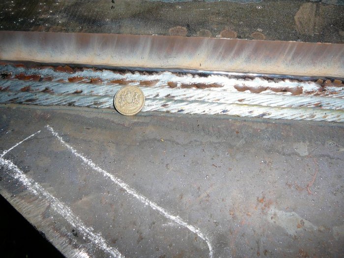

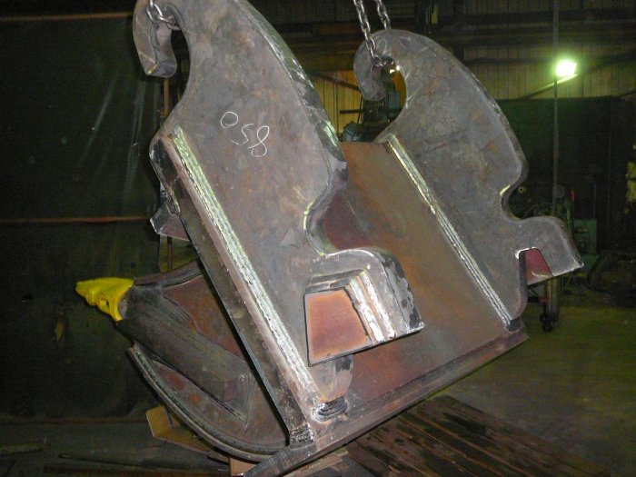

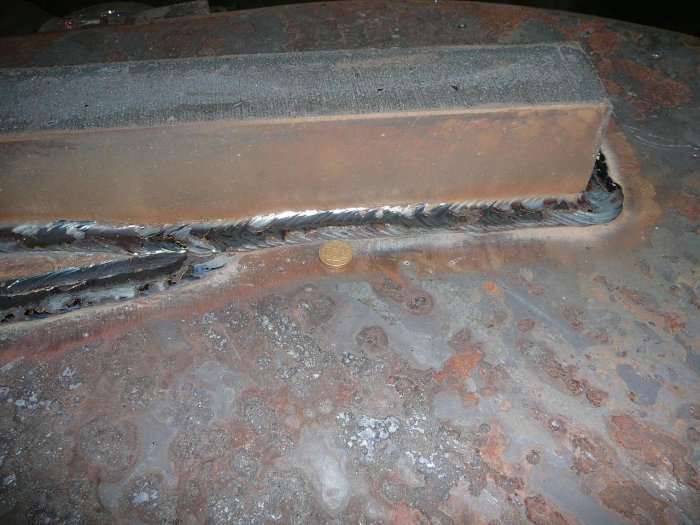

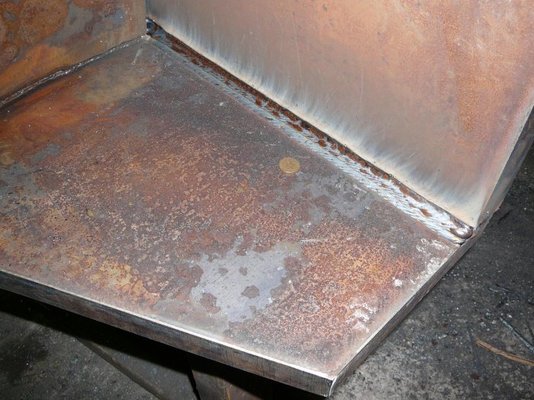

OK time to put some weld on it.

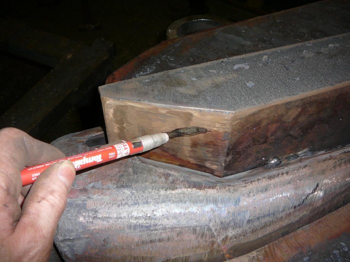

Heat the tooth and blade check its up to temp with a temp stick,and more weld
