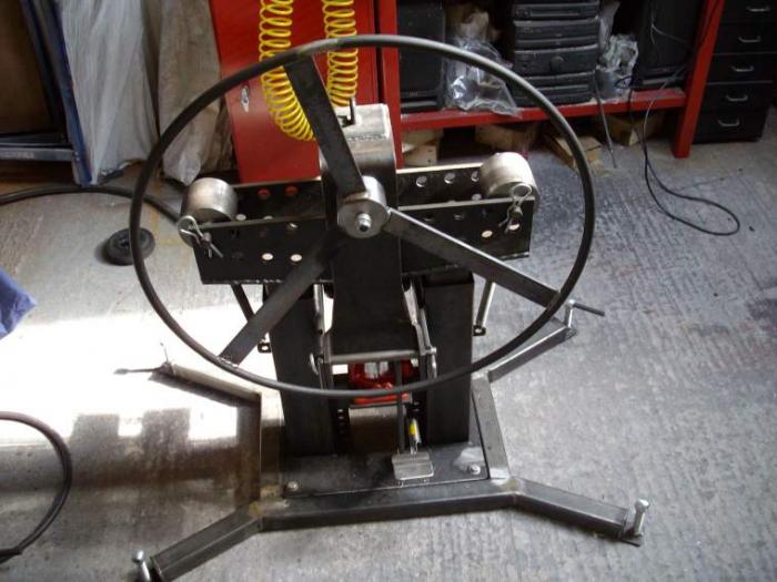

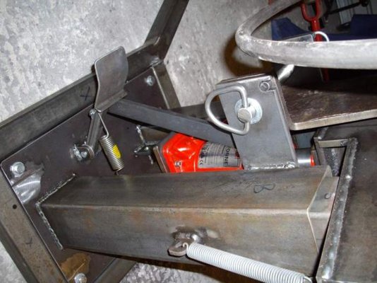

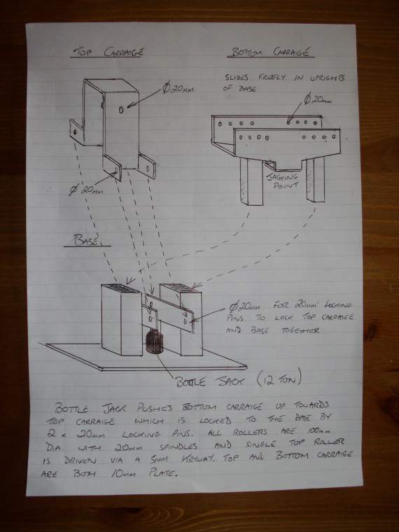

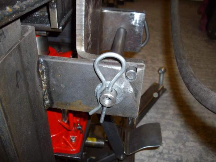

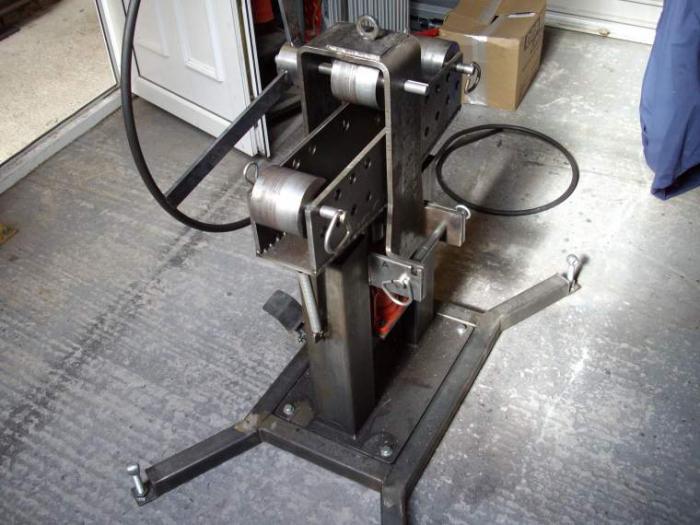

Hi all a couple of people where asking about the ring roller I made so here are the pics and a rough set of plans, feel free to copy no probs at all any questions just ask no probs, No dimensions I'm afraid as I didn't really work to any set dimensions I just new what I wanted it to do and well.... made it!
