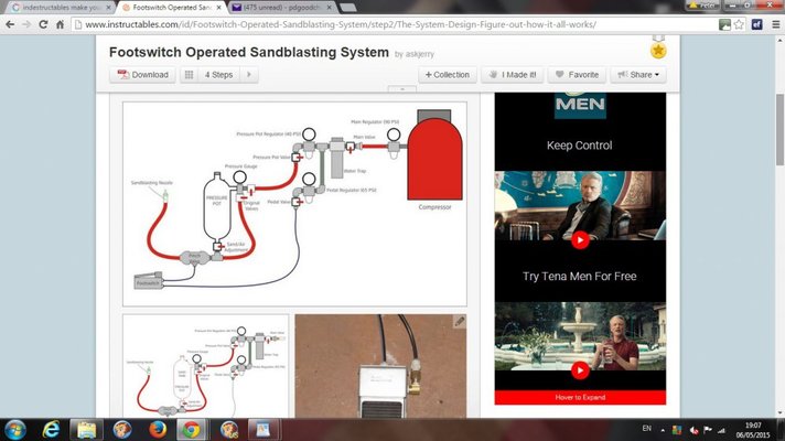

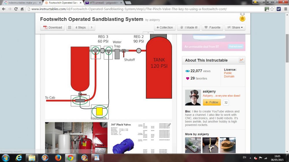

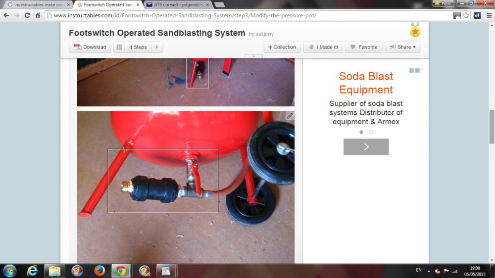

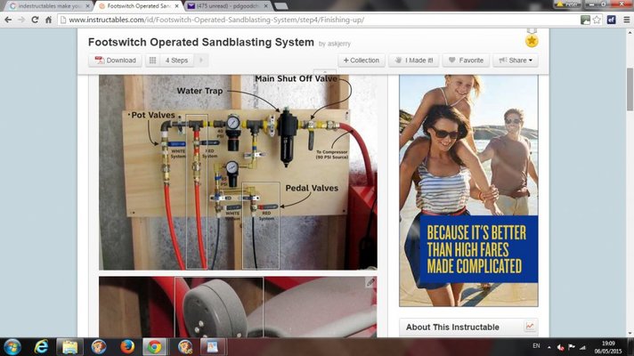

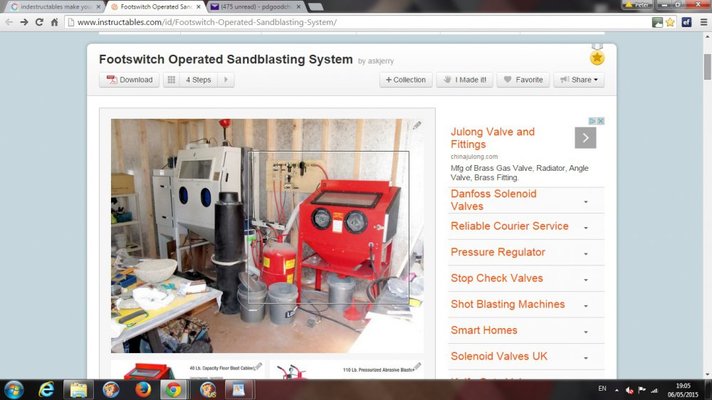

I've got the various parts to make my own foot switch operated sandblasting system. Pinch valve from Air Pinch USA, two pressure regulators from China, water trap, foot pedal, shut off valves
See screenshot 9, I've bolted a plywood sheet to the wall. I'm finding it very confusing, npt etc, and what fittings I use to connect the various component parts to each other.
I've contacted the guy in the States he got the various connectors from his local Home Depot. Said the pressure regulators and water trap I was buying would work fine.
In screenshot 9 I recognize a galvanized T connector, the brass looking pipe work, I couldn't find anything like that on Wickes site. In screenshot 9 he has two systems set up,
the red and the white one labeled with tape. as he is using two cabinets as in screenshot 6.

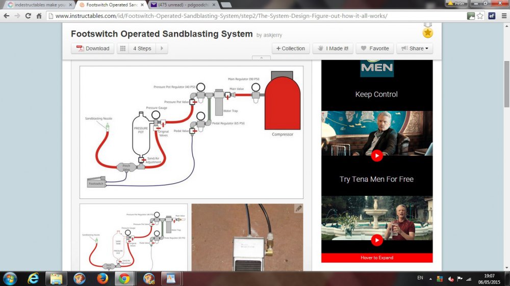

I attach a couple of schematics showing the set up for a single sandblaster, I also enclose another schematic from another site.

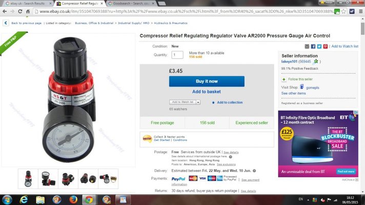

Some details of parts on parts :
1 = Compressor Relief Regulating Regulator Valve AR2000 Pressure Gauge Air
Control Adapter Diameter: PT 1/4 Ebay item number = 351047069388

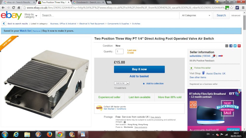

2 = Two Position Three Way PT 1/4" Direct Acting Foot Operated Valve
Air Switch ebay item number = 290913204464

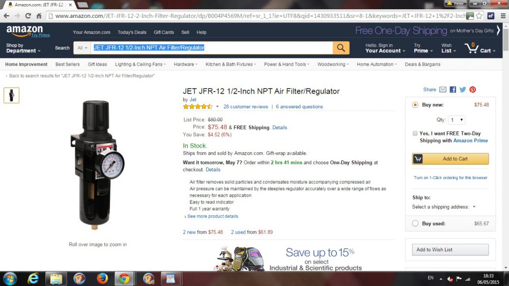

3 = JET JFR-12 1/2-Inch NPT Air Filter/Regulator Size 1/2-Inch search Amazon USA and item will appear.

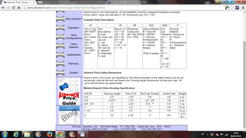

4 = Pinch valve from Air Pinch USA invoice says has 3/4 inch ports description AT-06-NF-B60-0606-N
part number AP-6798
Any help on this would be very much appreciated,
Cheers.
