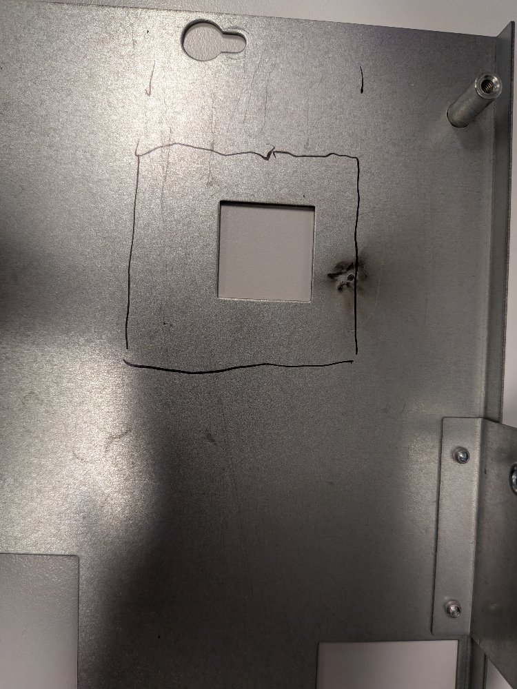

Plasmacutting them by hand with a jig will give you lots of cleanup work on all the parts.
Even a small plasma will zip through 1.5mm, but at 4000 pieces your travelspeed is going to be all over the place resulting in dross or uncomplete cuts.
And you'll need good fume extraction and ppe. Especially if they're galvanised.
