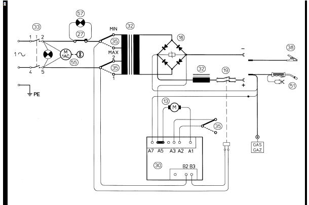

Picked up a Combi 130 Art 888 to replace a Snap-Mig Turbo (Art 886) that got stolen.
I was going to convert the Snap on to dual polarity for gas/ gasless.

The Combi has a two wire trigger and the contactor switches the + torch feed where as the Snap Mig has a single wire trigger switch and the contactor switches the - earth clamp.
Combi 888 Schematic
Will I still need to fit a second bridge rectifier?

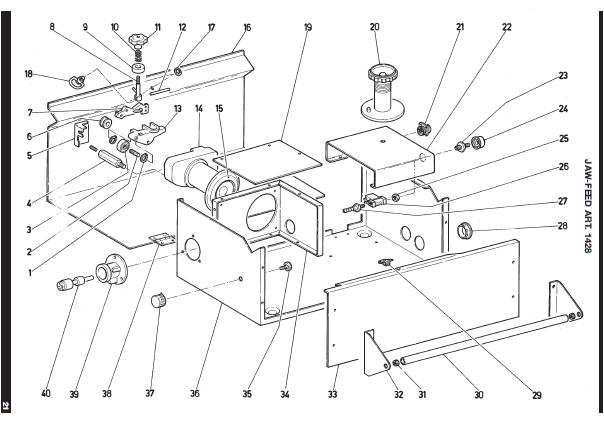

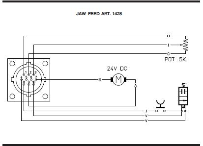

I'm in two minds what to do about the spool holder and euro torch as I'm getting a Cebora JawFeed (Art 1428) for a Jaguar 203 (Art 584) as it was cheaper than a spool holder and euro socket.
I could fit a 10 pin socket and a switch to change from internal to external wire feeder to the welder make up a cable and sit the wire feeder on top of my Combi and fit a Dinse socket input to the JawFeed.
Or I could fit the spool holder, gas solenoid, wire feeder and euro socket from the JawFeed to my welder. Presuming that the JawFeed motor and rollers are better than the Combi one.
