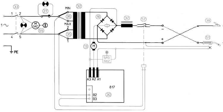

Was thinking of fitting a couple of small "Dinze" sockets to the front of my SnapMig 130 Turbo, Which is a rebadged version of the Cebora Pocket Turbo 130.
Taking the torch wire out through the front of the welder through the strain relief thats used for the earth cable and fitting a dinze plug to it and another plug to the earth cable.
So I'd have a pair of sockets, + and -, a removeable earth cable and I could change the polarity of the unit so I can change from MIG/MAG to MOG (gas to gasless)

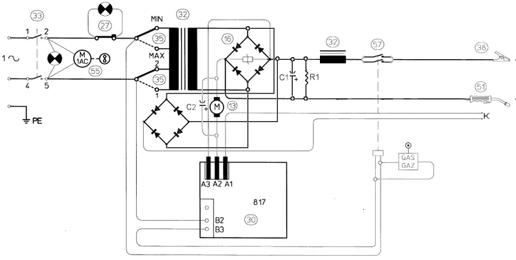

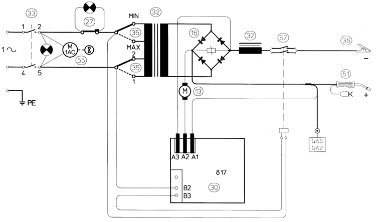

I've attached a copy of the wiring diagram
Was confident until I realised it was a 1 wire torch, would this blow the welder or make the wire feed run backwards?
Is the feasable or not?
