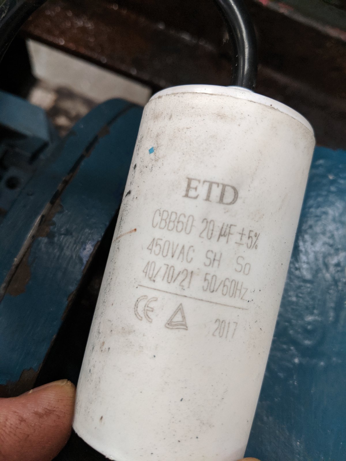

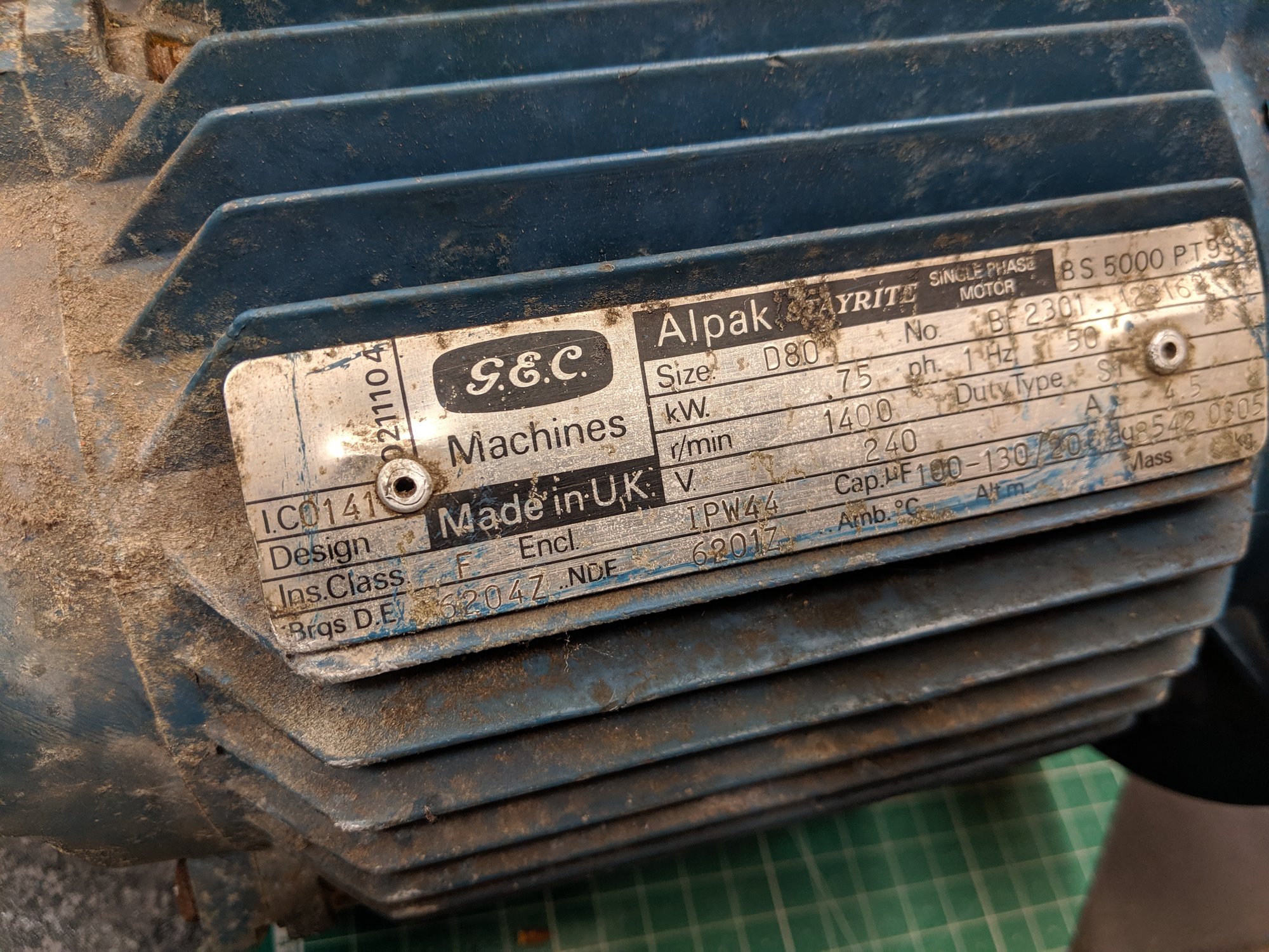

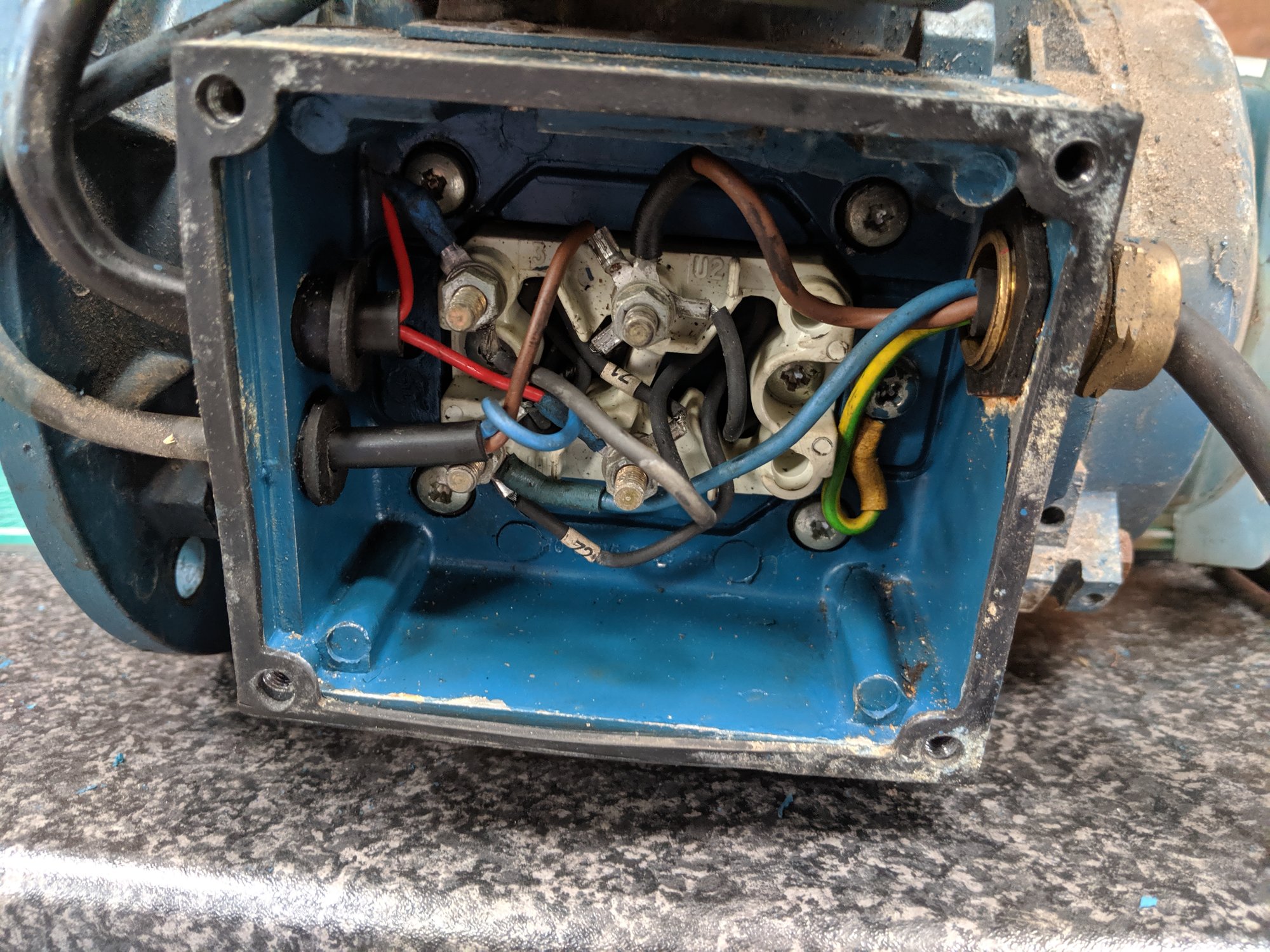

With some trial and error the motor is spinning the other way now. I did have to change the cap around as without doing so it got all hot and some magic smoke started coming out.
That's weird my caps have 2 black wires no way of knowing what the difference is unless you mark them youself
Anyway, @Tangledfeet the rapidor now lives again!
