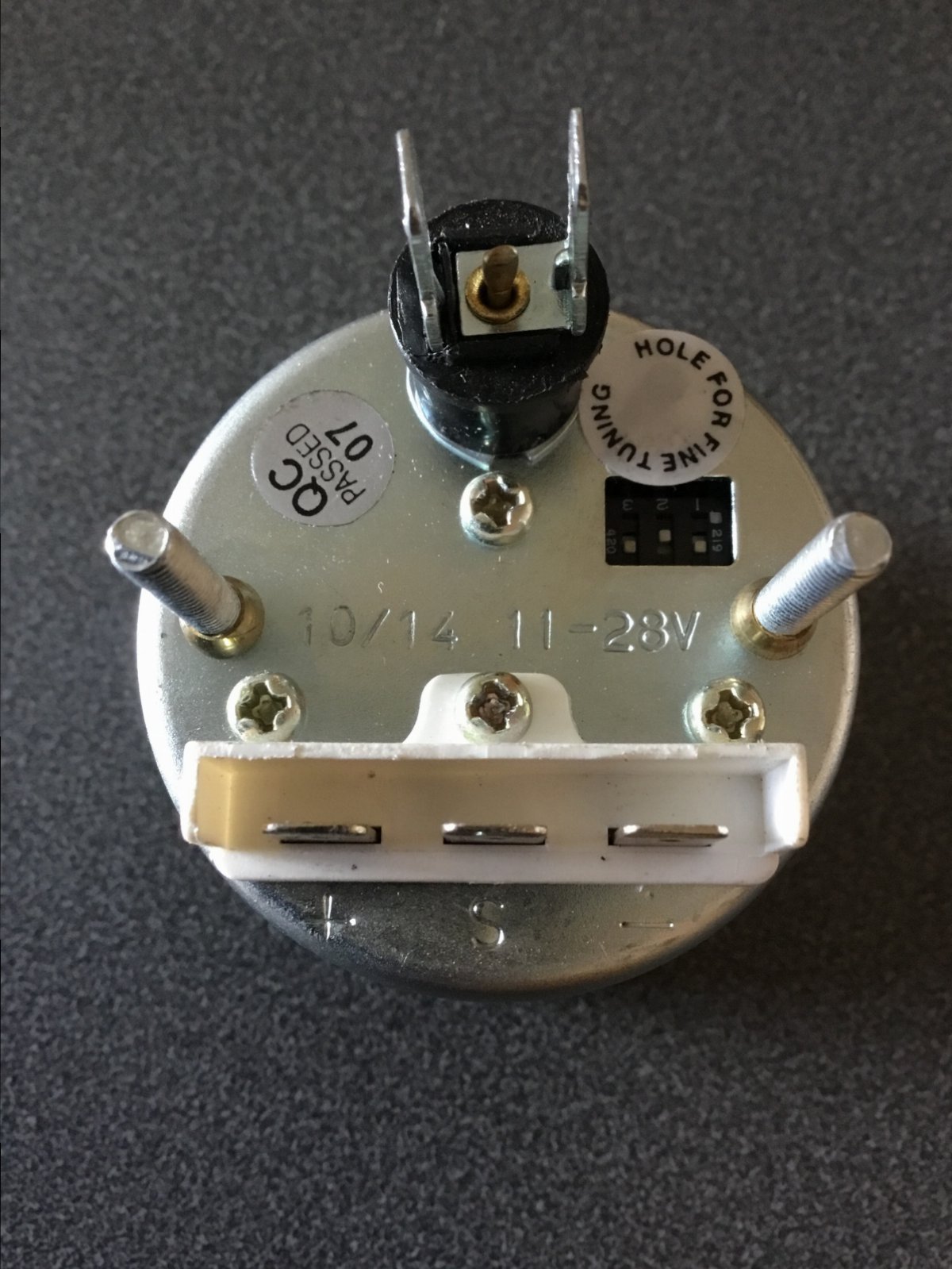

I've a Veethree rev counter fitted to a straight 6 petrol engine running from the coil. At tick over it reads correctly(380rpm), however on increase of rpm, it only raises to >1k. Fitted with a Pertronix solid state ignition. I've wired it directly to the coil and battery to eliminate any wiring faults and its just the same.
This is a replacement unit as the last became erratic.
Wiring as instructed +ign. -neg bat. S to -coil
Dips set to 1on, 2off, 3on
Any suggestions
