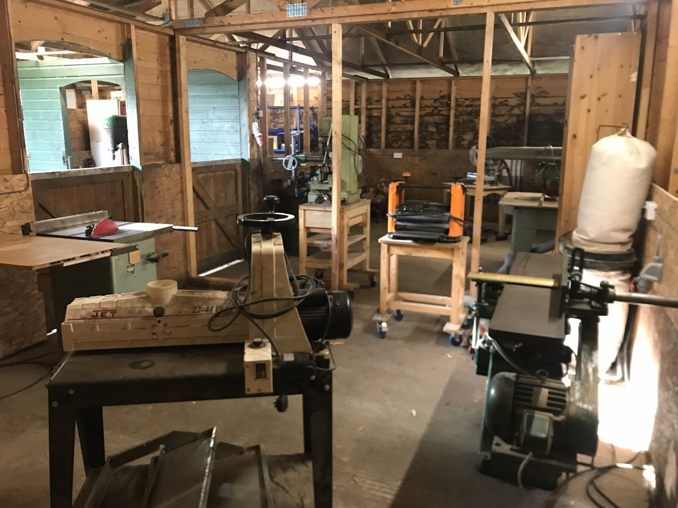

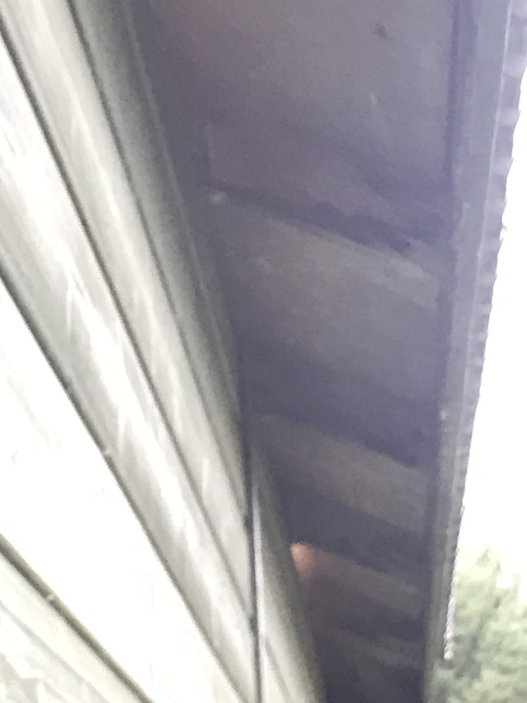

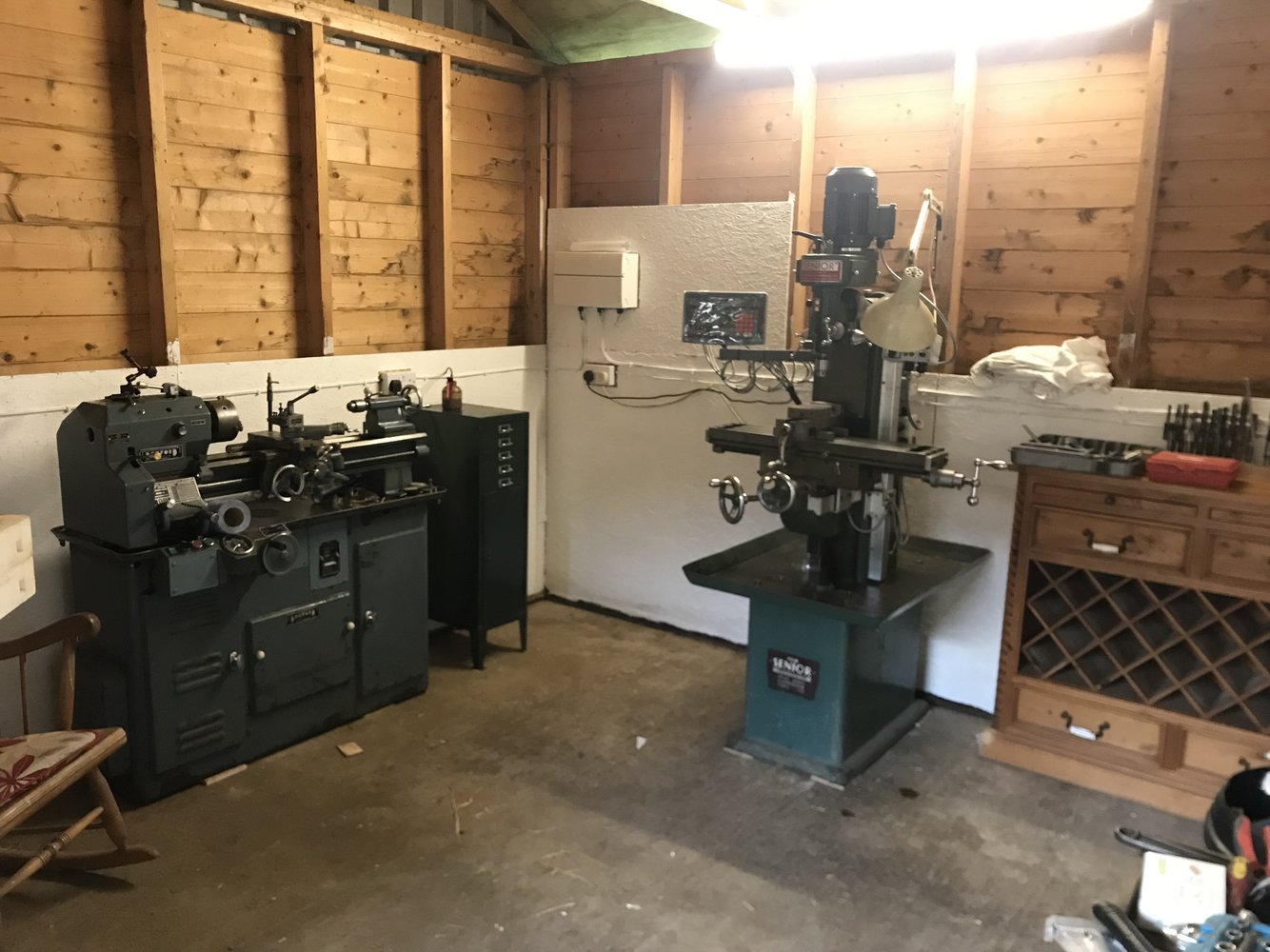

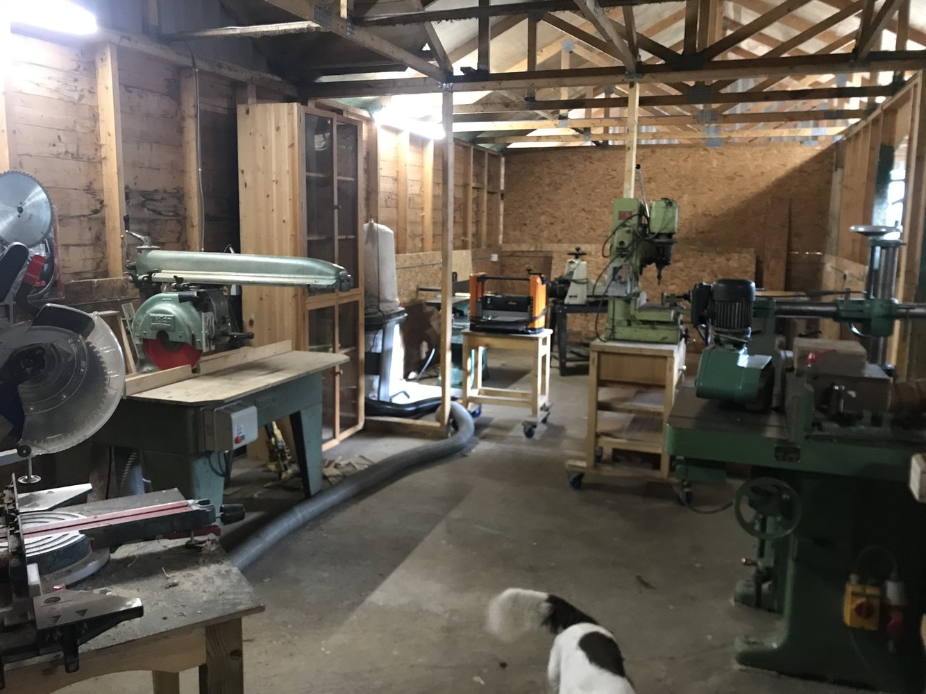

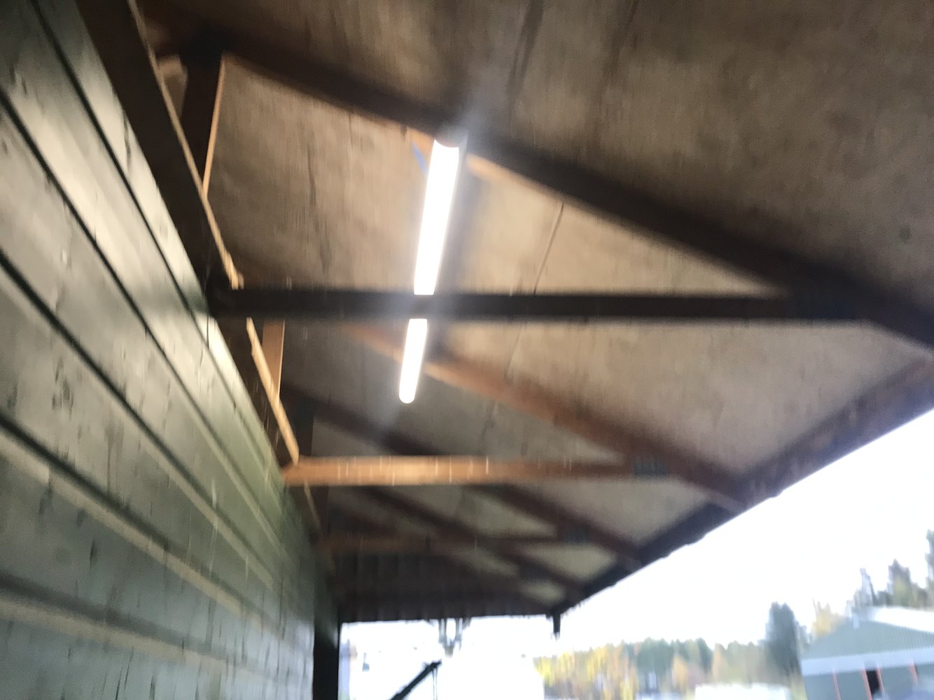

Plan is to slot some sort of insulation behind the OSB inner lining. Cladding is painted shiplap. If I do this, then fill in the missing OSB all the way up, will I need to add vents on the outside, top and bottom, between each pair of studs?

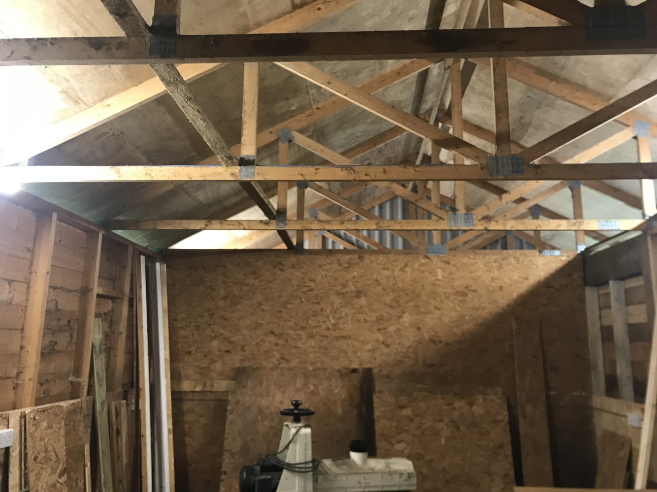

Also, I’d like to insulate and board the ceiling, but the roof trusses are quite a way apart, 1.2m centres (I think; will check). Should I add some counterbattens to stop the OSB sagging?
