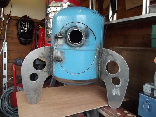

Heh heh I might wear me autoshield welding helmet and thick gloves, might chop a little bit more of the rocket jet nozzle its sitting a bit too close to the launch pad
thanks Strada, I have suprised myself, I thought my old stick welder wouldn't be upto the job and was going to save up for an inverter stick from mr weldquip, but it seems to be coping with what I am using it for, and as me dad used to say to me "If it works, leave it alone"

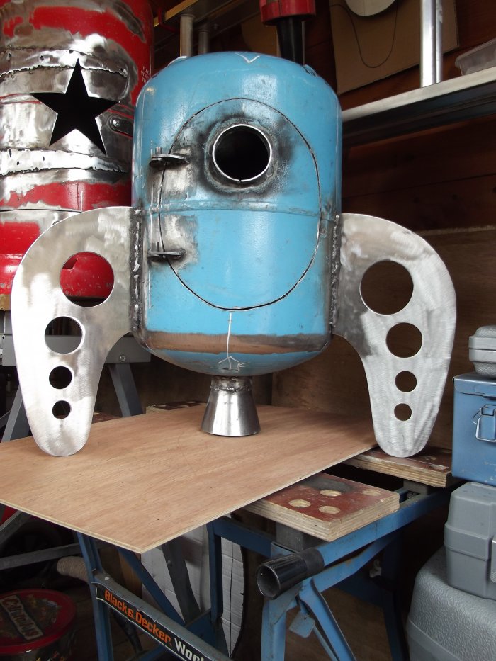

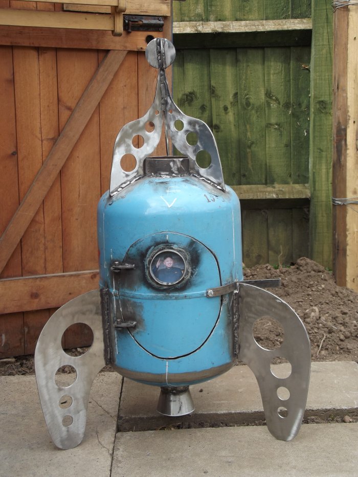

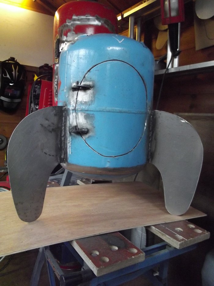

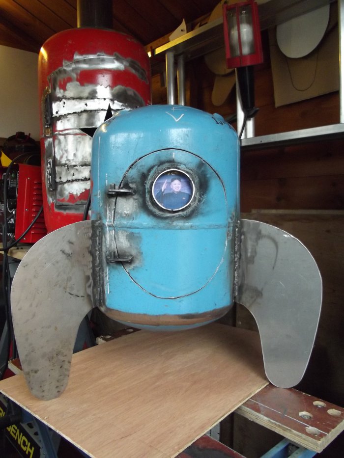

Well I pretty much finished the "Rocket" theme chimnea today, if i can stop my hands shaking I know can get the welds better, so don't be too harsh on me , just looking at the nose cone area, I'm thinking of shaving the shoulders off so to speak, bringing the tip down at a more shallow curve, looks a tad top heavy?
Do you think IT would be better off with 3.2 rods?, I read somewhere they were a bit more forgiving than the 6013 2.5 rods I am using now, or am I best getting the funds together for a mig welder?
