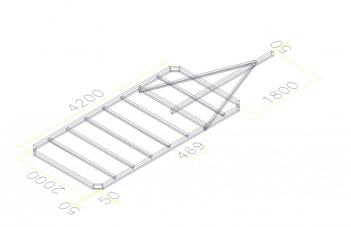

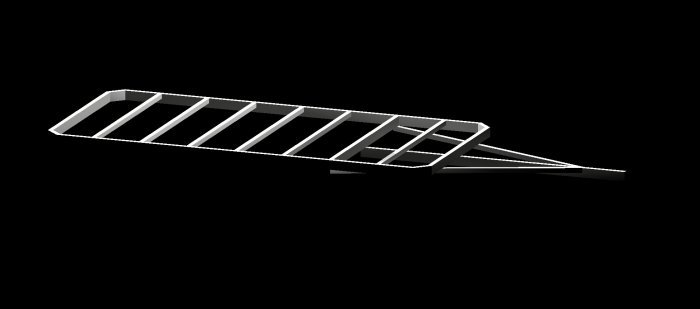

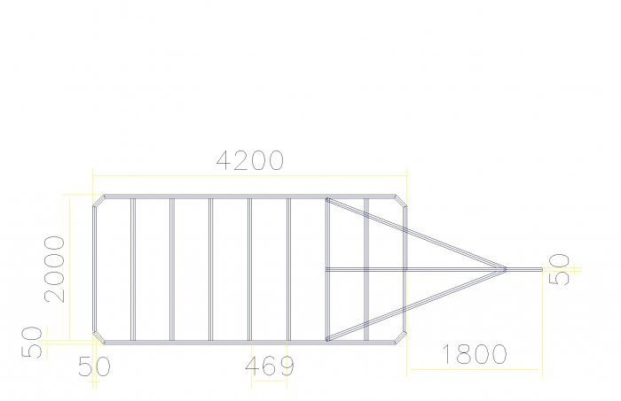

I have been working on a plan to build my own retro style caravan from scratch for the past couple of months.
I am wanting to start with a real sound base and chassis, a flatbed approximately 4200mm x 2000mm.
I personally won't be welding this because of my lack of experience and confidence however I will be designing the specification and materials for my welder!
Having searched high and low for any definitive specifications / guidelines for chassis construction my search has been inconclusive. I am hoping maybe someone on here has experience in this field!!
I have attached three basic drawings with dimensions in the hope it explains what I am trying to achieve.
The main queries I hope someone can help me with are:
- Positioning of the centre line / axle of the wheels (indespension single 1500KG)
- Box section thickness of chassis frame. This is currently drawn as 100mm x 50mm for the external frame and 50mm x 50mm for the cross members. Tow bar 100mm x 50mm welded under main bed.
- Length of tow bar from front of bed to middle of tow ball
If there is anything else I haven't considered at this stage please feel free to point it out as I really am a complete rookie in this field!!!
I am aware this will need registering and also I want something to last so will be happy to conform to all procedures.
Many thanks in advance for your help.
