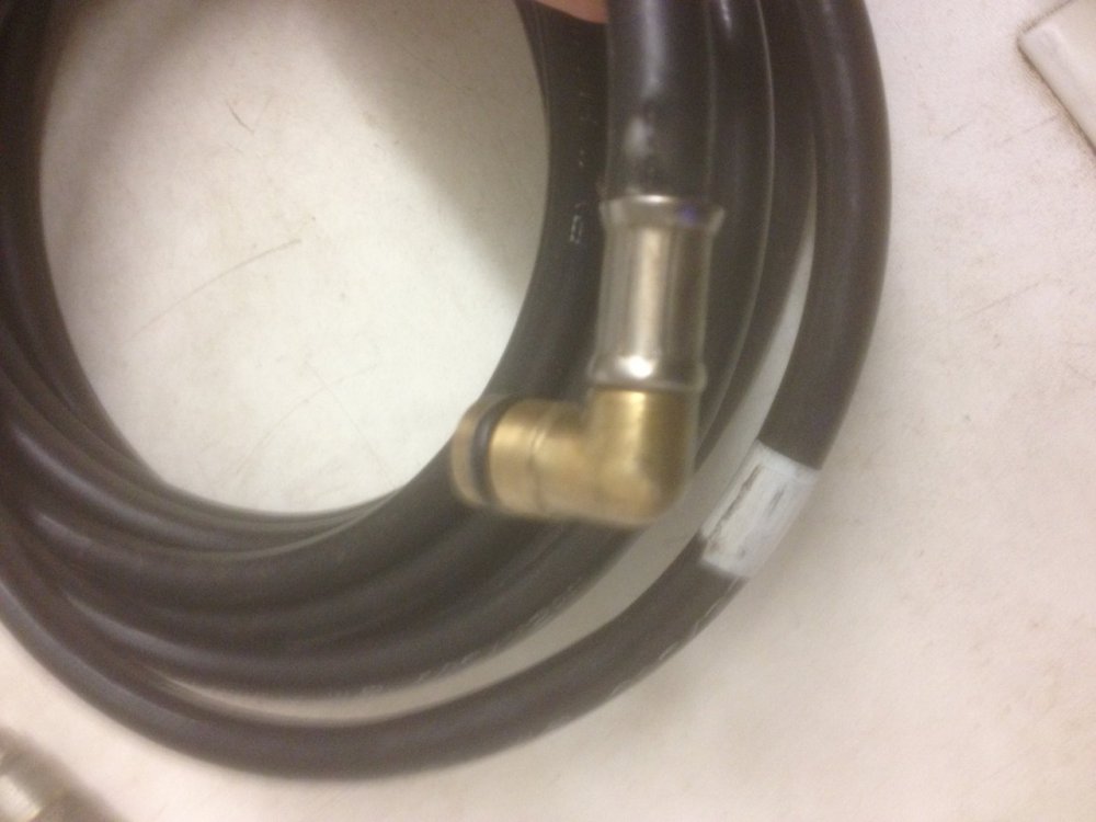

ive had one for a while, but proberly the last month or so its been leaking.
gets really bad when you pull all the hose out.
took the inlet pipe off the side and the seal looks ok
but put a new one on and it still leaks.
so thought it must be the hose then.
so i opened it up and uncoiled the hose from the reel to find.

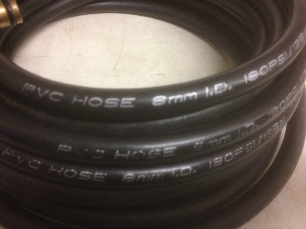

8mm ID PVC air hose
quick release type fitting with seal
and ohhhhhhh dear..

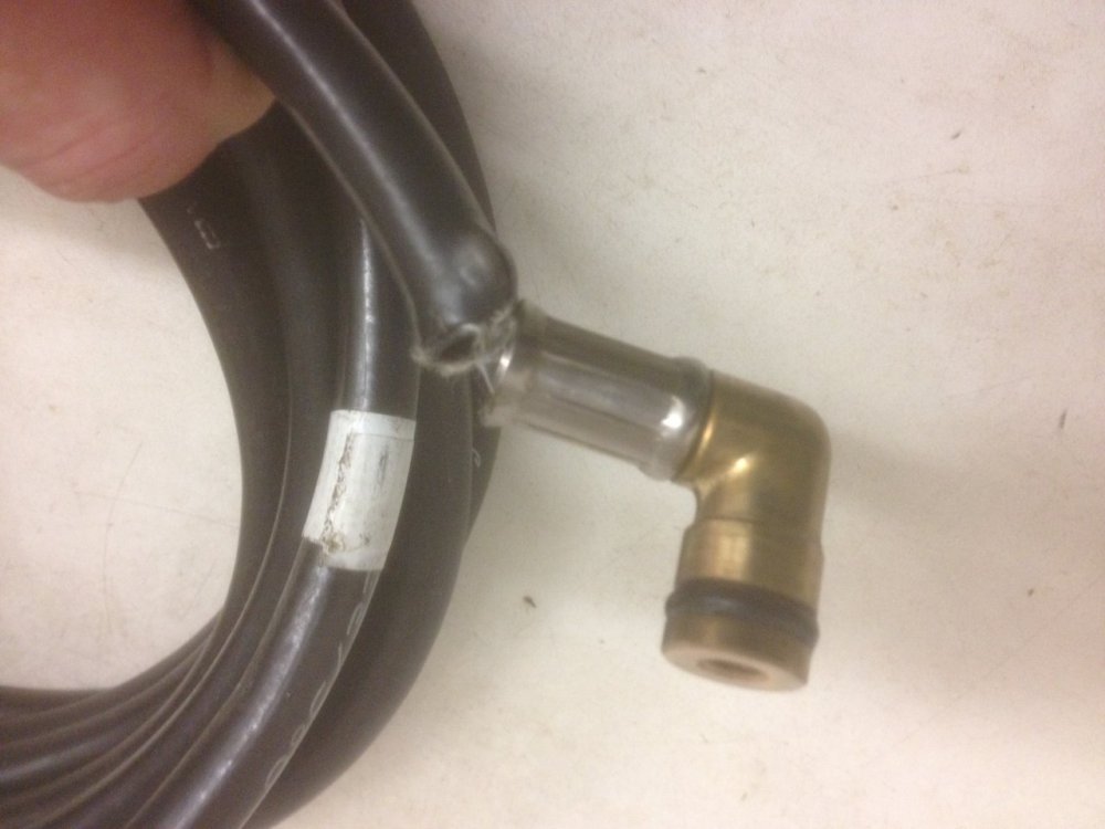

guess i found the leak.....
now to getting it repaired....
crimp style fitting,
if i carefully dremel the crimp and open it up.
cut hose refit and get local firm to re crimp it ?
should be sorted then.......
