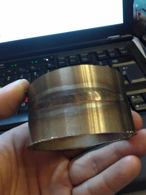

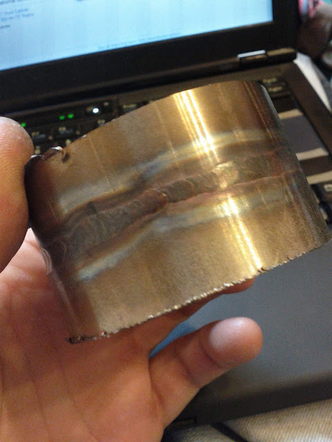

My first try at autogenous on stainless pipe. I really prefer autogenous I think because I can steady the torch so much better by resting my other hand against the torch hand. I didn't do any sort of purge setup because it's hardly a pipe really - just two small cut offs. Unfortunately I have discovered that the blade on my TCT saw (Dewalt 872L) is rubbish, hence the poor mating of the surfaces and thus gaps. So I've ordered a new blade:
The inside of the autogenous weld is, erm, not welded. That's called "poor/no penetration", right? and not good I guess. You can see the rough fit of the pipes too:
All done at ~75 amps, without pulse, 1.6mm tungsten, 6L/min argon.
Any tips? I think I had the arc length at about 2mm ish.
