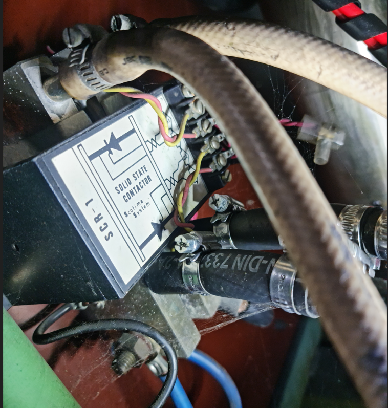

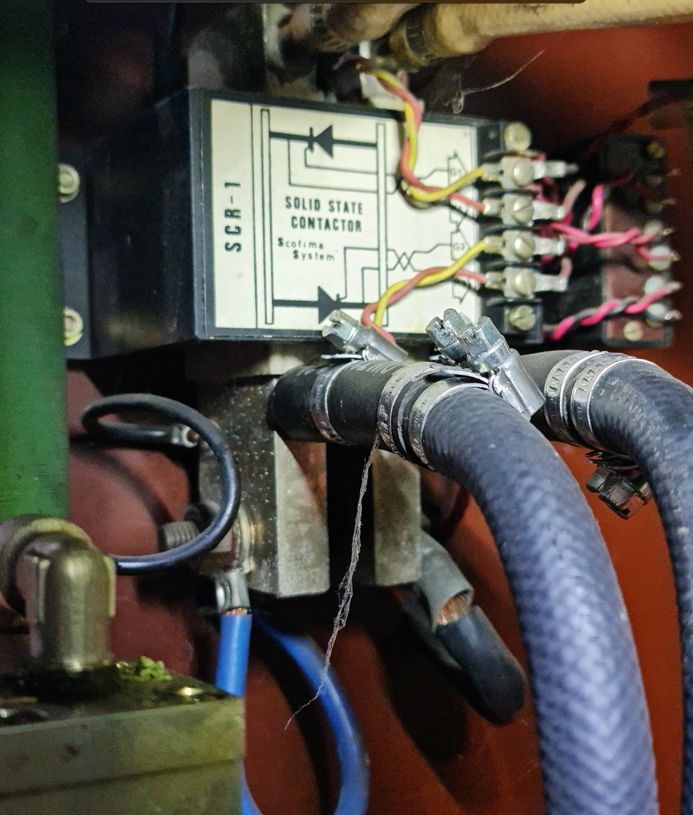

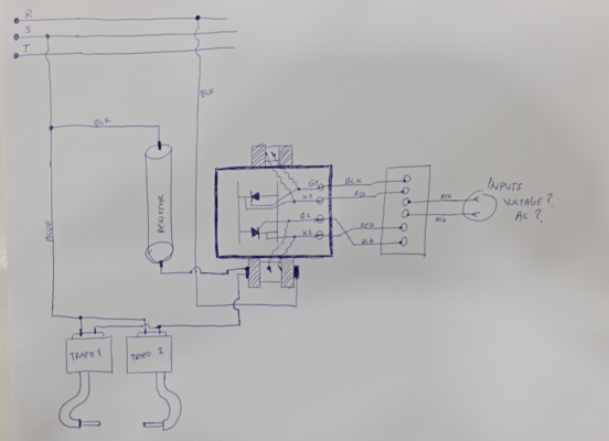

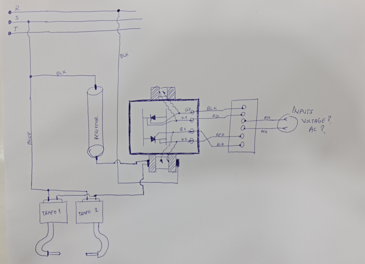

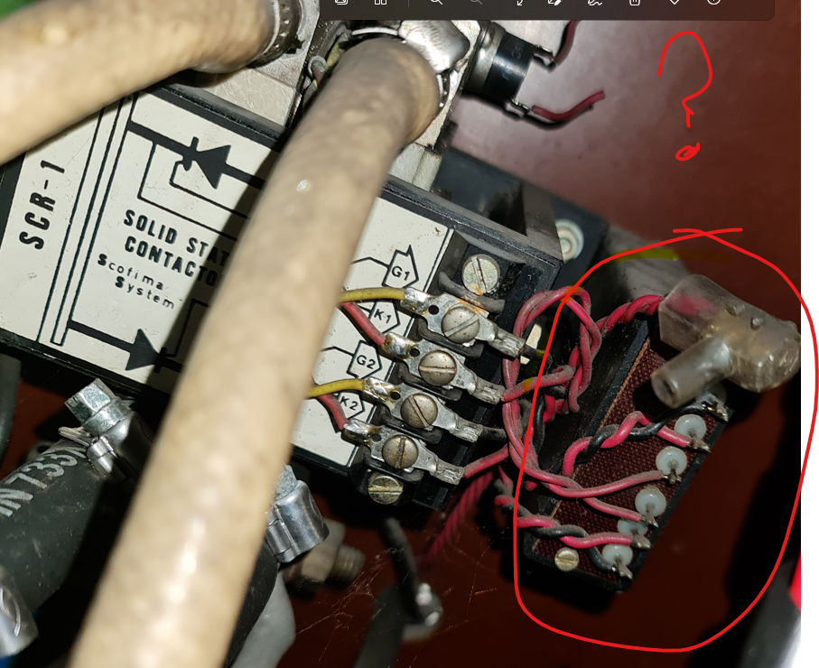

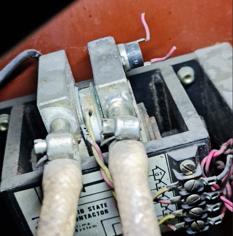

Hi everyone, i have a resistance welding machine its very old. and automatic (Circuit board) is bad. and i plan to set a PLC for controlling mechanism and control welding. So in my case controlling mechanism is easy, but i dont know

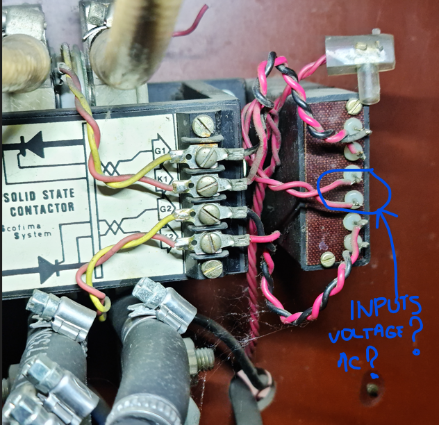

how to control SCR to start welding, what impulse to give to SCR, becouse i have not any drawing connections. i have pictures of SCR, i i dont know what is the part from right side of it. So the main question is, does anyone know wiring diagram of this SCR.

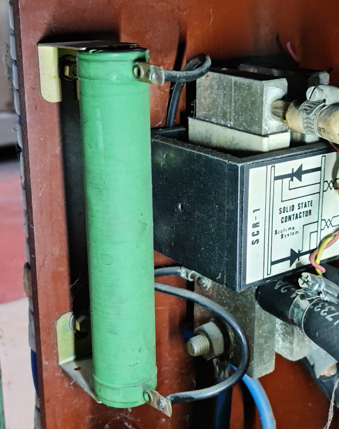

SCR is working before, but now i was planning to set manual switch to start weld throught PLC. but i dont know what is triggering SCR, which connections. And from left side is a large green resistor, for what is it?
this is my first time with SCR'S.
Its water cooled SCR.
