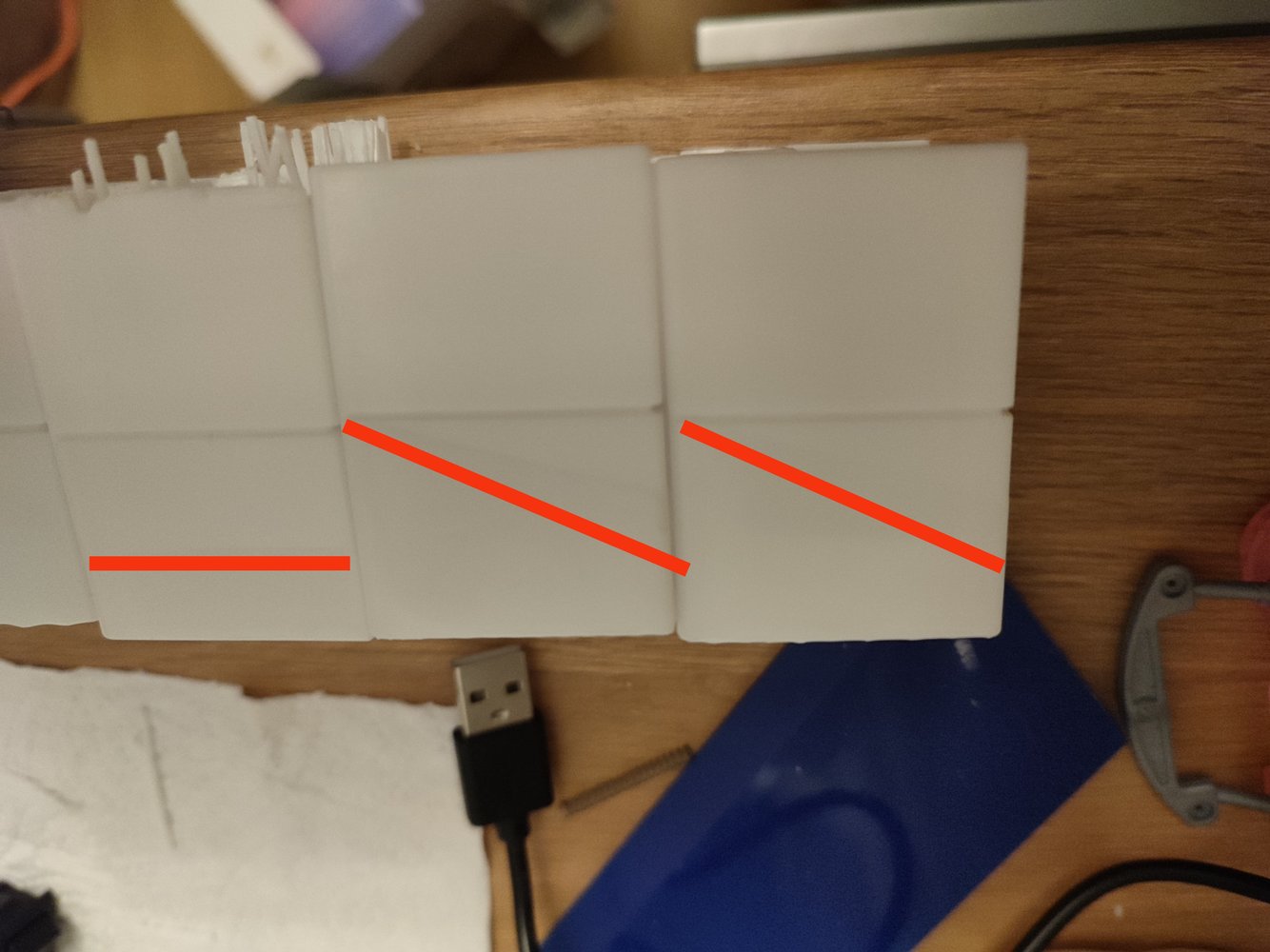

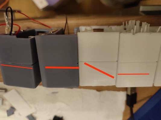

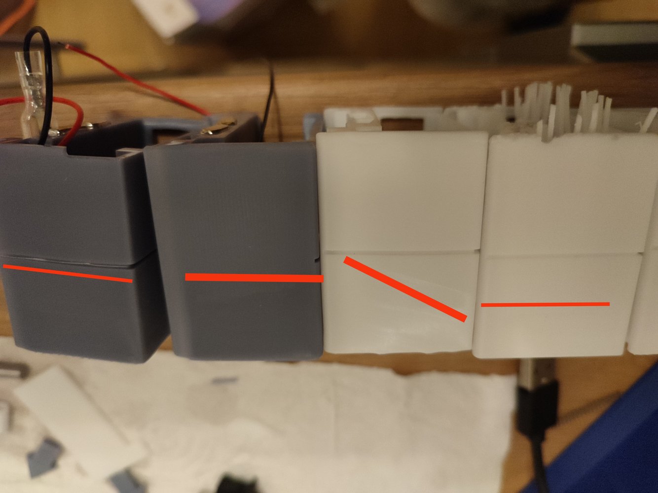

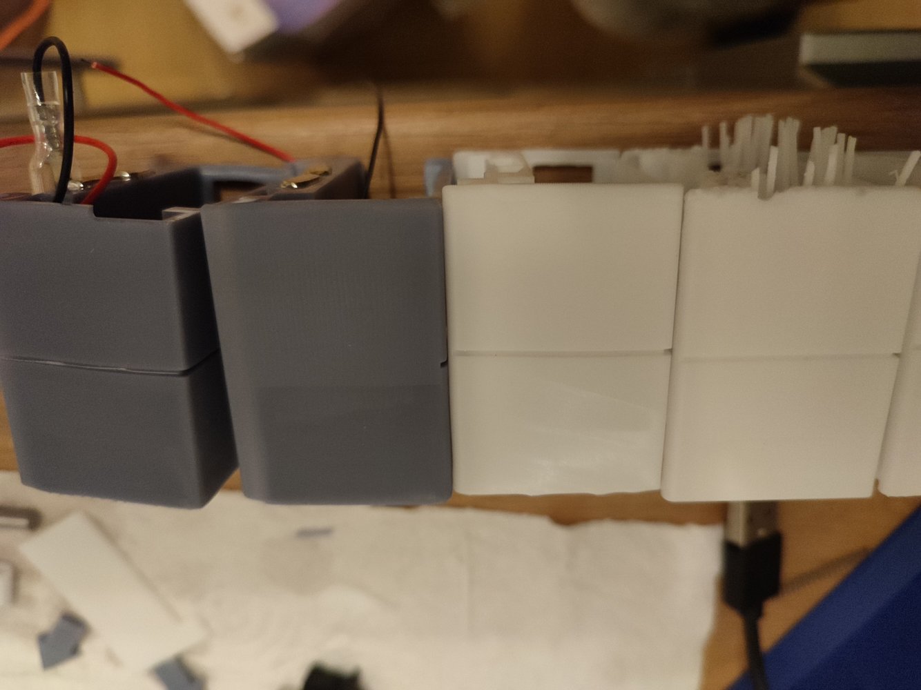

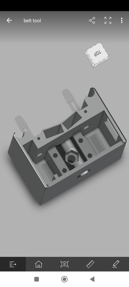

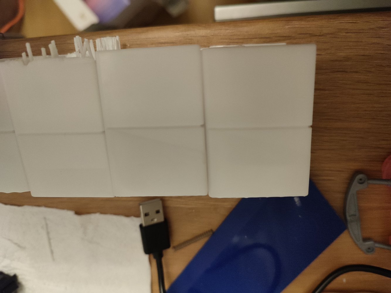

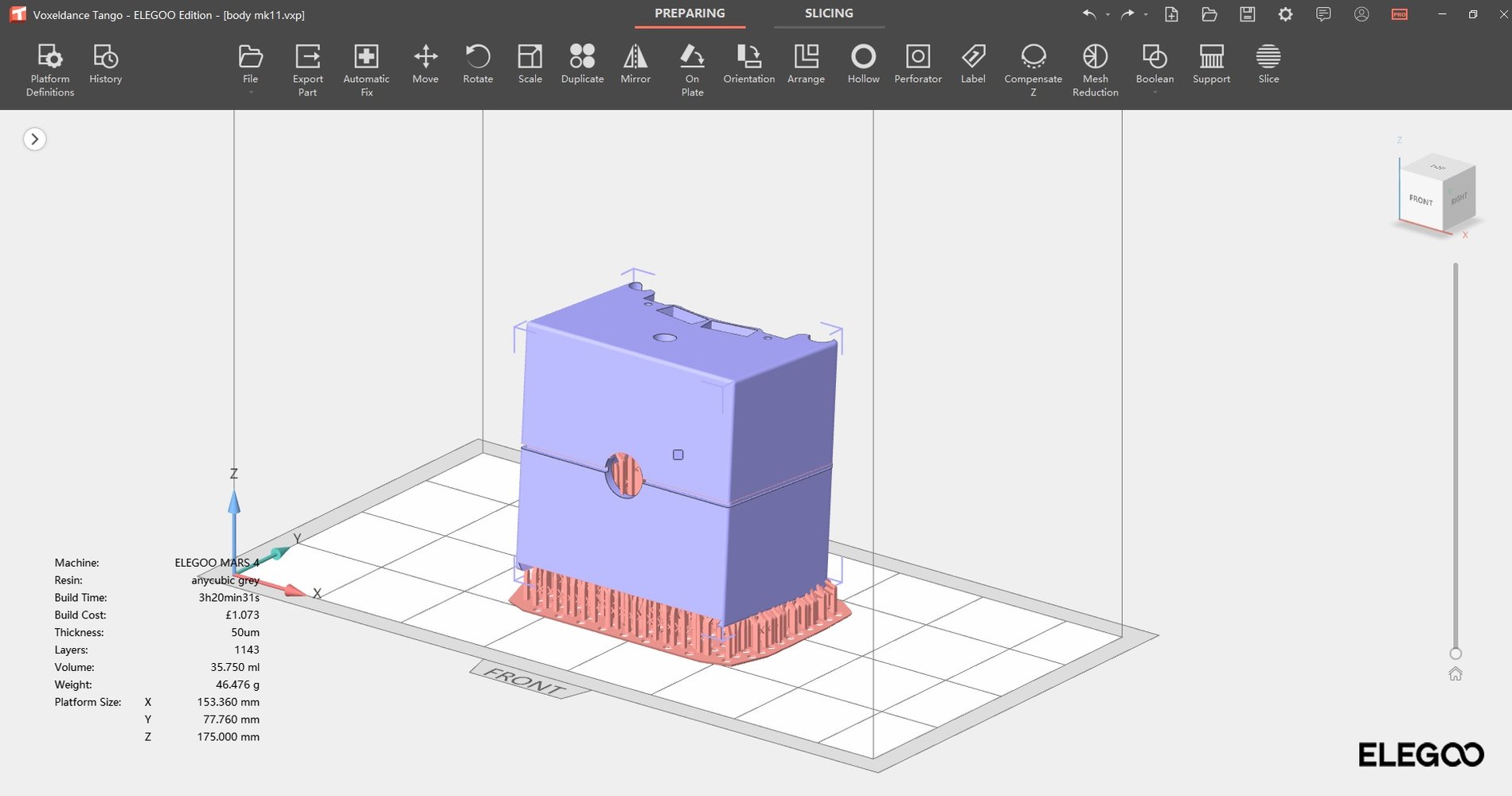

I'm having a spot if bother with some odd banding on a print I have been trying to perfect, always in the same spot but varies in size depending on orientation

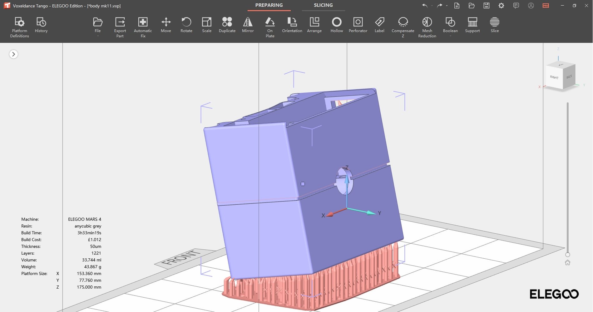

Hard to see but angled ones were tilted, straight faults printed flat, thin flat one with impossible to remove supports was printed upside down.
It seems to be a layer of over exposed resin? When it comes out the printer the band is quite thick and soft, half of it gets washed off but leaves a noticeable protrusion. So much so one of the attempts had the support structure fused to it.

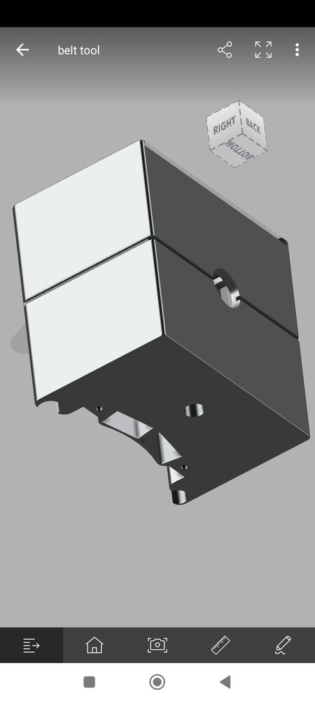

Tried two different slicers, is printed from a fusion 360 generated stl. Anyone seen anything like this? I'm getting quite the collection of failures
