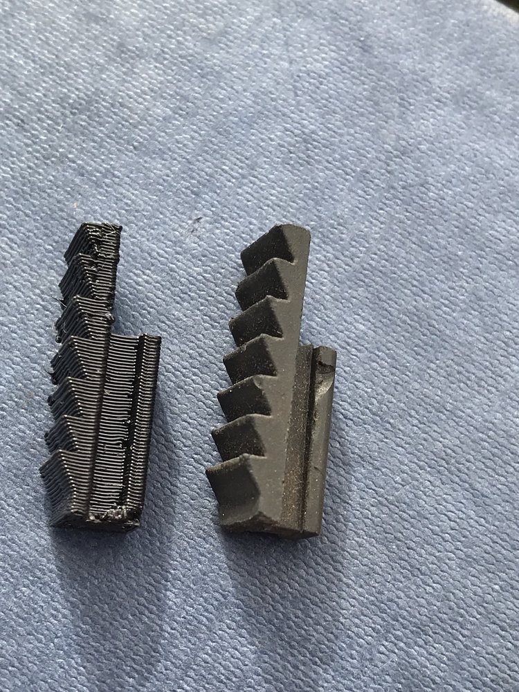

Good info. resin moulds with a suitable low viscosity PU barrier layer would probably work but I would use the original as a master and cast it in a 45 shore PU resin 2 part shell with a core for the foam bit as a first attemptForget about casting silicone with resin moulds. The sulphur in the resin inhibits the curing of two part silicone and you end up with a mess. You can bung the negatives under a UV lamp or in the sun for ages which helps but you still end up with a tacky surface of the part. Darker resins work best for this. You can also get release sprays which help but you lose a bit of definition.
FDM moulds kind of work but the finish of the part is limited by the resolution of your printer. Even using a tiny nozzle with miniscule layers I ended up with a rough finish. Again, there was some tackiness on the surface of the silicone using PLA filament. Other filament materials may be better...
You can get two part PU at shore 30A which I'm going to try but I'm not holding out a lot of hope.
Ultimately I ended up outsourcing to a local company to make the parts for me. Apparently they use resin moulds but they're cagey about revealing their process!
