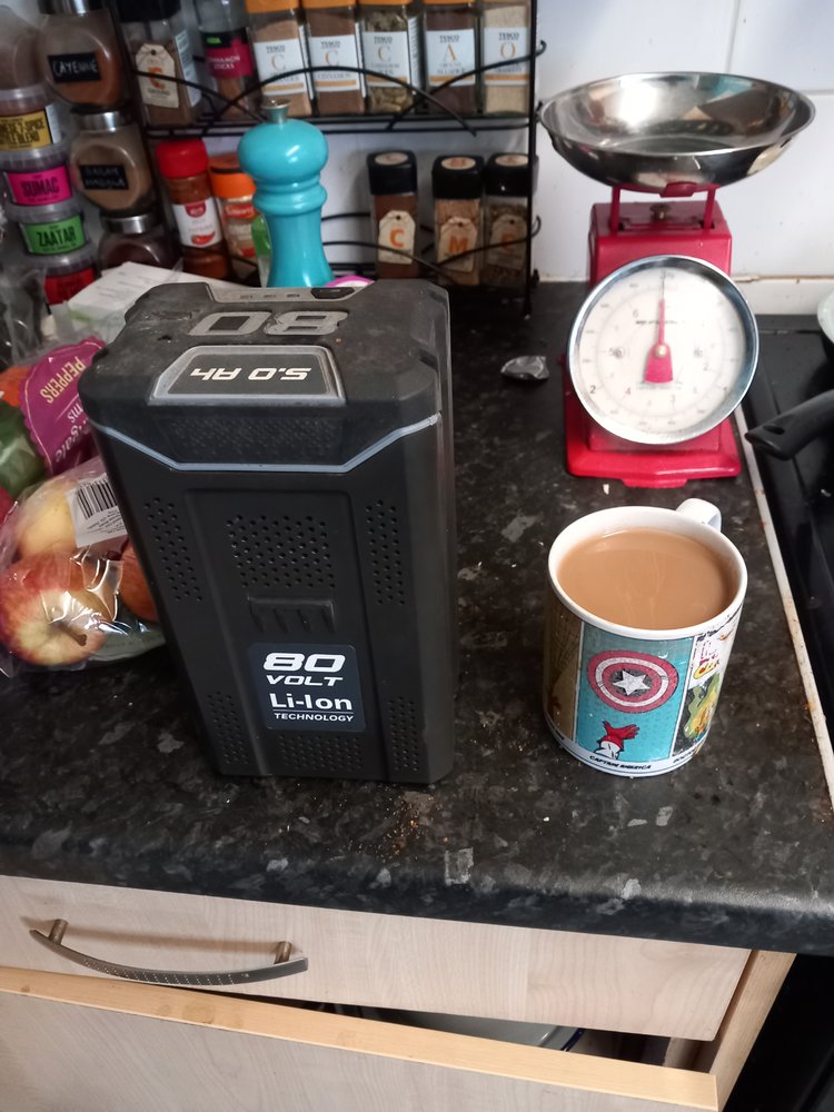

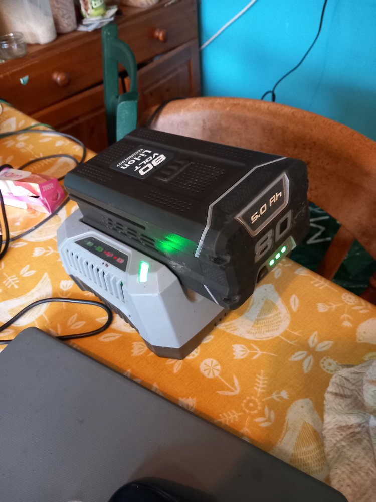

Good advice. It had 75 volts in it when I put it in the charger and it took ten minutes to charge it completely. Nothing got hot while the individual cells were charging or when the whole thing was charging but I'll definitely be keeping an eye on it and storing it somewhere safe. We're still not sure why some cells drained while most were at full charge, it may be related to the transistors that divert current from fully charged cells when it was left for a long period, but I doubt we'll ever really find out.The charger accepting it, does not make it safe, you essentially bypassed a safety feature. Extreme care required, keep it quarantined while charging and after charging in a fire proof place.
It is likely the bad cells will discharge quicker or result in the pack becoming out of balance. I would be giving it some use and checking again in a few weeks time.
Example, a waterproof outdoor container, filled with sand, well away from building or vegetation. If it goes up in the night, no lasting damage will be caused.
