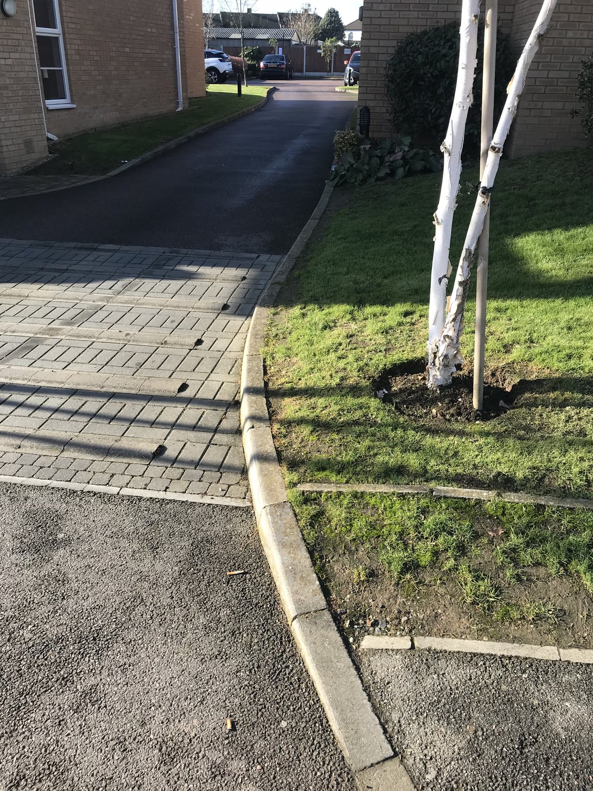

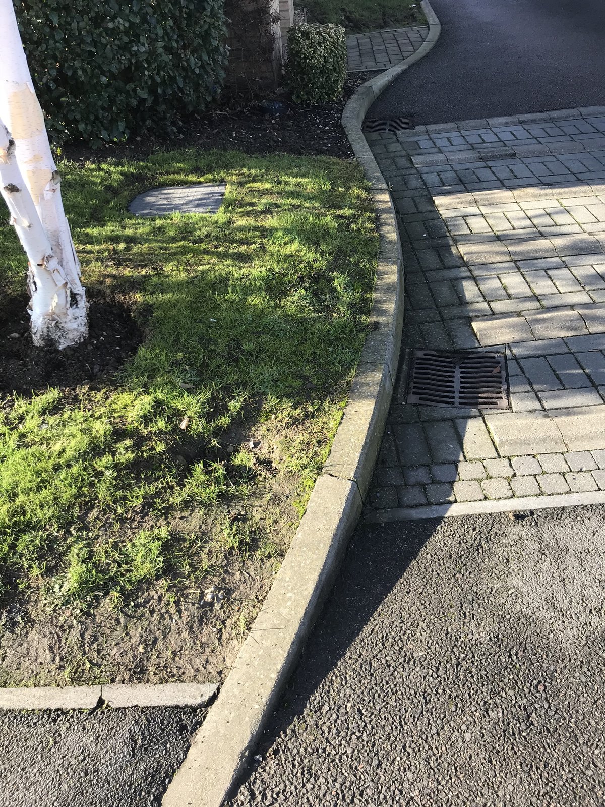

I think I will head down with framing square, tape and length of bar with 100mm marks, measure out to the kerb and record it. Then plot that out onto MDF, and take the template down to the section benders near me.
I'd just use lengths of wire to match the profile , transfer that onto the workshop floor and then bend to shape.
