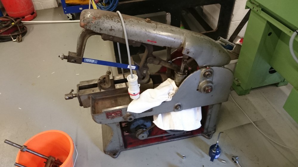

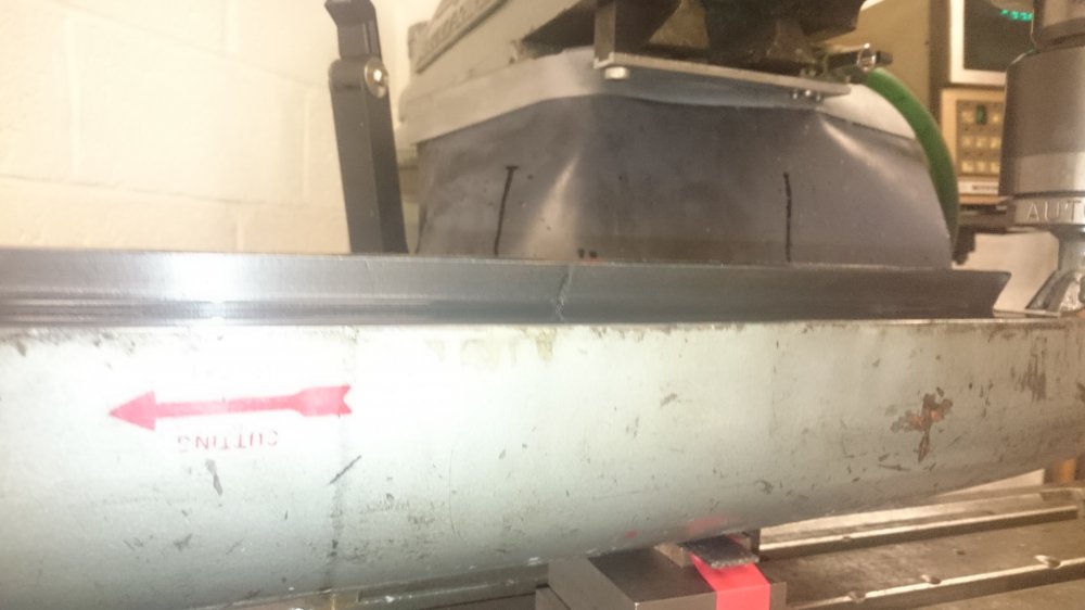

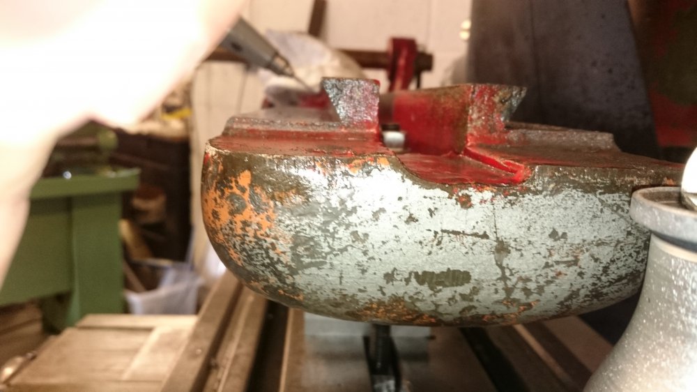

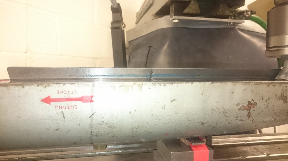

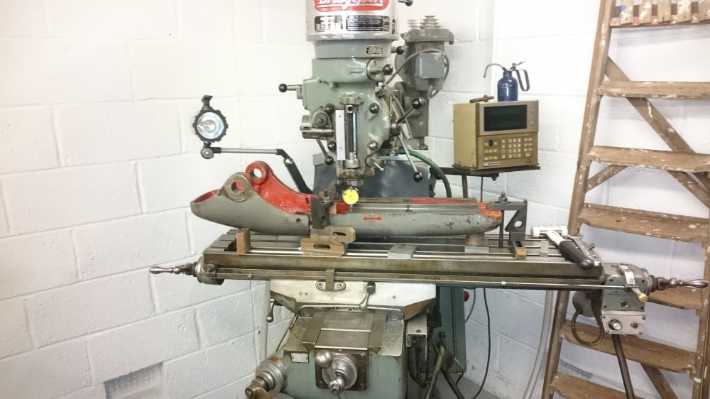

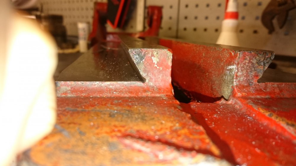

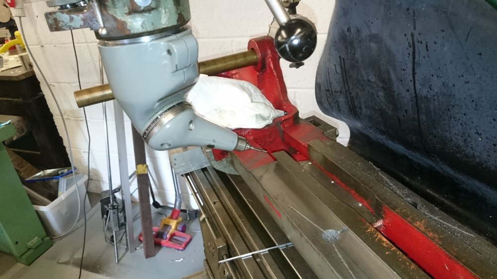

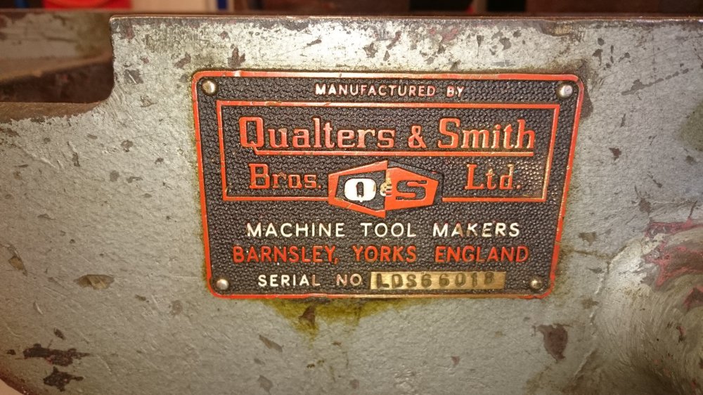

I Have a Qualters & Smith LDS 6 mechanical hacksaw. I have just re cut the dovetail slides on the over arm that the bow runs on & they have turned out quite good. The gibs or wear pieces whatever the correct name for them is on this application, well one is quite worn, so I could mill it back so that it is the correct shape, but then I'd have to make a spacer to go in behind & re drill the mounting holes in the bow. So, if I was to make new ones what would be the preferred material? The originals are some kind of steel, but obviously I don't know what type?
