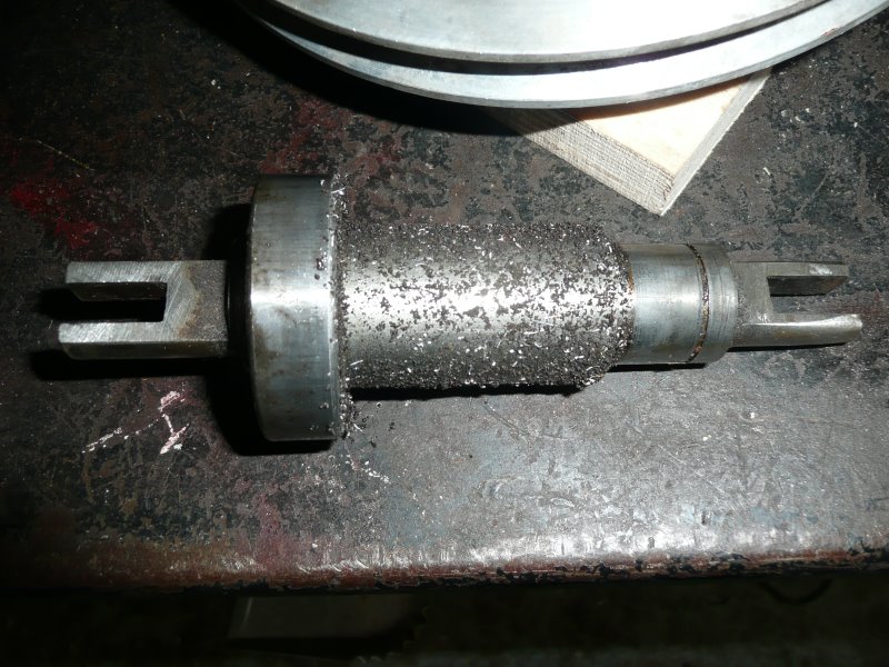

The headstock bearings came out fine and although needing renewal, they weren't too bad, there was evidence they had been replaced before. However the bearings in the intermediate pulley are FUBAR, they are quite gritty and have loads of rolling resistance.

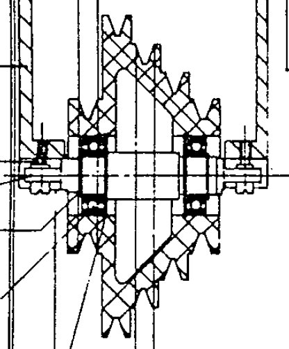

Here's a diagram of the pulley from Denford, the shaft has a 6205-2Z bearing on each end held in with circlips. The shaft thickens in the middle therefore I have to take the shaft and bearings out of the pulley block then pull the bearings off the shaft.

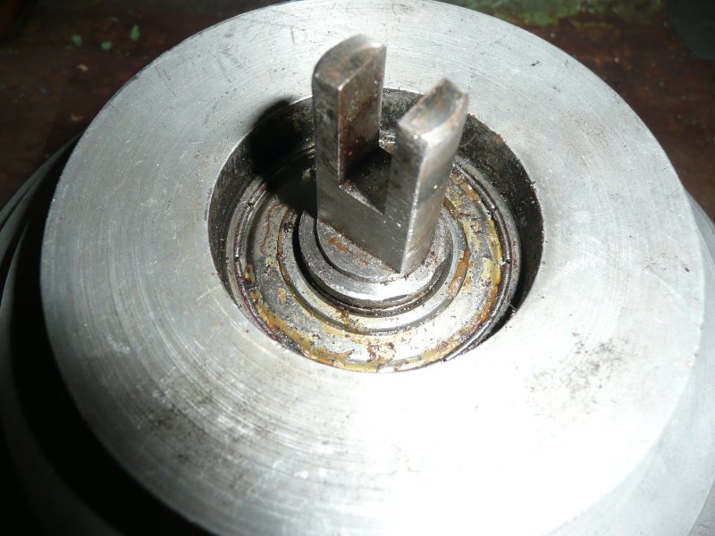

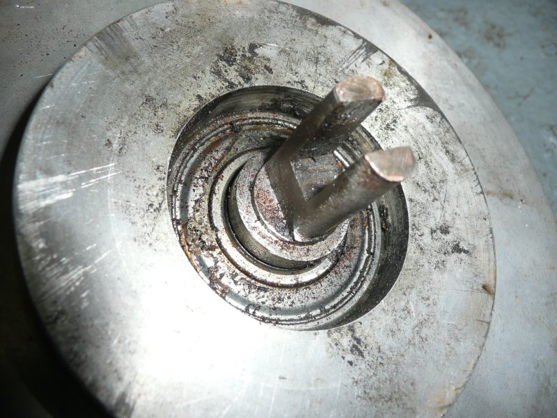

Here's a picture of each end of the pulley block with the circlips removed

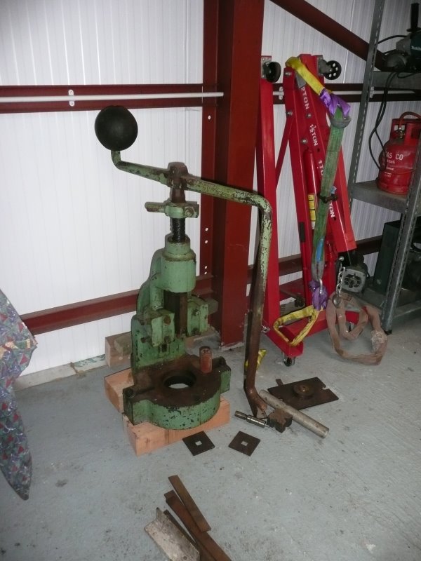

I stuck the block in the oven at 120c for 10 minutes, hoping the greater thermal expansion of aluminium would give the press a chance. Here it is in the fly press, a bit of scaffold pipe protects the shaft and pushes the force directly onto the bearing
I gave it a bit of a thump on the fly press and no movement and its a big old press. I tried in both directions just in case there is a shoulder not shown on the diagram.
I don't want to damage the pulley block so I'm being a bit careful. I could turn the heat up a bit, any tips on how to get the tinkers out of the block without damaging it?

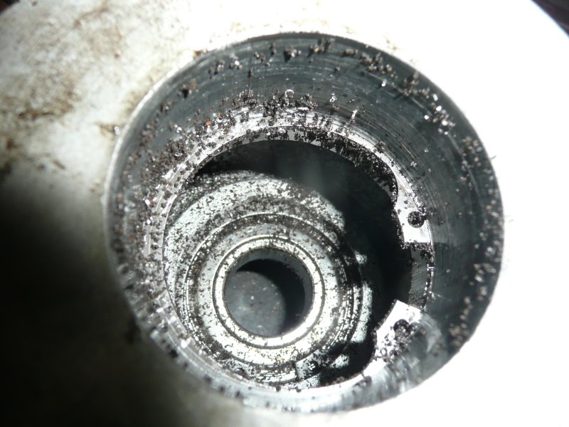

That's one hell of a lot of swarf in there. Perhaps the part wasn't cleaned too well after machining. When I stripped my Boxford, I found a considerable amount of sand inside the casting of the intermediate shaft pulley.
