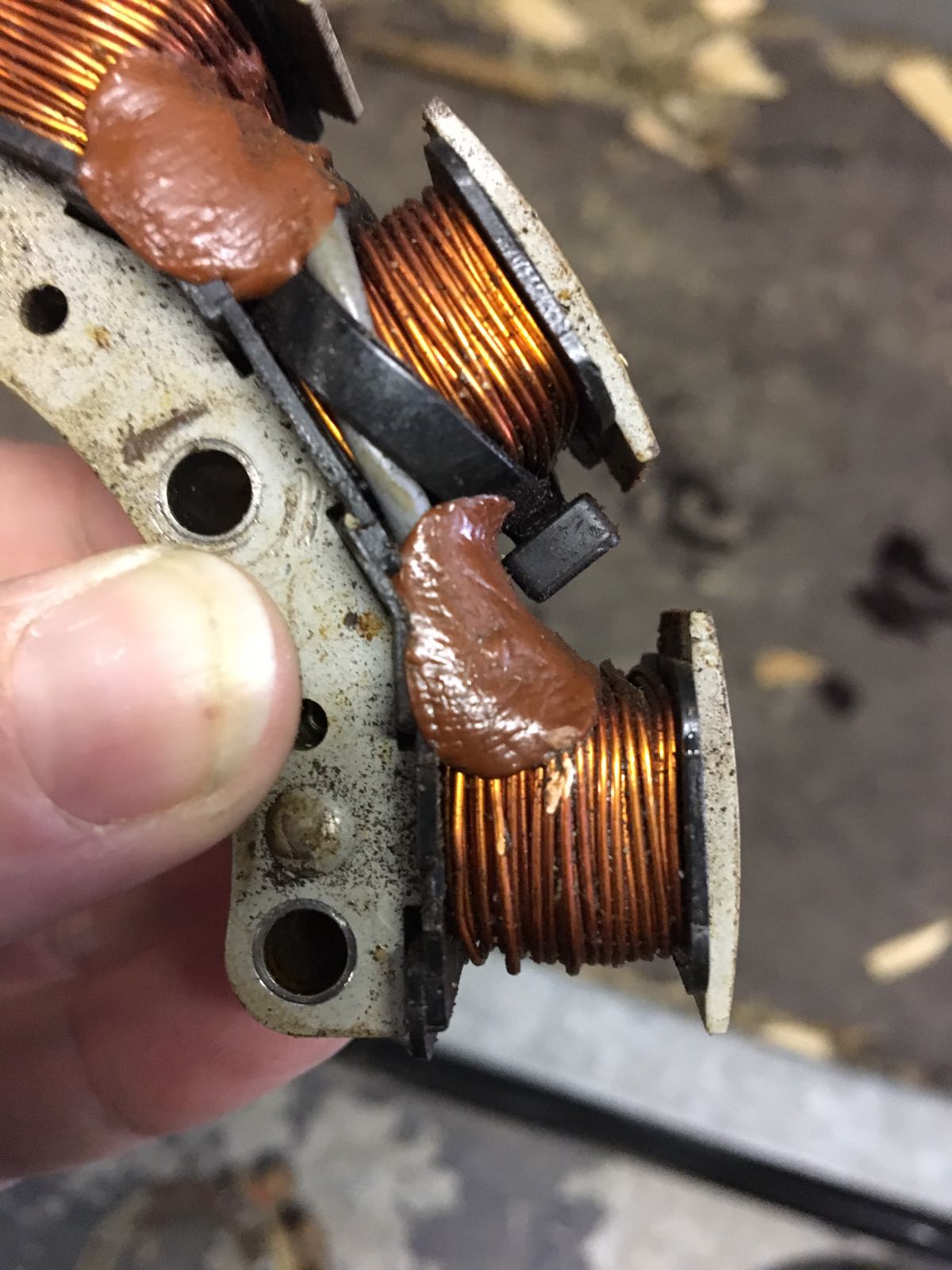

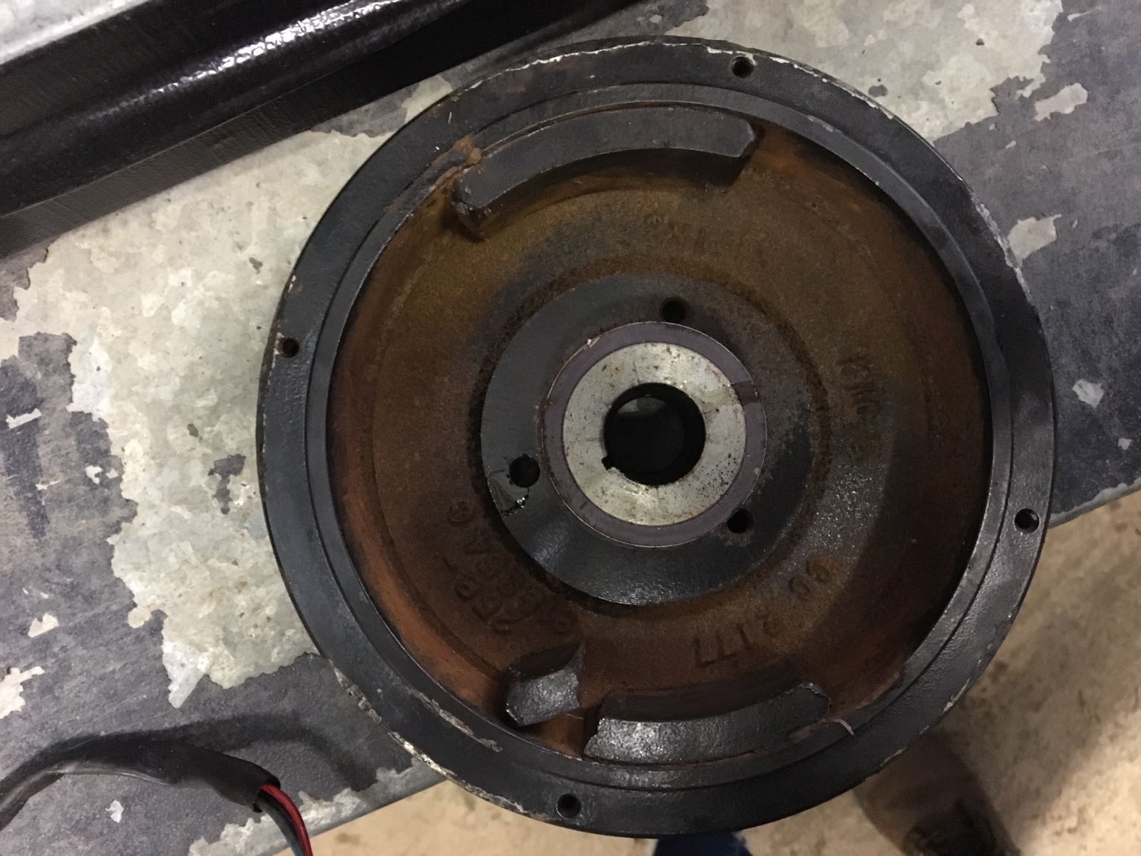

The engine's symptom is no spark. Not a weak one, just absolutely nothing. There's two problems I can see causing this: (a) one of the flywheel magnets has broken off and (b) it's damaged a stator coil. Pictures show the damaged bits.
Now here's my dilemma. It's originally an engine that was more US based in sales by look of it. That means all the decent second hand gear is overseas. That makes is expensive to ship. The stuff over here isn't that good as the selection is small and that also makes it expensive. So I got to thinking; the only things actually wrong are a broken off bit of magnet and a damaged wire.
So what I'm thinking is to remove the broken magnet and replace it, probably doing the other side at the same time for peace of mind. The stator coils should be rewindable so that's what I'd do to them.
My only issue is that I've never done this before and never heard of anyone doing it. That generally means it's a less than stellar idea! So I'm looking for anyone who's done similar to what I'm thinking about and to ask:

I'd considered rewinding myself but had sort of thought a professional outfit would be where I ended up due to time. Good to know you had success though. What size engine was it? I think this one's about 450cc ish.
