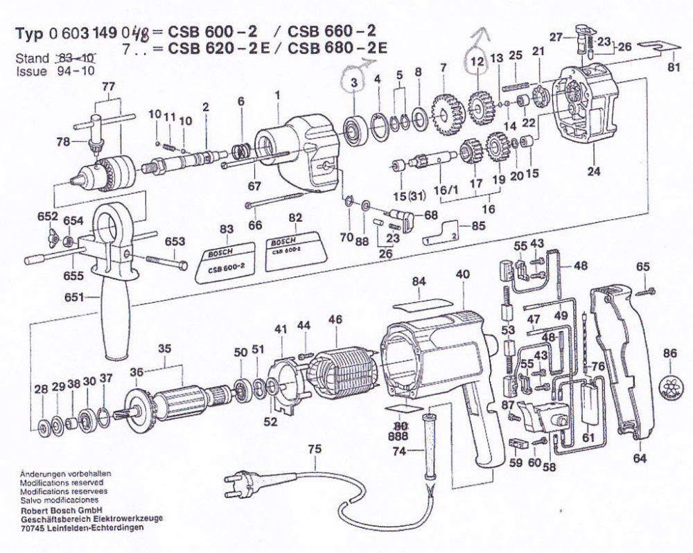

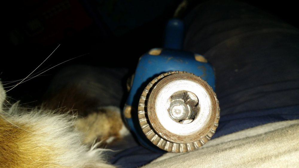

same here so Paul might be spot on .......its just the spanner flange has me confused.does not seem to show the left handed bolt in the chuck that I would expect.
Stan

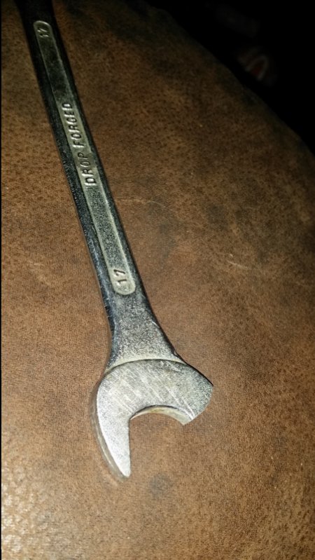

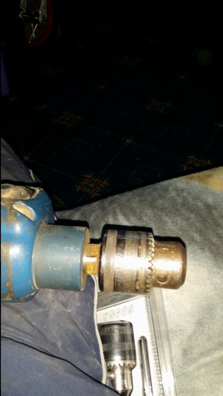

That worked a treat. No heat and not a massive amount of pressure although I did use a bar on the spanner. Weird how it did not move when I used a sledge and spanner....lolHave had problems getting chucks off Bosch drills in particular. They tend to be very tight - possibly Loctited. I would recommend slow steady pressure on the spanner flange ( rather than a sharp blow ), with the chuck clamped in a vice, and maybe heat too.
I hit it a few times before it broke lolwell it wouldnt if u whacked it and snapped the cheap spanner 1st![]()
