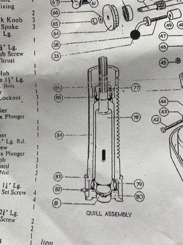

Right, back on with the meddings. I kept looking at the spindle. I played with it and decided it had enough slop to bother stripping.
knocked the spindle out of the quill and we seem to be short a few BB’s of a full bearing!
Someone must have been in here before and lost a few. I can imagine one or two bearings shooting off and being lost to the quantum realm in my workshop but to be missing 6 seems like something is amiss.
So the outer race is stuck in the quill. Do I weld a ring round it with the TIG to drop it out?

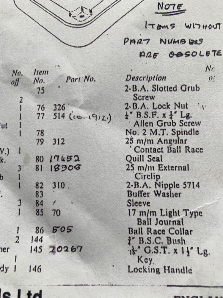

the bearing that came out had a brass cage. FAG sell a similar looking affair for £28. Would that do me?
