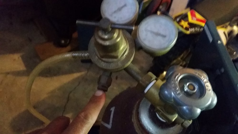

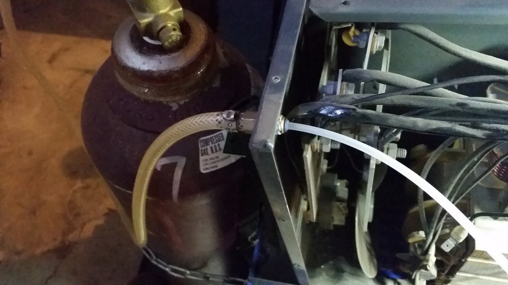

Guys, sorry if this is not the place for this, but I am a newbie to welding and recently tried to replace my MIG gun, gas line etc.....problem is: I connected the gas line (white, shown in the pic), and when I turn the gas on, I get gas blowing out of what appears to be a leak valve -see pic (sorry of this is not the correct term) The gas does not leak where I put the line into the connector attached to the back of the welder.
I don't understand why the gas is leaking out of this valve. My tank will be empty before I know it at this rate.
Please see pics.
Any help will be greatly appreciated.
Thanks!
Please see pics.
Thanks!
Wow!
Ordered new fittings and while I am waiting, I managed to find an in-line fitting at the local hardware store and got the lines connected without and leakes
