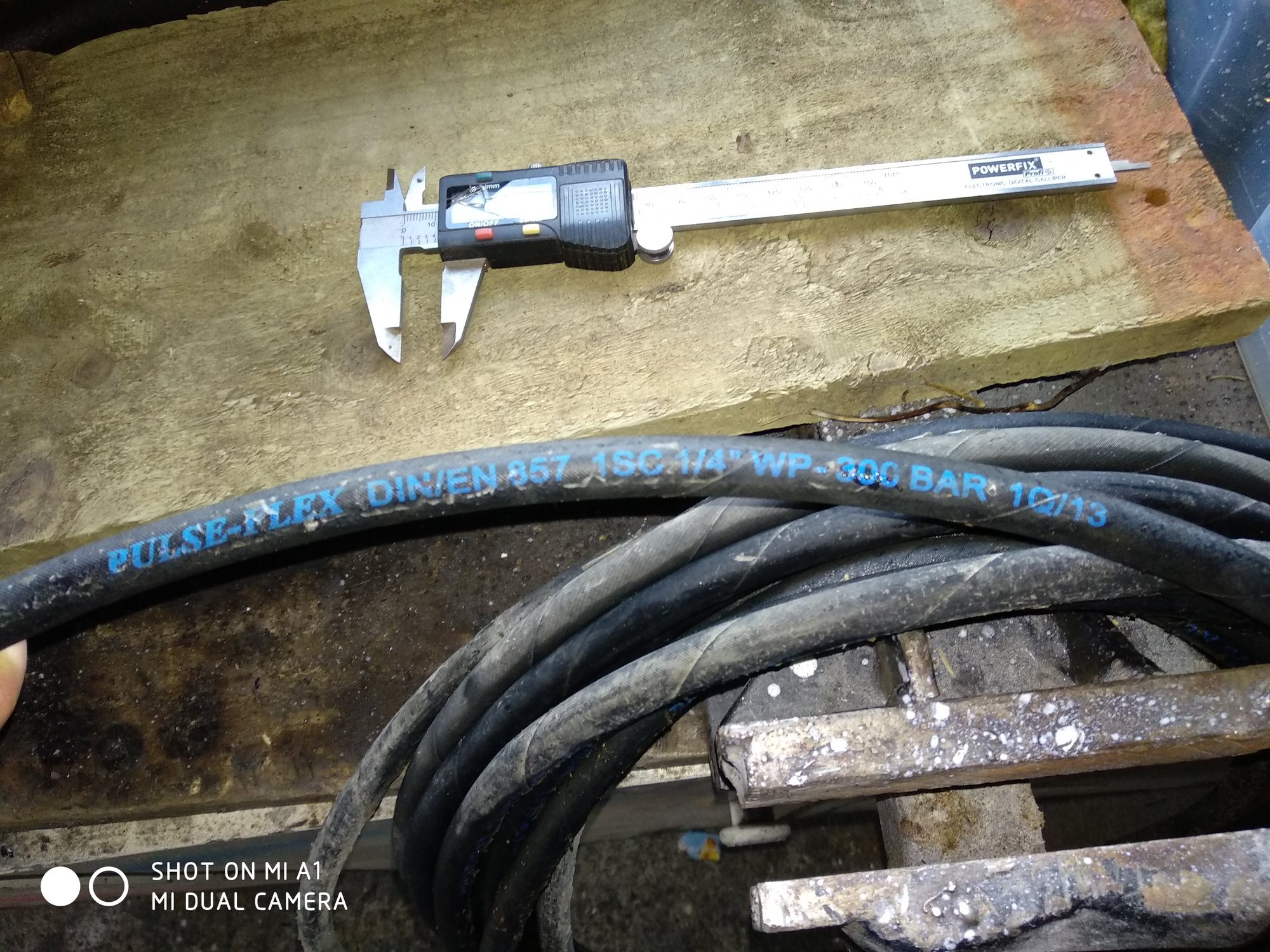

swag them properMy local hydraulic place do it
swag them proper
i did try! jubilee clips lasted less than a minute!You can't risk doing it any other way, even bottom end machines generate pressure in thousands
ive had a few of them as wellyou can buy re usable hydraulic hose fittings , they go on in two parts that screw into each other , ive used them in the past , but they are expensive.
