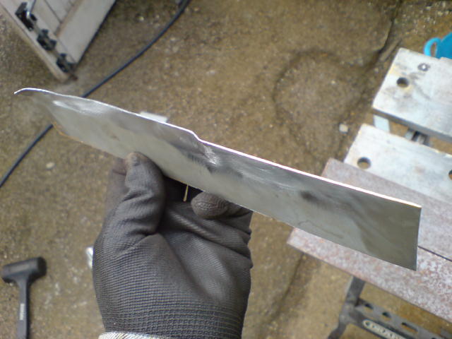

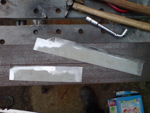

these are the two repair sections that I ended making. they were held between a couple peices of angle iron to keep them straight with the top part of the repair section formed to suit the existing inner wing
and the edge of one of the repair sections. the repair section are made roughly 25mm too tall but the excess will be cut off after the outer sills have been welded in place.
