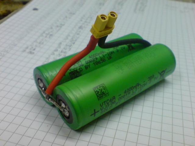

Whilst its relatively safe to solder to nicad/nimh it very inadvisable to solder to li-ion cells! Very easy to damage the internals of the cell.
I use one of these to spot weld li-ion battery packs. If you do the well documented upgrades on it & use a car battery as the power source it welds 18650's ok with practice. It will weld 0.15 pure nickel strip if you have it wound up fully but you will have to stop every 8 welds or so as the leads get a bit hot!
