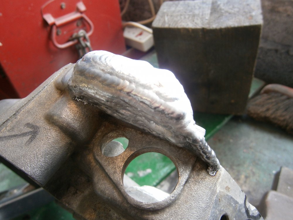

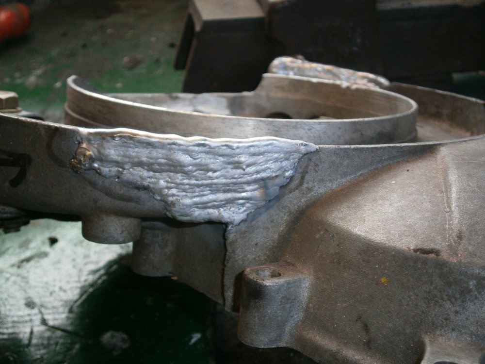

12mm is bl00dy impressive.I have a garage full of bits to do for folk, mostly off Lambrettas which are generally more straight forward, good idea with the pre heater although most of the stuff doesn't get much thicker than 3mm, anything over 6mm and I switch over to Ar/He, either Universal or Heavy then I can go up to 12mm without any problems
