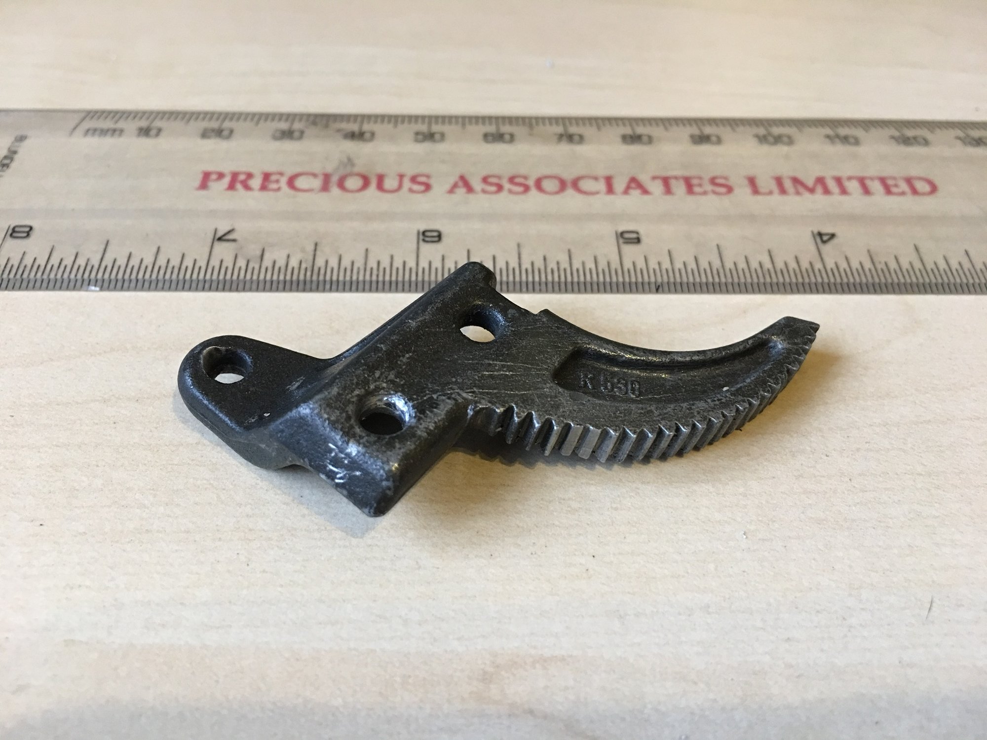

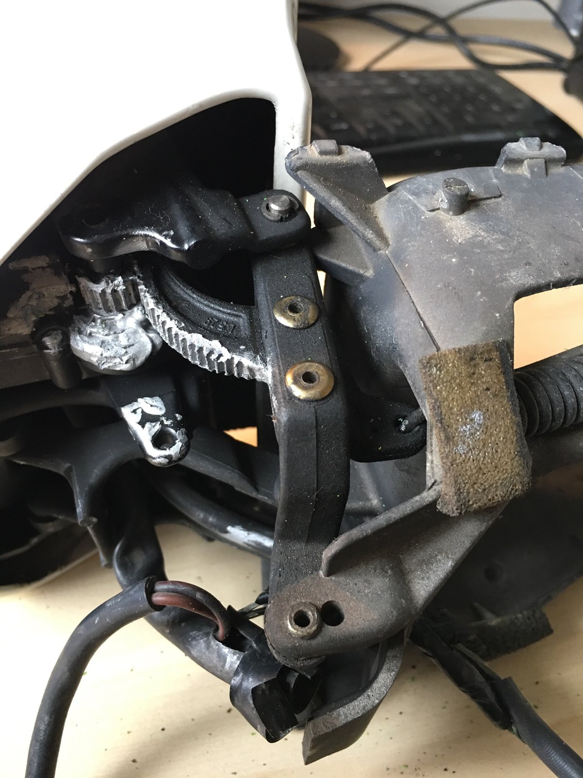

Looking at the assembly the gear is a simple quadrant, the small drive gear follows an arc defined by the pin with the circlip. That being the case you need to find the gear module - as it’s from a Merc it will be metric - then obtain a standard gear from somewhere like HPC and cut the quadrant from that.Here is the other good side showing the drive gearView attachment 151786
