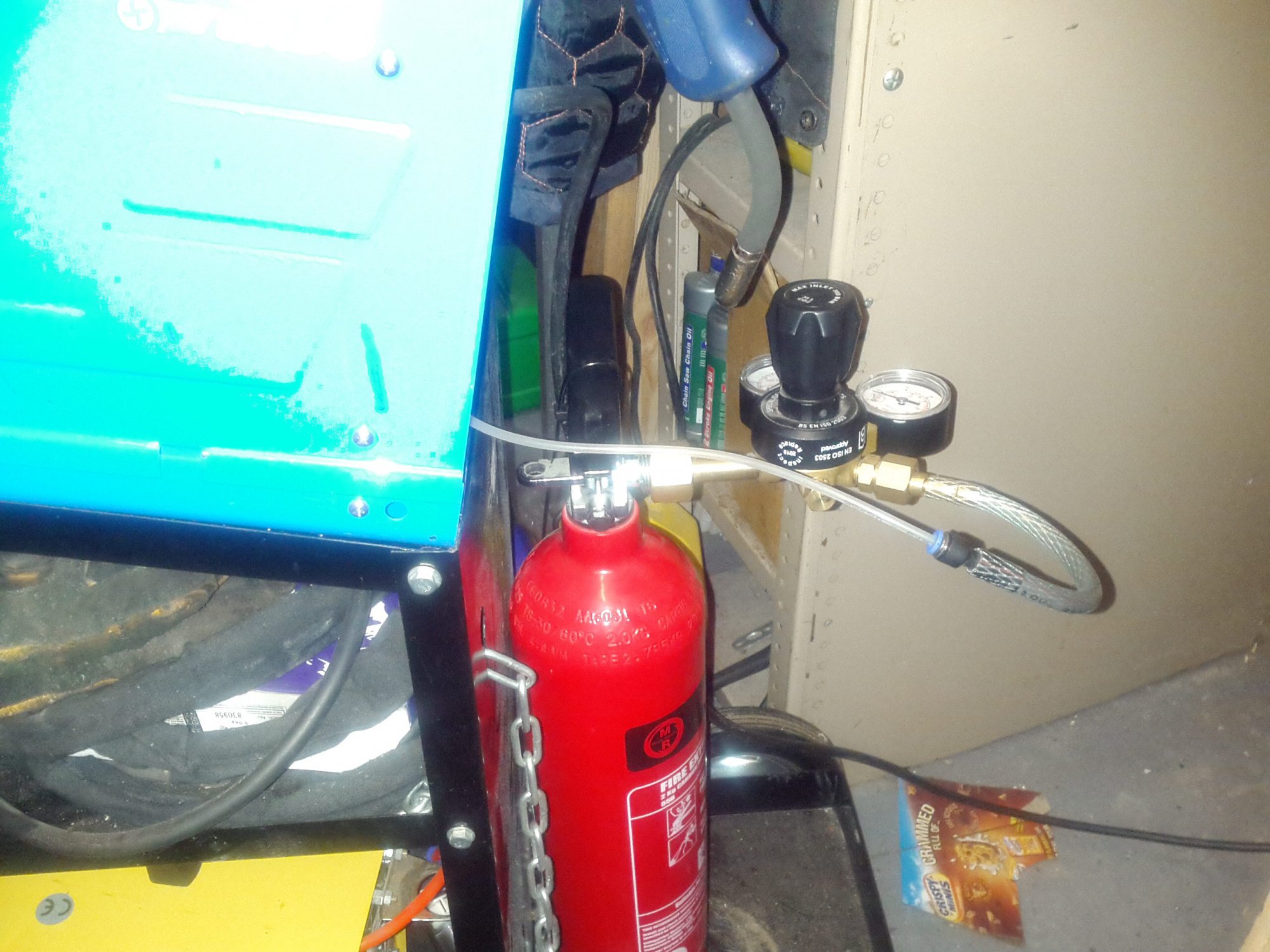

Had some welding to do today and ran out of gas. I have a pub bottle and use co2. It's a bit of a hike to get it refilled and would have taken up most of the day but I have a spare co2 fire extinguisher so I took the nozzle off and the regulator fitted straight onto the bottle.
There are probably reasons why I shouldn't do this but it got me out of a hole hope it might help someone else.
All the types of co2 bottle will freeze up if you are drawing a lot of gas or a long time from them.
Either dunk the whole thing in a bucket of warm water or aim a fan heater at the regulator.
