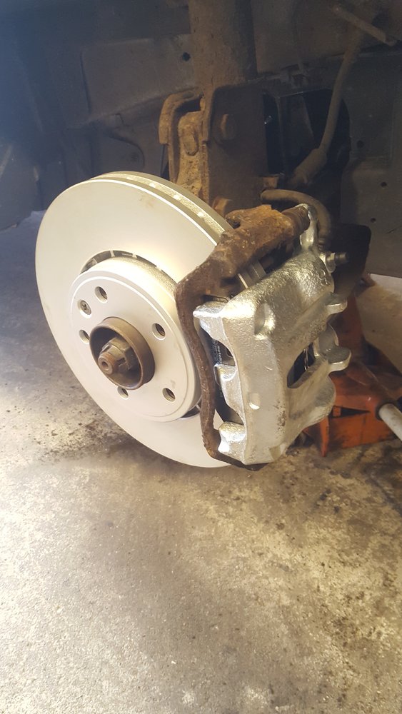

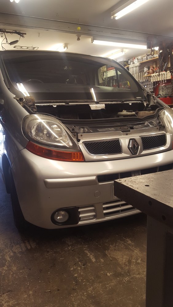

Today i gave the Renault Trafic new discs,pads and calipers..Also oil and filter including gearbox oil change too
You was lucky - I thought all these Renault Traffics had bearing built into the front brake discs
(it is nice to do the whole axle as a pair. Calipers/discs/pads - clean all the slides/carriers/hubs up.)
Nah only the rear discs have the hub bearing in. (Can get them complete and or swap the bearing but it's a nightmare)
The fronts are normal drive flange hub.
I have done a few rears on Traffics/Vivaros - I ended up making up a puller from an old discs (stud PCD matches) and lump of plate with a force screw thru it (M20).
Inverted disc - using wheel bolts
Yea exactly! Not worth the hassle anymore in my eyes. Only like an extra £35/disc for the ones with the bearings.
Buy and bolt on, convince is worth that bit extra.

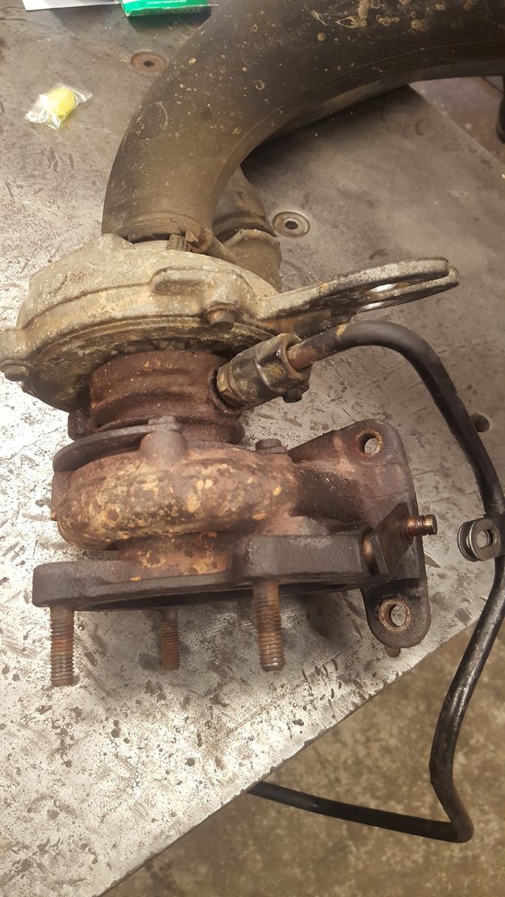

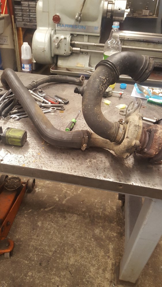

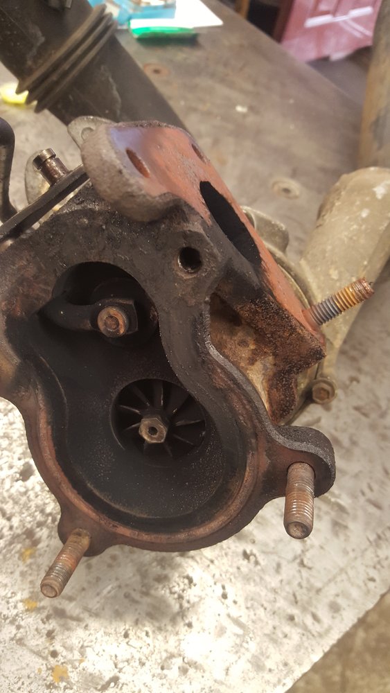

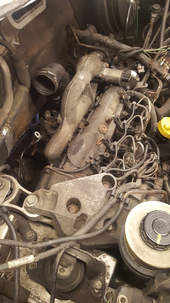

...anyway looks like its the original turbo after 172,000 miles so will be getting a new cartridge from Melett,s while ime in there given its such a pig to go back in if the turbo lets go in the future. The van was beginning to feel a bit tired and discovered the wastgate is sticking on the inserted shaft and the front of the compressor blades (no pics) have took a bit of a hit from debris in the past so will be checking the intercooler is spotless inside.

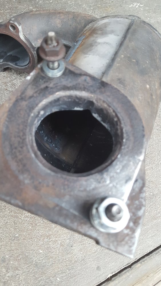

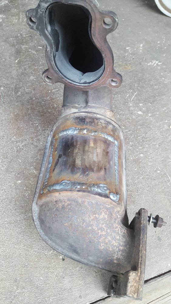

Looks like someone removed the money allready
Yep that's why i done itIts only a cat , should be an audible whistle off the turbo since that was done
plus i have a new turbo coming with a bigger front wheel for that smile factor
