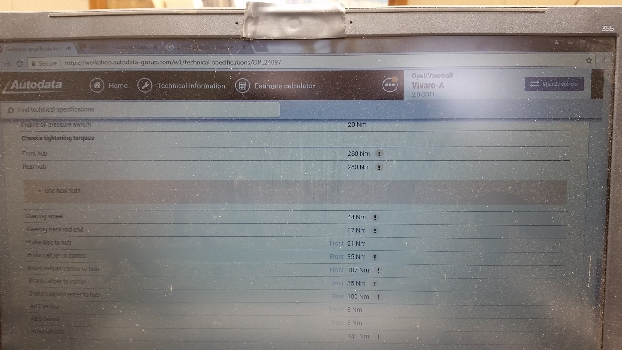

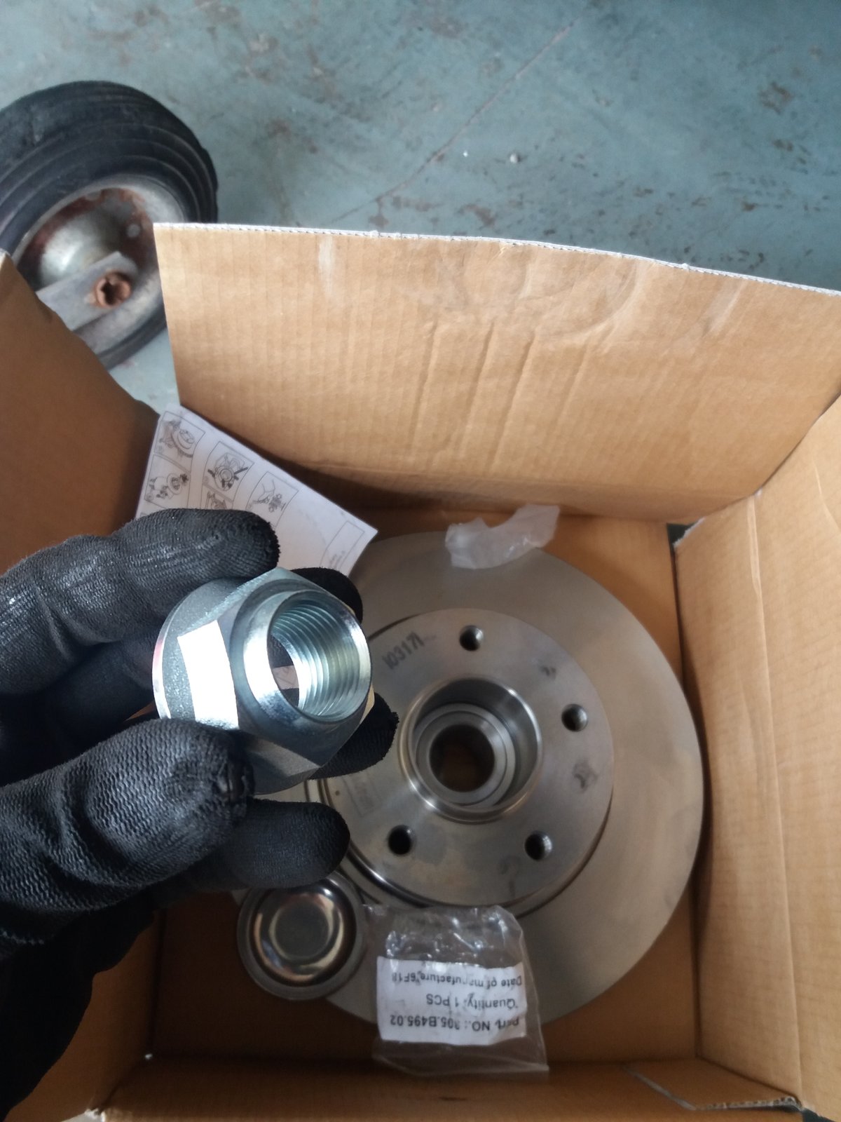

Morning all, does anyone know the torque for the rear hub nut for the above? It's a 2011 traffic. I'm doing the brakes and the rear has integral bearing in the disc. Its all new stuff being fitted. Research on the net varies from 175nm to 280nm so I'd like the definatinaive answer if anyone has a manual.
Thanks
