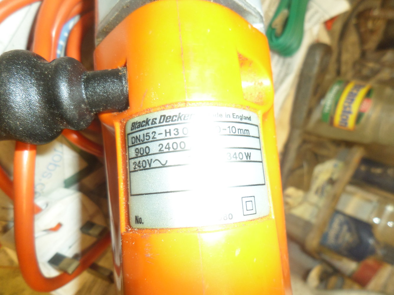

Now, the next question. I was watching a bloke on youtube, "restoring" the same drill, a B&D D720. His one had exactly the same trigger switch, except his one also had a large capacitor wired in as well. I think they were attached into the grey wires holes. It was very difficult to tell as the plank kept getting his hands in the way. So the question is, what is the purpose of the capacitor? Does it smooth out the trigger action?

Is your got the Double square to indicate it is double insulated?
Yes, then it is part of the interference suppression system and part of the double insulation set up.
Was fitted from build when B&D went double insulation.I should think the capacitor was just for suppression to stop it interfering with TVs and radios, probably added on later models
