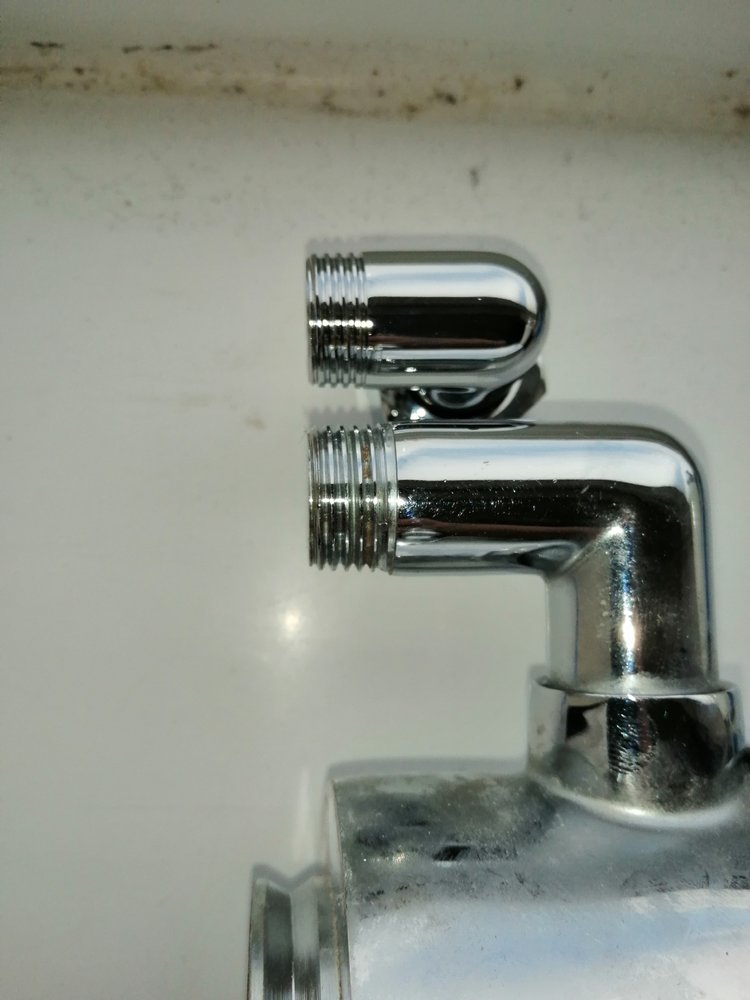

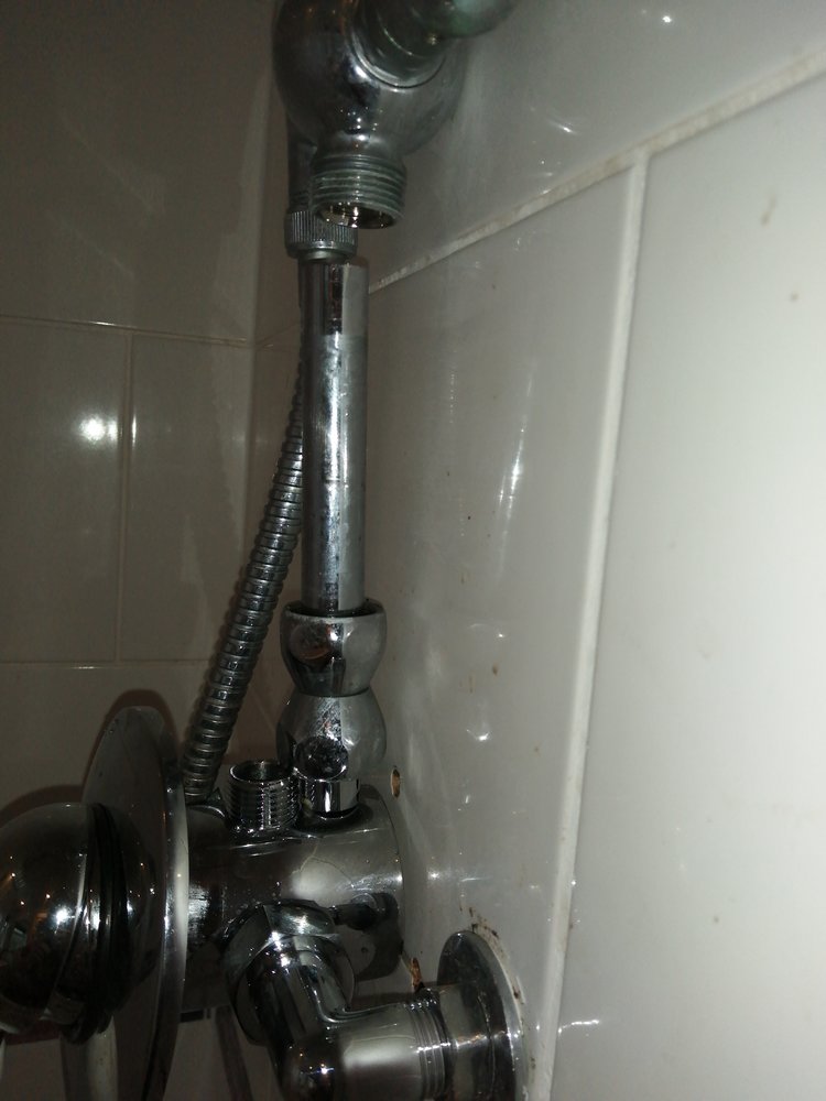

Look on the underside , there is normaly a small grub screw which locates the body on to a groove In the back plateStruggling with this.

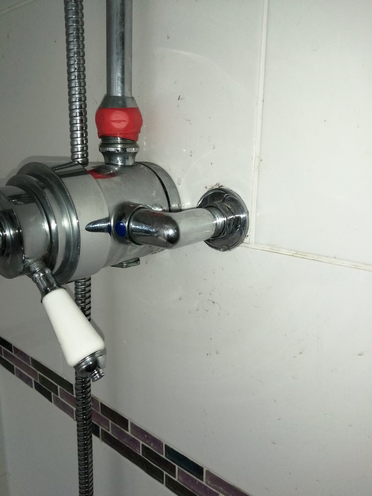

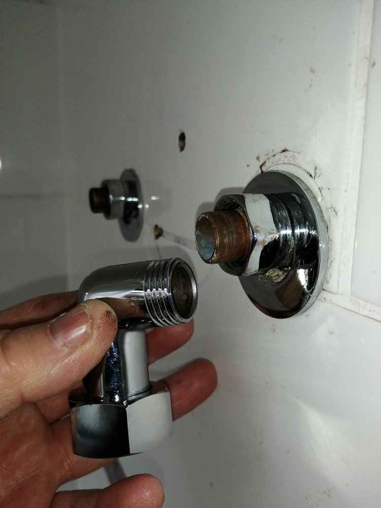

Got as far as loosening the two water inlet pipe nuts,the out is already off, they seem to be off the threads, whole thing waggles slightly.
Is it just a case of keep waggling or is it jammed against the olives and needs pipes cutting the other side of the wall?
Cheers.
no that apears like the lock and seal connection not a compression seal otherwise olive would be left high and low
What are you trying to achieve ? Is it just to remove the diverter ?

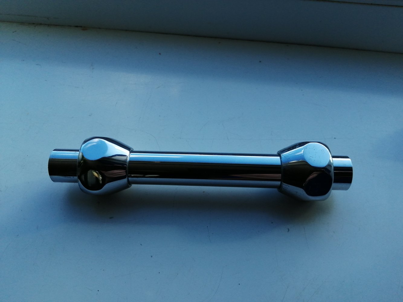

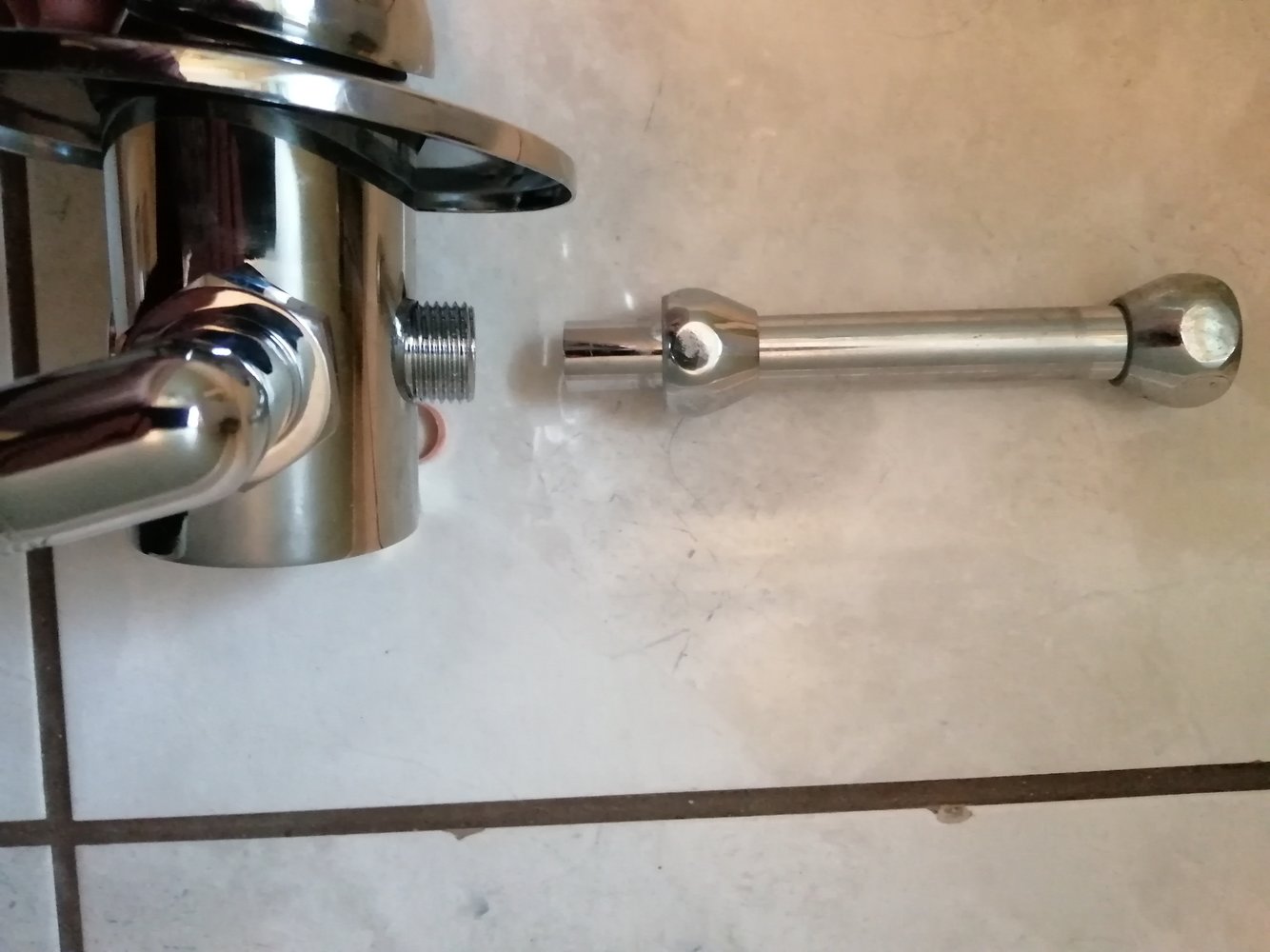

sorry not possibleThe length of riser pipe on the original mixer is 18mm od, with the nuts each end to match.

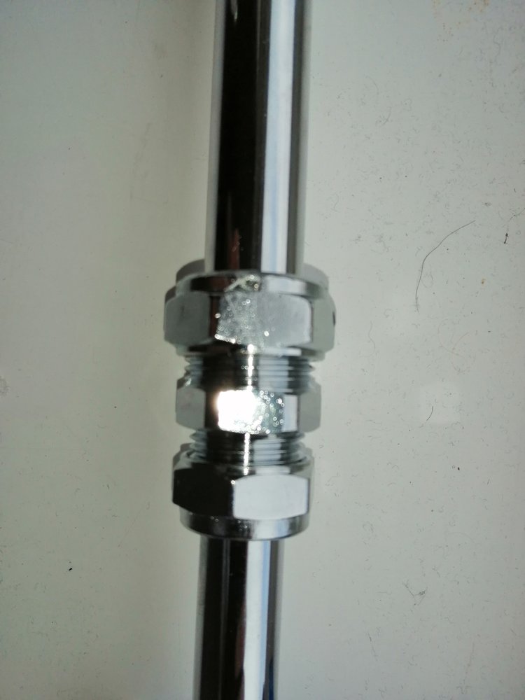

The new mixer takes a 15mm pipe and I need to join the two.
All I could think of is get a chrome 18mm to 15mm coupling and a small length of 15mm chrome pipe to join the 18mm and 15mm together.
Just seen the price of chrome pipe as well..![]()

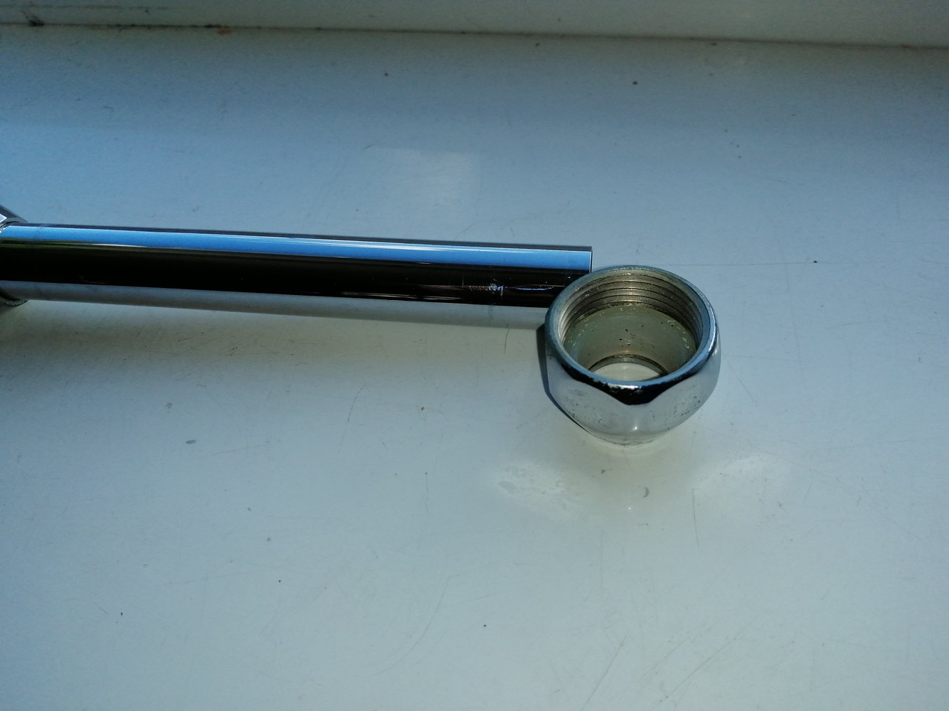

orIt is usually possible to slide the old olives off the pipe providing someone hasn't over tightened them in the first place and crushed the pipe. Carefully put a pair of pipe grips behind the nut and onto the end of the pipe and give them a gentle squeeze.
