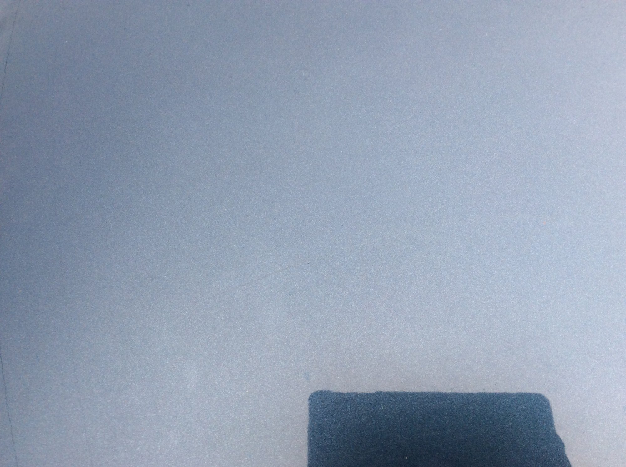

a lot of the time its plastic damage, in that the car drives down the side of you its plastic bumper in contact with your paint and friction melts it onto your car ive polished a few like thatMy Zafira got scraped by some poxy smart car in Tesco's car park all the way down one side (he she drove off) ****!
Anyway my old neighbor owns a body shop and came round to give me a quote for the work and said "that'll polish out" I didn't believe him but took it down anyway. He got his polishing gear out and 15 minutes later I couldn't see the damage!
Amazing .
He used some thinners to wipe it down then some polishing paste with a mop on a proper machine like a slow 9" grinder.
If you try this don't go too mad and don't get it hot!

What have you tried? I've just clicked on the "upload file",works for me
Sorry, I meant that I couldn't get the scratches to show up in the pictures not that I couldn't post pictures. Apologies
