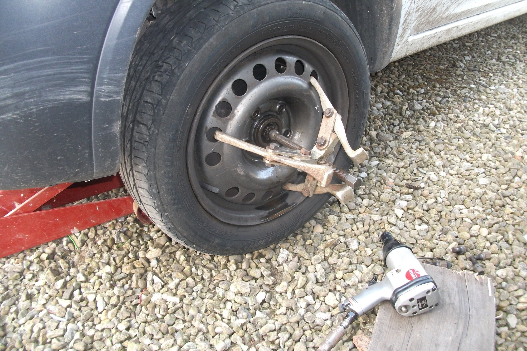

went to remove the wheels to check pads and disks . jacked it up removed studs squirted the centres with duck oil went to tap it off . no chance was rusted on to the hub
got a 4x4 post and put it behind the wheel sat on a brick to hold it up on the back of rim . a few good belts with a 10 lb hammer and no chance . ended up using a decent 3 legged puller on the centre and the legs through the holes round the wheel . wound it up and hit with a hammer no chance wound up again then hit from behind with wood and hammer and such a crack
went round the other side and the wheel was a meter away from van

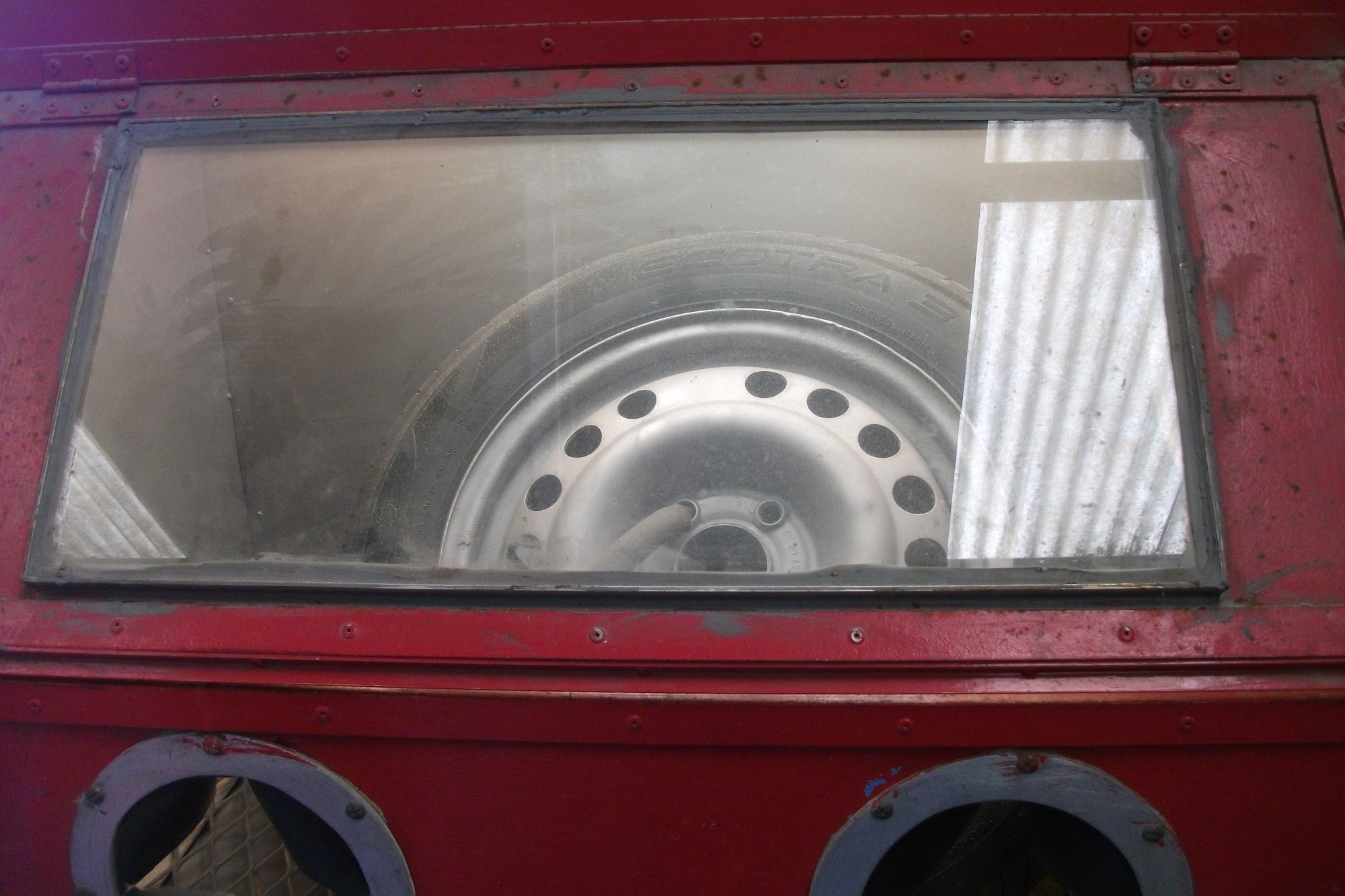

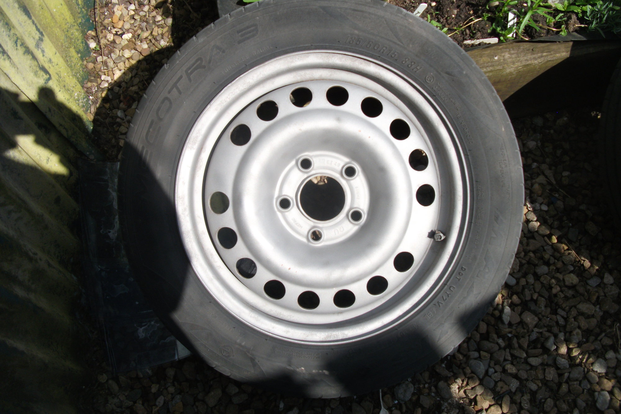

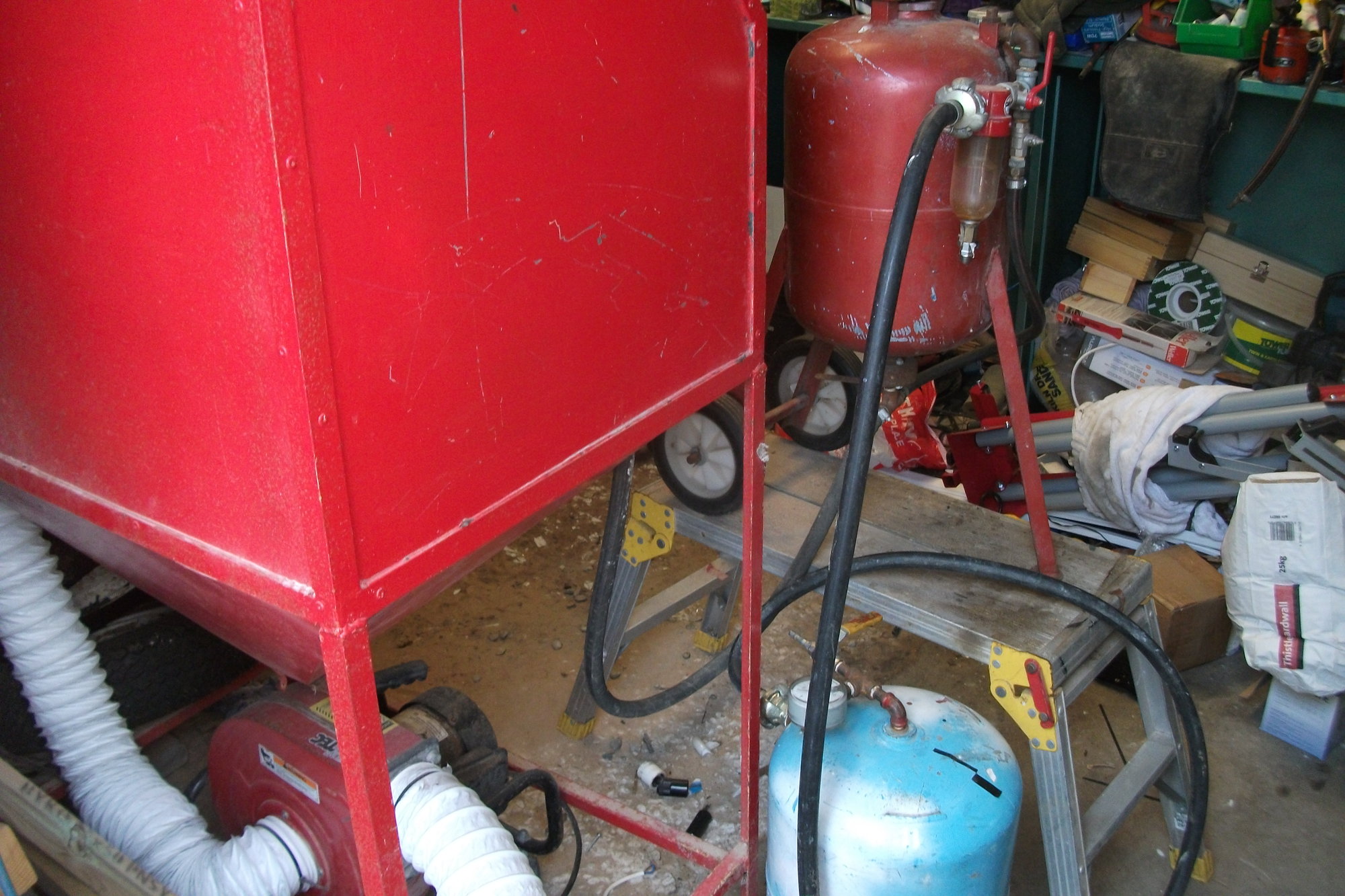

had to do same with other side .a good clean up of wheel and hub with emery cloth and some copperslip that wont happen again just have the disks and pads to do now .easy enough . famous last words. the wheels are as rusty as hell probs take them off and sandblast them in cabinet cant be bothered to do them setting up the larger gear outside
