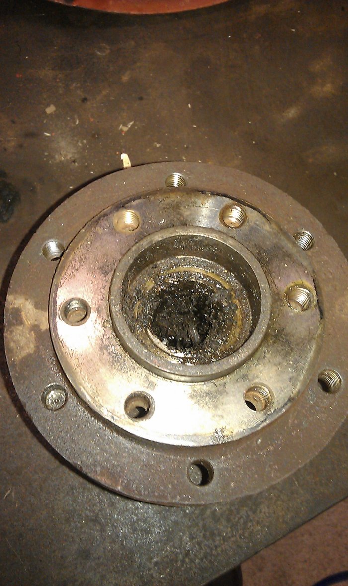

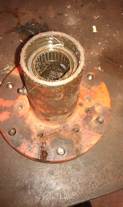

Nice easy job for a change, remove a broken bolt, rescue the thread if possible, if not drill out and helicoil. Well as you can guess it hasn't gone to plan. The casting is from a tedder and one of the M12 tine arms bolts has snapped off. I have taken the casting off and mounted in the drill press and started to drill out from the rear as it was easier to mount the casting in the drill - all was going great until about half way in the drill stopped cutting. I appears that their must be a broken drill or something else as hard stuck up that hole as nothing I have will touch it. I don't want to use heat if I can get away with it as it will screw up the bearings. I have thought about using the plasma cutter directly on the stud to blow a hole through it (about 7mm left) and with a bit of luck the heat will go some way to soften the metal, What do you think, am I living in cloud cockoo land.
