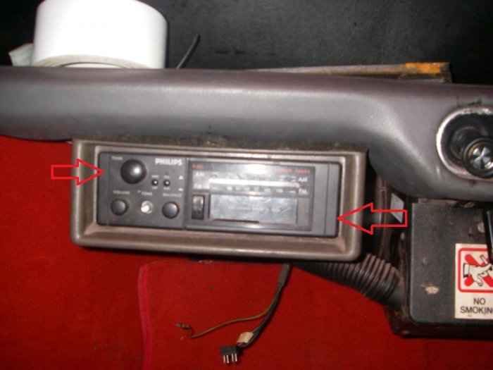

God knows how I am going to wire it all up :/
Carefully!
Should be easy to work out. You'll need a permanent live to keep the presets stored, a switched live that works on the 'accessory' position of the ignition switch, i.e. first click, no ignition lights, and an earth, other than that it's just wiring the speakers in.![]()
