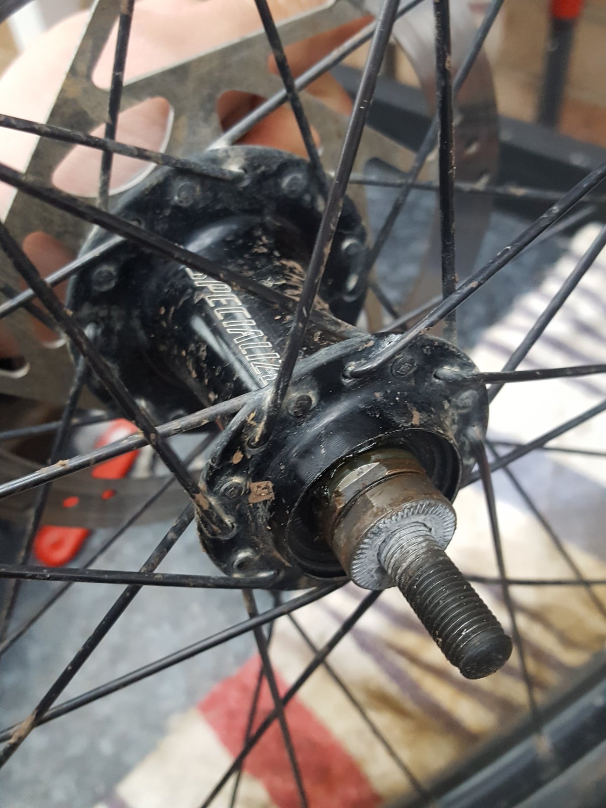

Here
and now add to that my son accidently pulled the lever and has mucked up the hydro brakes as well
 It happens a lot you have to wedge something behind the lever to stop busy fingers. Grab the cone end with some grips and wind the flip lever at the other end.I always try to stick a plastic spacer in between the pads where the disk was.Accidentally or was not told in timeIt happens a lot you have to wedge something behind the lever to stop busy fingers.
Likewise. Had some metal spacers same thickness as my disk for my trials bike. Easier to bleed with the calipers off.I always try to stick a plastic spacer in between the pads where the disk was.

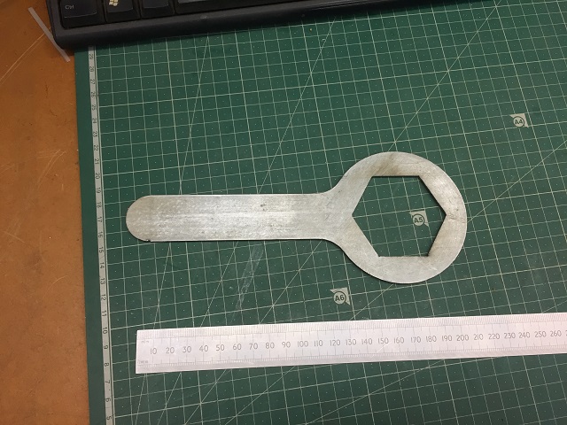

I made my cone spanners with an angle grinder;-)
I ground the jaws of an open ended spanner.
