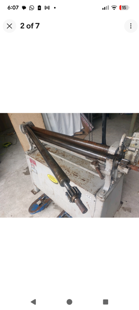

Thrashsmith Member Messages 761 Today at 6:43 AM #1 Hello all, on my sheet metal pinch rollers the bottom pinch roller is removable, similar to this Edwards one I've pulled off Google. Why? It doesn't help for getting a cylinder off the rolls. Or am I being thick? Thanks
B Beanwood Forum Supporter Messages 1,776 Location North of Bristol, England Today at 7:43 AM #2 Perhaps so a shaped roller can replace it, for reducing wire diameter or something?
B bricol Member Messages 7,066 Today at 9:37 AM #3 Removeable as a happy coincidence of being able to skew it for rolling tapered cones?

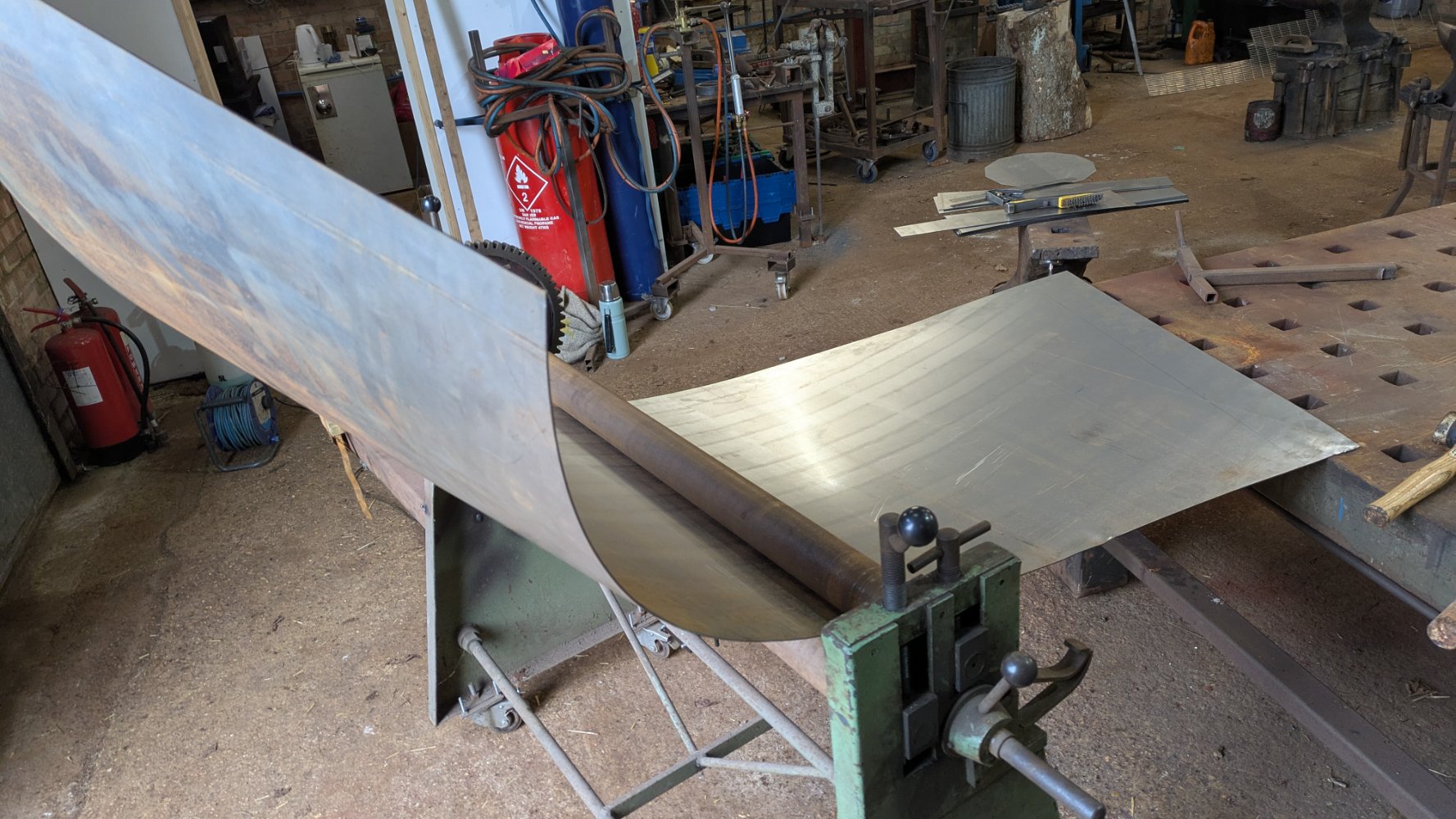

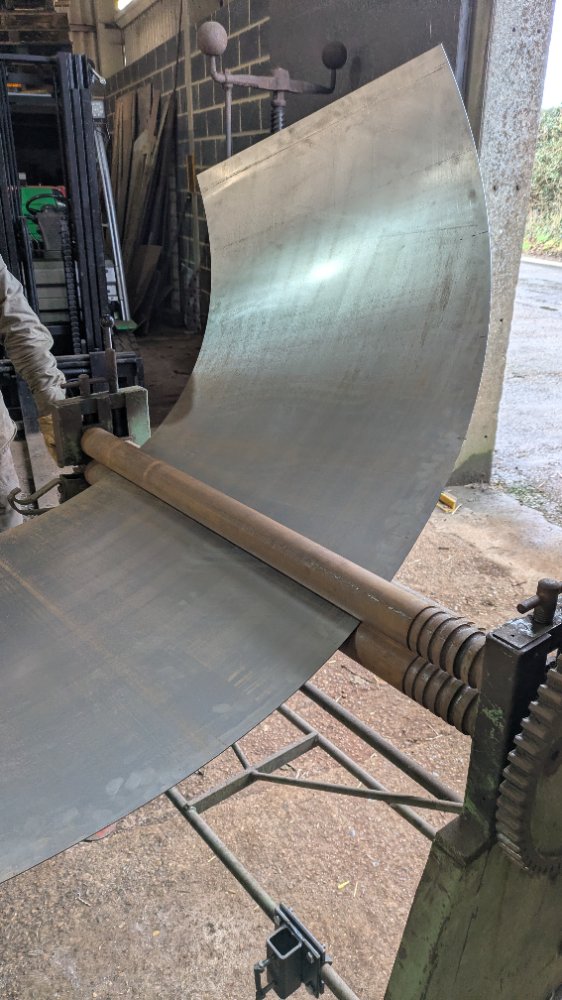

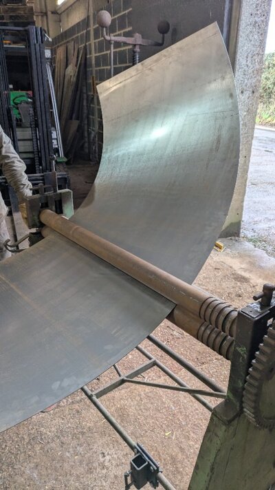

T tigdlo Member Messages 1,215 Location UK Today at 3:29 PM #4 Llift the rear roller, not visible in the photo, and the workpiece will roll around the romovable roller in the empty space in the front of the frame.
