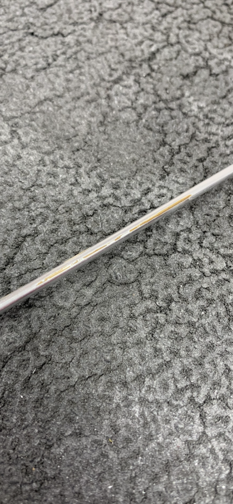

Rising.Frequency Member Messages 134 Location UK May 10, 2021 #1 Quick reminder for people, especially people just starting out. Inspect and clean your filler rod! Had this garbage today all over a full box of rod. Doesn’t come off with acetone. Has to be scratched off. Sif 4043
Rising.Frequency Member Messages 134 Location UK May 10, 2021 #4 TechnicAl said: What is it? Glue? Click to expand... I really don’t know what it is
Munkul Jack of some trades, Master of none Messages 7,819 Location Cumbria May 10, 2021 #5 I'd be rejecting the pack... No way would I be bothered to clean filler rod. You shouldn't have to.
Rising.Frequency Member Messages 134 Location UK May 10, 2021 #6 Thats exactly what I’ve done. Not going through a full pack cleaning that off. I always acetone my filler rod but acetone doesn’t touch that stuff

Rising.Frequency Member Messages 134 Location UK May 10, 2021 #8 You’ll be surprised what comes off it. Even the highest quality filler
