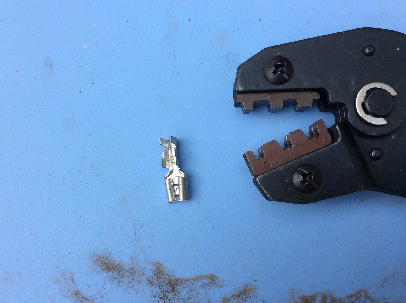

I’m fitting Lucar female spades and it’s been a while,plus lost the instructions. PS,perhaps this is more appropriate in codgers corner,lol.
Bigger crimp side for plastic sleeve, flat part of terminal goes against flat part of crimp, put cable in before squeezing! Had to check it's not 1st April!
Seriously though. It looks like the bottom half of the spade terminal has been in the crimper, when should have been left untouched. To get the correct orientation, lay a fresh, uncrimped terminal in the same orientation as the one on the picture, and the jaws of the crimper as they are. Pivot the top of the terminal towards the viewer, place the stripped cable into the terminal so that the insulation lies within the topmost metal "wings" and then place the crimper jaws around the terminal, with the top "wings" fitting into the slightly wider part of the die, and crimp. The crimped terminal should look something like this:
